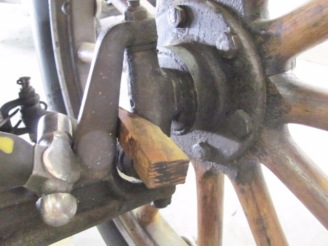

Another easy method to determine front wheel wiggle is due to the spindle bolt (king pin is loose in the bushings)is the issue, test with a wedge of wood driven in to lock the spindle body.
Now with the tire jacked up, wiggle the tire and wheel, if you feel movement, then the hub bearings are loose, and you can tighten them up. If no wiggle there, then you have determined the spindle bolt is the issue of wiggle in the front wheel.
