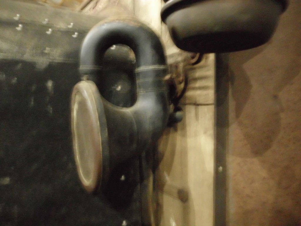

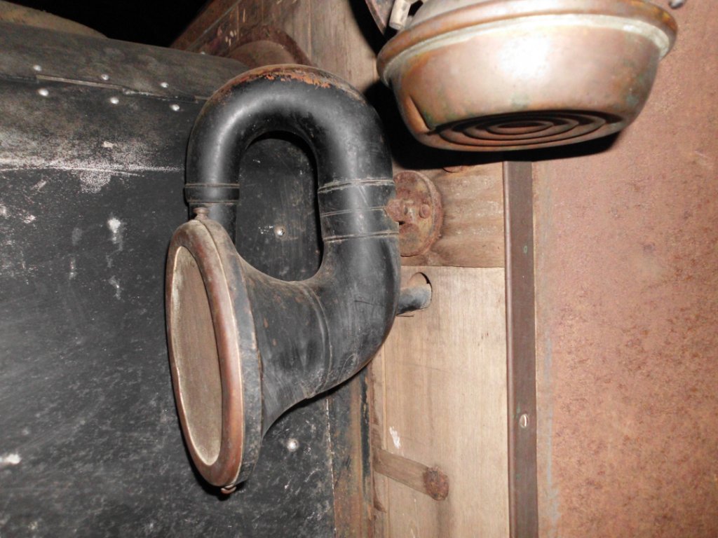

Post by Bob McDaniel » Sat Feb 25, 2023 11:36 pm
My 13 horn

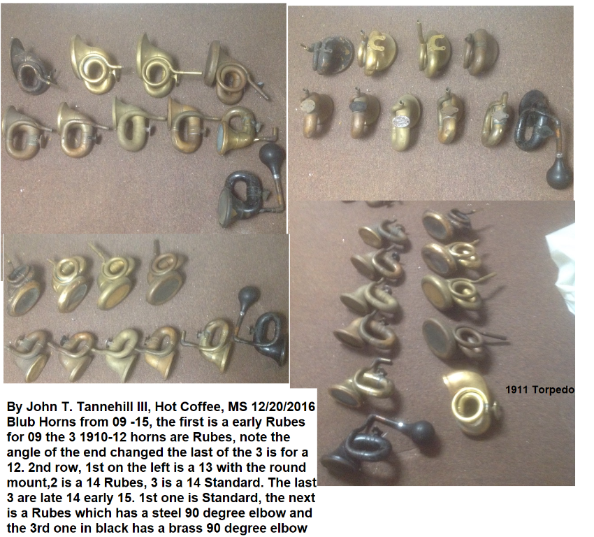

Re: 13 - 15 bulb horn
Post by TRDxB2 » Sun Feb 26, 2023 12:37 pm
Rich's referenced link is golden (brass) just some pics from it
