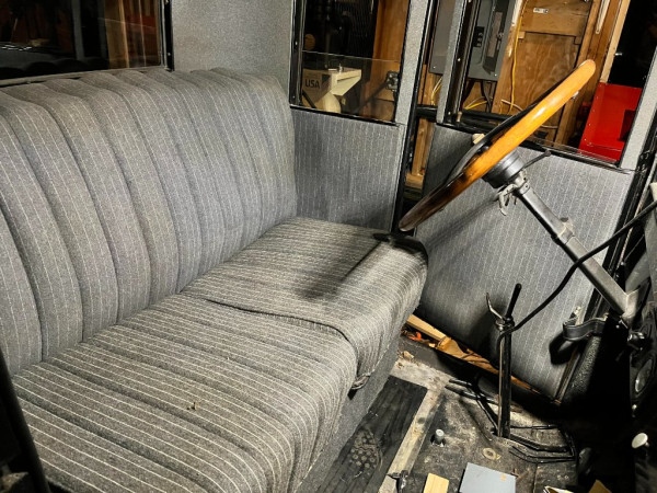

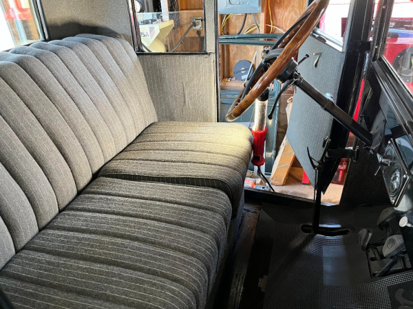

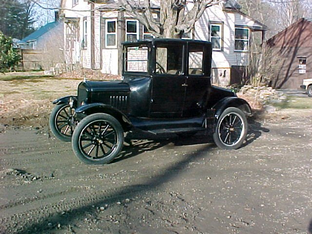

So hear is what I started with. As you can see the package shelf takes up a lot of room and for a tall guy like me it's worth the effort to go after that valuable Real Estate. This will involve removing the package shelf, removing the gas tank, removing the seat riser and then reconstruction.

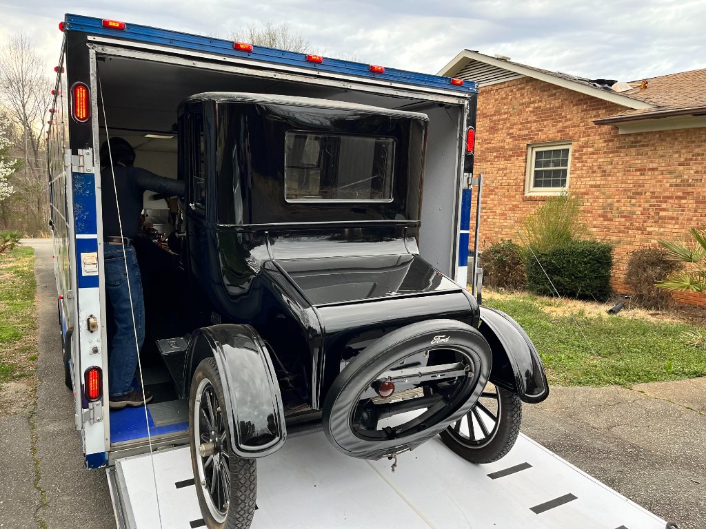

Bill lives with in an hour of me and has hauled a few things for me, he goes out of his way to help, I have turned a few close friends on to him also!

Bill was outstanding and if I ever need something transported I will be giving him a call !!! Bill told me he has driven over 4 million miles accident free and to me that speaks volumes.

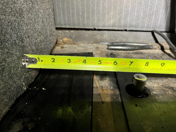

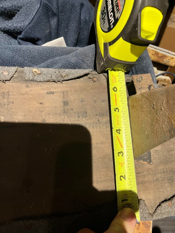

Well I had a chance to get the seats out along with the package shelf. After measuring the edge of the package shelf to the bracket that screwed into the wood framing it looks like I will be able to gain 5 1/2 inches of legroom.....to me that is amazing and a total game changer in the area of driver comfort.

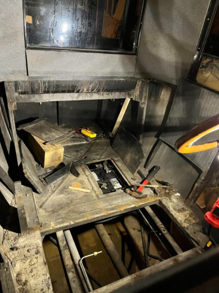

Got the gas tank out late last night and I am working on removing the seat riser tonight. Cannot wait to drive a T is utter comfort for the first time

After some effort the interior slowly began to come out.

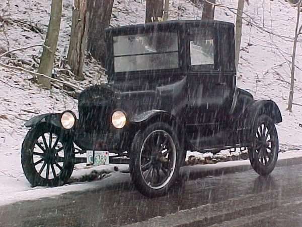

In your first picture, you do not look unusually tall. Must have a short torso and long legs. My dad was like that. He was 6' tall. I was only 5' 7" tall, but when we sat side by side on a bench, I was taller than him! Be sure you put your leg down all the way to the sloped floorboard and see if you can do it without completely straightening your knee. On a Model T, you need to be able to push the pedals all the way down and hold them tight to keep the bands from slipping. And you need to be able to bend the knee quickly to let the pedal into high. So don't lock the knee

That's funny but I can see how you thought that.....the man in the photo is Bill from Bill's auto Works. He was the man who transported my 24 Coupe from Norwalk, OH to Troutman, NC. When I stand next to the 24 Coup the T and myself are about the same height. To give an idea of my size hear I am in my 1915 Touring. I have long legs so gettin into my 15 is interesting but I can drive her. The 24 will soon have as much legroom as my 2005 Mercedes E320 CDINorman Kling wrote: ↑Thu Mar 02, 2023 9:30 pmIn your first picture, you do not look unusually tall. Must have a short torso and long legs. My dad was like that. He was 6' tall. I was only 5' 7" tall, but when we sat side by side on a bench, I was taller than him! Be sure you put your leg down all the way to the sloped floorboard and see if you can do it without completely straightening your knee. On a Model T, you need to be able to push the pedals all the way down and hold them tight to keep the bands from slipping. And you need to be able to bend the knee quickly to let the pedal into high. So don't lock the knee

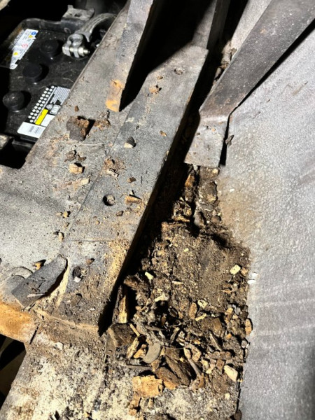

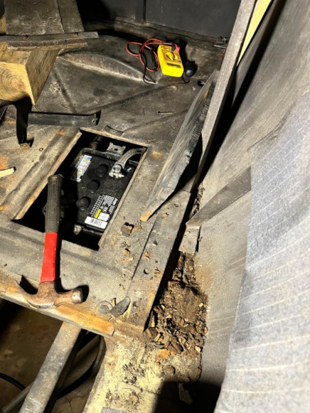

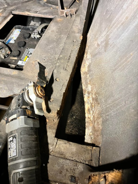

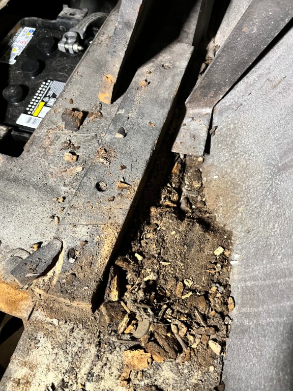

Well I got the seat riser out but I came across some hidden rot below the back window on the drivers side so this will slow me down until I can get all the rot out and make a wooden replacement part. any recommendations are appreciated.

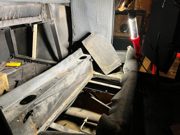

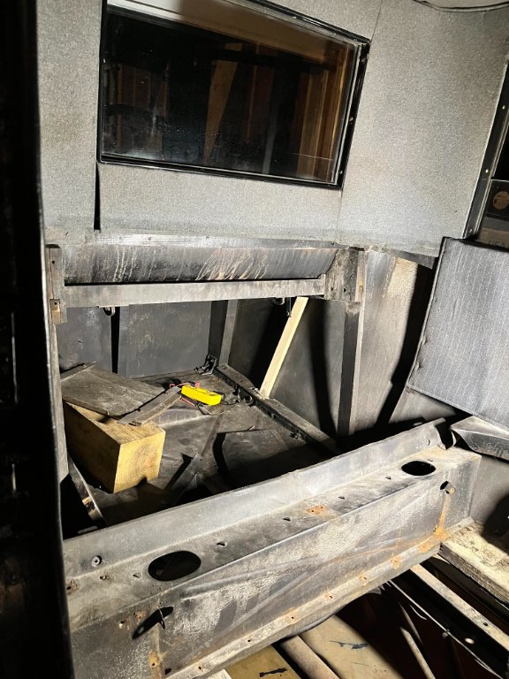

Hear is the 24 Coupe with the gas tank removed along with everything that needs to come out.
- Posts: 4692
Re: 1924 Coupe Gives Back Hidden Legroom
The photos show what happens over many years of rain and moisture getting into the low areas of closed car bodies. To replace the wood in that area probably means the main wood frame rail also. To be able to get to the lower section of the body wood itself you would need to remove the body sheet metal and that’s a major undertaking. The other side is probably in the same condition.
I would clean out the dirt and rotten wood and fill it in somehow to be able to keep it level with the remaining lower body wood.
After nearly 100 years original wood begins to deteriorate and it might be best to leave alone if the body is still pretty stable. Otherwise it’s a wood structure rebuild thats a major undertaking. Time and money would be something to think about.

The right side is solid as can be but the wood on the right side just crumbled in a small area next to the window. I plan in buzzing the bad out tonight and making a patch. Its so isolated that I see no need to do any major reconstruction at this point. Overall I am impressed with the condition of the original wood......should be good for another 50 years or more at this point........with cars this old things like this are to be expected and it could have been much worse.
- Posts: 4692
The 24 Coupe I have had the bad wood almost in the same place. I cleaned it up the best I could and put a patch piece in it and called it good. There are purists that would have rewooded the whole body when finding bad or questionable wood. But not me. Luckily it had only one other place in the trunk and I replaced the bad wood with new as it easy to get to.
My 24 T belonged to my Grandfather and for the most part was not kept in the open. Yours must have been inside during its life too. Model T’s stored or left out behind the house or garage don’t last long exposed to the weather! I’ve seen a few that were and sadly rotted away!
Hey John
I would not remove the 97% good wood because of a bad 3% lol
Did you screw the patch piece in or nail it?
- Posts: 4692
As I remember since it’s been over 10 years ago seems like I leveled out the wood as best as I could and laid a piece of wood in it. Screwing the wood down worked best since nailing might split the wood. When you screw the patch down and if the hole would be over the main frame rail it would be best to help secure as good as you can since your screw would maybe go into the wood frame rail. Drill a small hole first and the install the screw or fastener. Others might have other ideas how to do it.
Since it’s been opened up the way that it is. Now would be a good time to use air to blow out the years of dirt and debris that’s gotten in the open places between the body sheet metal and wood.

you think you should add glue and clamp it too?
- Posts: 4692
Wouldn’t hurt to pour some good grade wood glue and spread it. Maybe clamp it if you can. I used wood glue in the trunk support piece that I made and you can’t tell the difference. I then added the new replacement trunk floor that I needed.

With the help of my good old Buzz Tool I was able to cut the rotted wood out of the floor on my 24 coupe. I cut back to solid wood and boy do you need to be a contortionists ......I sat on the driver side running board with my right hand holding a board under the bad body wood so the tool would cut through the rot and scratch the splash aprion. Then my head twisted around the door opening to see my work and I buzzed the rot out with my left hand (I am right handed). Long story short I think it cleaned up good and I plan on making a patch out of a 2x6 in the morning. My plan it to drill through the original wood and attach the wood patch with screws and glue.

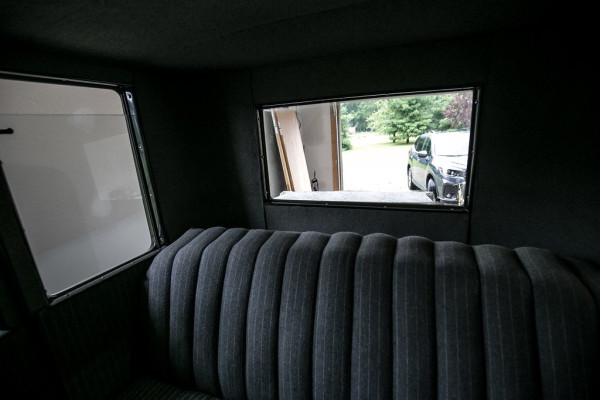

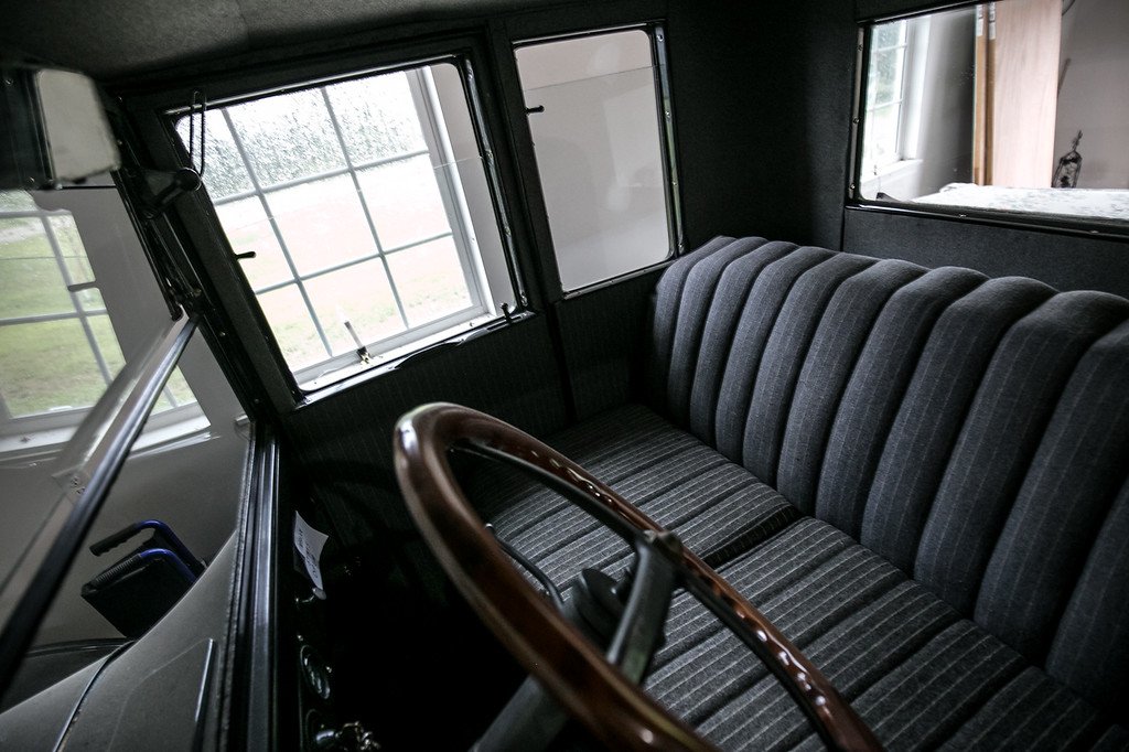

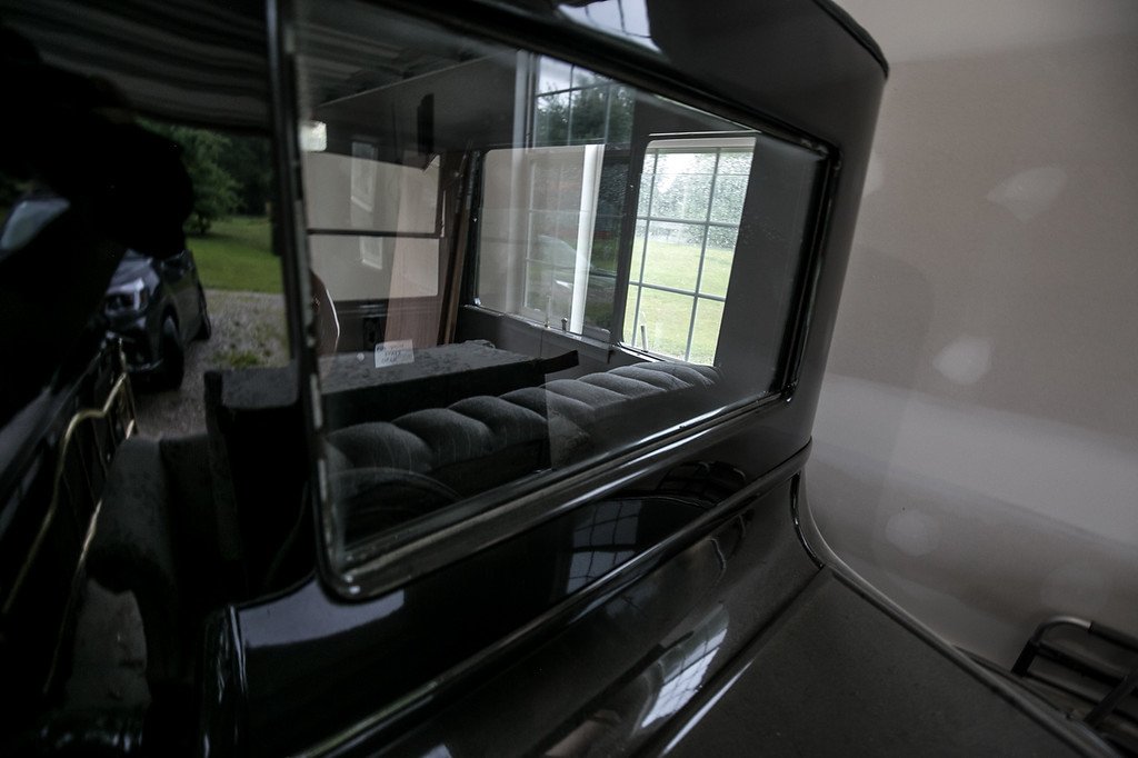

Well I just did a mockup to see if my measurements were right and I got my 5 inches
I think it looks just as if Henry made her that way for tall people
. Lots more work to get it all together but the juice was worth the squeeze and look at all that room behind the starter button

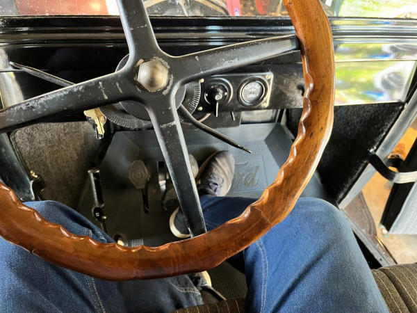

Due to my long legs I do not think the starter switch location is going to be a problem but if it is i see no reason why that could not be moved back as well.

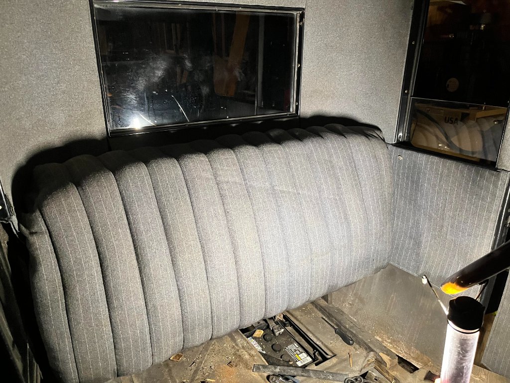

Do you guys think it looks better with the backrest raised to the rear window height? I think it does.
I guess the real question is- does your back say it feels right?
Ron really good customization. Best John

It sure looks better to me! And the added leg room. Ahhh. I'm tall also. Makes me rethink my love for cramped Runabouts.
John asks it correctly: How's your back like it?
That's not crazy Suzanne. Not at all.
And you could use the driver's door!

I knew the pre 24 Coupe's had a bit more legroom and was able to test fit a 1921a few years back to confirm. To be honest I think I found more room in the 24 with a little re-engineering. This modification makes the 24 or 25 Coupe amazingly roomy and trust me it's worth the effort if your tall. At 6'3'' and having long legs I have more room than I need and can actually stretch out.
The seatback feels much better being raised to the back window level so that's it's new home as far as I am concerned..... It also looks better proportioned in my opinion. I hope this trend someday helps someone else find the legroom in a 24 or 25 Coupe that they are looking for. Its not hard to do just take your time and if you find hidden rot fix it.....
Ron

I have a 1924 model year coupe. As has often been stated, people were smaller (in stature and girth) during the first part of the previous century and earlier.
I am 5'4", which makes me Model T sized, fun size. The car fits me quite well and I can use the driver's door comfortably.
I really appreciate the package shelf and use it all of the time. As Susanne commented,with a turtle deck to carry things, a package shelf may seem superfluous. I use the shelf to hold my sun glasses case, a small leather case for car registration, insurance card, and other papers, sometimes a water bottle may be there, my cell phone, my jacket if it has become too warm, maps, a small first aid kit, and small purchases made when out and about, or even an umbrella.
I Love my coupe.
I Love my coupe.

Mr. Harper at 5'4'' you are in luck that any T will fit you just fine. On my 15 Touring I had to remove the backrest springs and use foam and after all that I just about fit. Now on my 24 I finished everything up today including mounting the gas tank a few inches back and screwing the seat components back in position. At 6'3'' I have never experienced the joy of legroom that Mr. Harper has but with a little re-engineering I too can enjoy my 1924 Coupe. After everything was assembled I picked up all my tools and added a new rubber mat. Very satisfied with how it turned out.

That view from the seat looks real fair Ron. Thank you!
Ooh, foam for a Touring seat back. Tim the ol' aviator did something there also but I forget.
Mack, I'm one of the hoodlums to zee the hand brake lever some years back and it is quite an improvement.
A few fellows had issues with/fears about breaking the lever but mine went smooth.
