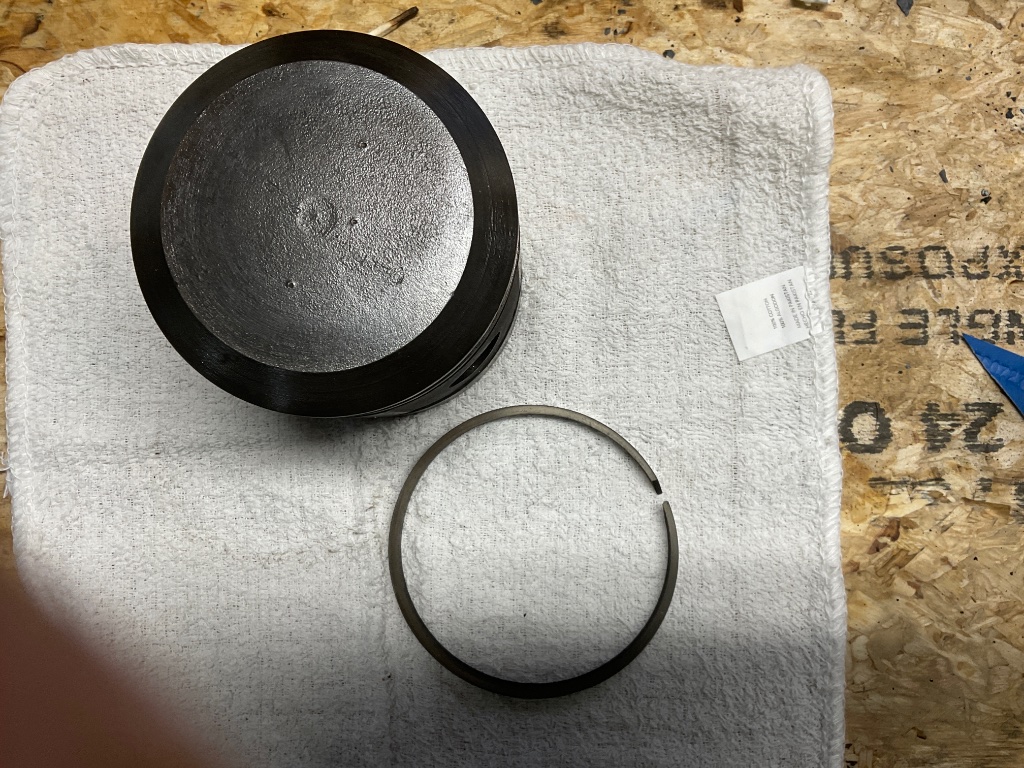

Good Afternoon Forum Chums,
Gonna ask a couple of what I hope won’t be perceived as dumb questions? In between flying my trips I’ve been doing what I term as an engine refresh on my 27 Tudor.
Won’t bore you with all the numbers, but The Pistons and bores mic-ed up extremely well, nothing is out of round…….piston to bore wall is clearance is 3 thousandths….which I thought was astounding considering the age…..Pistons all stamped “Ford Standard”…..ditto rings on top “Ford”….I suspect could be original!
Background complete….now the questions.
First question……all the rings are worn, what I think considerably, on the ring gap side…(see picture)….never saw that before….done many rebuilds….but this is my first T…… he has anyone seen this before?……. any idea as to why?…..ordered new!
Second….the pistons all have punch marks on the top…..either 2 or 3…not 1-4 to mark position….any idea of what someone may have been trying to document?…..I’m stumped
Many Thanks
Cheers,
Ed
Many Thanks
Cheers,
Ed

If the pistons are original, which seems likley, the numbers stamped on them may refer to their weight. I think it would be considered normal to see wear on the portions of a stock T ring nearest the gap, since they tend to spring open at the gap, and also because normal blowby at the gap may cause increased heating and diminished lubrication at that point.
- Posts: 4628
Re: Rings and Pistons
The piston punch marks could be from an older rebuild and someone used some good used pistons. Are the cylinders ID still std pretty much the same for all 4 but larger then the std. 3.75 ?
Depending on how worn off the tops are you might still find STD on the top of original pistons by carefully cleaning the piston top. Or you might find the oversize dia. also if they were changed. All mechanics don’t use the same procedures when putting punch marks on engine parts so be prepared when you disassemble engines that are close to 100 years old.
They all say Standard clearly on top
- Posts: 8433
I misread about the numbers. The punch marks might refer to weight, position, or who knows what. When I was a kid, the junk pile had T parts in it, with a scattering of rings and pieces of rings. It was common to see wear like the ring in the picture shows. If the pistons and bores are OK, check for wear in the ring grooves of the pistons. Excess wear in the ring grooves, or "stepped" grooves, can ruin an otherwise good ring job.
Brilliant Sir…..not handy to the specs right now…on the road… do you have any idea how many thousands is allowable on side clearance for the rings and the grooves?
- Posts: 5141
Are you assuming the ring gap is to wide by what you see from the loose ring sitting on the bench?
Thats not how gap is determined. With the loose ring squarely in the cylinder, you use a feeler gauge for a reading.
.003 piston clearance in an old motor is too good to be true. That would indicate the motor has near no miles on it.
Standard iron pistons! Unbelievable. Was the motor sleeved back up to standard.
- Posts: 4628
To each his own but since the pistons are std. and the bores aren’t really worn I would buy a set of std rings and put them it. But that’s me. Others might want to install a set of std. aluminum pistons. You will get all kinds of advice about this! The original pistons probably arent not worn that much. You probably have a low mileage engine. And that’s a plus.++++++++++++++!
I would install a new set of rings. Check the valves and and bearing clearances. It will run just fine for years of driven senseably
The punch marks on the pistons were to keep track of what cylinders they came out of, so that they could go back into the same bores.
Do a light hone on the bores prior to installing new rings or the rings most likely will not seat.

- Posts: 6710
and to Jerry's advice...use the type of hone and the GRIT that the ring mfg. recommends...a more important thing than people sometimes realize.
generally speaking, FLEX_HONE by Brush Research is my go-to product

Ring groove clearance should be .001 to 002. If the lower ring groove has oil drain holes in it, they should all be clear, but not drilled oversize. See Ford service book for specs and procedures.
Thanks Jerry….but the punch marks are not to note position……not numbered 1234….but 2332…. it’s what I initially had thought until I saw that I didn’t have sequential numbers…..good info about honing….I was planing on doing that!
- Posts: 4694
One more thing to check would be to put the ring in the cylinder squarely near the bottom and measure the gap. Then move toward the top and gap should be near the same. This will measure taper of the cylinder.

All good information here so far. I am surprised that no-one has mentioned this so far though. Since you have the engine open and are working with the pistons, also check the valves to see if it still has the original two piece valves. If it does, replace them at this time. You can get standard sized T valves from the vendors. The two piece valves sometimes come apart and become actually two pieces again. Bad things happen when that occurs.
