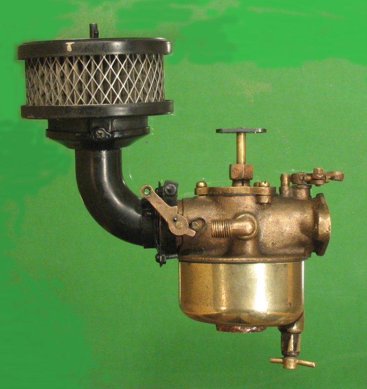

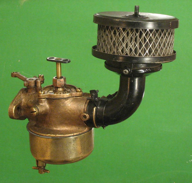

Gasoline ruined the paint on my carburetor bowl, so I switched to a brass bowl.

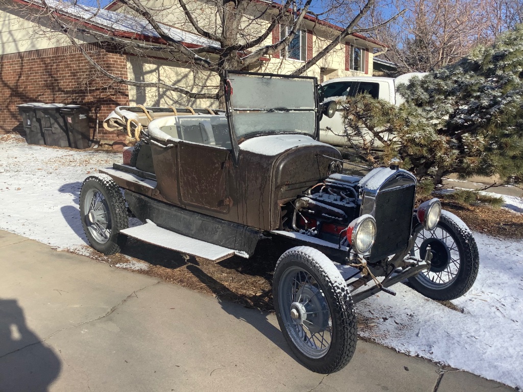

Lots of T owners are dusting off their cars, getting ready for spring. My car just got dusted!
Around here, spring means snow at night, roadster weather in the daytime… Gotta go dry it off before the melt sits in the plug wells! -Chris, in Boulder.

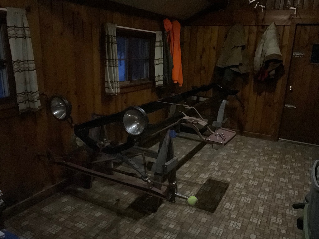

To make room in the shop for the new arrivals next week, I moved the TT into the bunkroom…….last thing I see now before I fall asleep.

Pretty cool but don't those headlamps staring at you all night keep you awake? :lol: :lol:

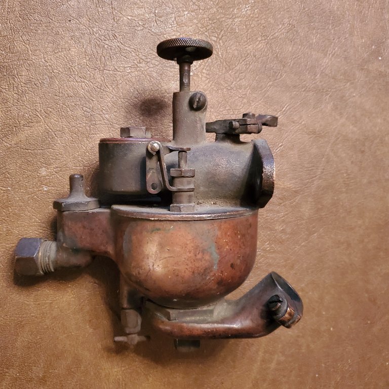

Post by RGould1910 » Mon Mar 13, 2023 5:08 pm
Finished restoring a 1911 Holley 4500. Other than cosmetics, I straightened the throttle arm and made a new gas shut needle.
ent]

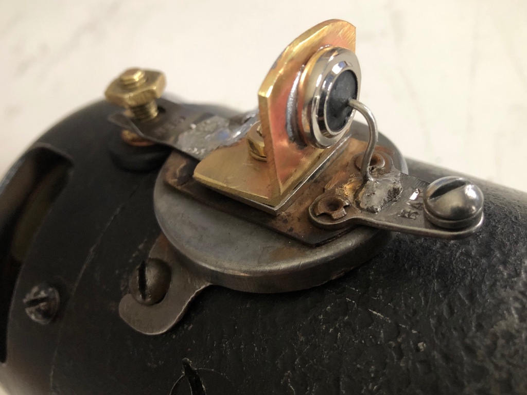

I wrestled with rebuilding and adjusting my generator and made a diode type “cutout retrofit with the diode sold by Langs. I’m still trying to get the charging rate down for somewhere around 2-4 amps when driving 35-40 mph. I loosened the brush plate, raised the third brush and set the “null” point using a DC power source on the bench. Then I locked down the brush plate and dropped the third brush back in contact and installed the generator into the car. I’ve adjusted the third brush to it’s furthest position anti clockwise and I still have an output of around 10-13 at 40 mph. Scratching my head.

Mine will show a 10 amp rate at moderate speeds, and it tapers off to about 6-7 amps at higher speeds over 40 MPH. It doesn't seem to have a linear response to adjusting the 3rd brush. I have an Optima red top 6 volt battery. I just turn the lights on to bring the charge rate down. It shows close to zero with the lights on. This car has higher CP headlight bulbs than stock. I go by the dash ammeter, which appears to work as it should, but I haven't attempted to verify its accuracy other than noting that it consistetnly shows zero when everything is off.

Do an in car 3rd brush adjustment.
That will get you a live adjustment for lower charge rates.

Ron Patterson has an "in-car" null point setting procedure that should help you. It's been posted here a few times, but I can't search for it right now.
Posts: 2546
Last Name: Strange
Location: Hillsboro, MO
Re: What have you done to your model T in March
Post by CudaMan » Tue Mar 14, 2023 10:54 am
I think this is the Ron Patterson in-car procedure (from an older thread):
"Try this, it works every time: If the generator is in good shape and charging excessively or not at all
with the third brush fully retarded it is caused by the brushplate "neutral"
not being set correctly. This is a common problem with newly
rebuilt/repaired generators.
Setting the brushplate "neutral" can be very
tricky. You can follow the standard procedure, but getting it in just the
correct spot for proper generator operation is sometimes very elusive.
I have used this procedure for years to correct the brush plate not being in
the correct "neutral" position on running Model T's. You will need a helper
to watch the ammeter.
Install a known good relay type cutout (not a VR) on the generator. Remove
the generator cover band. Adjust the third brush to the fully retarded
position (all the way CCW when viewed from the gear end of the generator).
Start the engine and run at a speed where the generator should be charging.
Loosen the four #6-32 screws on the brushplate end cap 1-1 1/2 (only) turns.
With your fingers reach inside the generator case and rotate the entire
brushplate to a point where the ammeter is reading 1-2 amps charge. Tighten
the four #6-32 screws.
Now reset the third brush to the desired charging
rate. Given the way Model T's are driven today this should normally be no
more than 5-6 amps. This is also very easy on the poor generator and it will
thank you for it.
If everything else is working correctly, this procedure will set the
brushplate "neutral" to the proper position."

I had to do the same exact procedure on my first generator rebuild- worked liked a charm. It's these 4 screws circled in red...

I had already done the null adjustment on the bench before installing the generator back in the car. The problem I am having is that at 40 mph the output of the generator according to the ammeter is in the 16 amp range. This generator has a diode that allows flow to the battery when running and no flow back to the battery when the engine is not running as it should. I just want to reduce the output. I’m guessing I must do this with the generator in the car and the engine running at a moderate speed … by loosening the brush plate and rotating the brush plate to bring the output down to around 4 amps. Right?

I THINK YOU OVERLOOKED A STEP:
" Adjust the third brush to the fully retarded
position. (all the way CCW when viewed from the gear end of the generator).
********Now reset the third brush to the desired charging
more than 5-6 amps.*******"

Some generators seem to be less than cooperative in finding the "sweet-spot" for the null point - follow the procedure Ron Patterson recommends as printed above - engine at quite a bit more than a very fast idle with the 3rd brush already rotated towards the fender/away from the engine, slightly loosen the 4 brush holder screws and rotate the whole brush plate until the ammeter registers +2 amps then adjust the 3rd brush. Ron showed me how to build an ammeter holder with 2 leads to hang onto the radiator support rod so you can do the task on your own or you need another body to watch the meter in the cockpit !

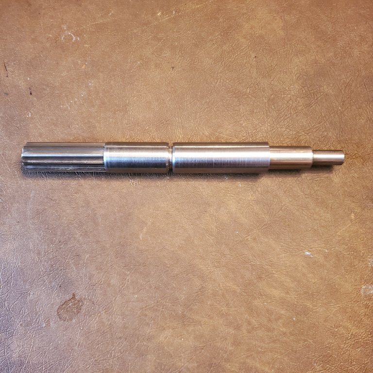

Adapted a 15/16 " reamer to ream the driving plate bushing by installing sleeves over the shank to fit inside the brake drum bushings. I used sleeve retainer to hold the sleeves and turned them to .998-.999", same as the K R Wilson reamer, centering off the reamer pilot holes.

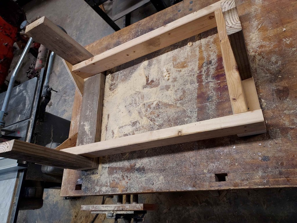

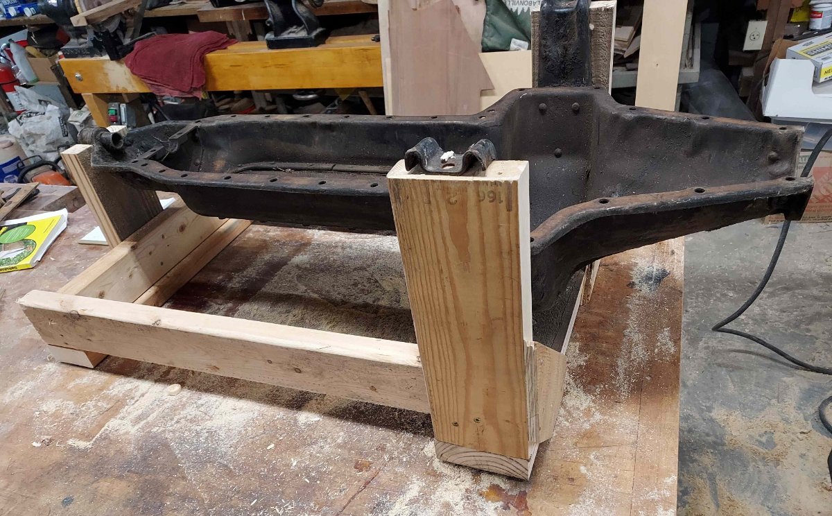

Melted the babbitt back out of the block and caps couple of weeks ago. Ran into some issues boring them out. Front was fine, center removed too much and rear the cutter moved and took a big gouge out. Been too cold in the shop to do anything, maybe get back to it next week. :( Babbitt is getting low, hope to have enough for the repour.
