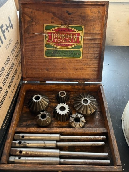

A friend in our local club recently acquired these valve seat cutters which were described as a set specifically for Model T engines.
I don't know enough to say, does this seem correct?

Because of all the pilots, it's made for almost any engine.

Yes, and on further reflection, the different diameter cutters also speak to a wide range of workpieces. Thanks!

I haven't got a photo of mine, but if you find a valve seat cutter whose blades match the size of a Model T valve; have a fixed pilot; and a T handle on top, I think you can assume you have a genuine Model T valve cutter. I think mine even has Ford script and a 3 Z or 5 Z part number.

The large over cutter would work on any side valve motor. The two different undercutters would cater for most engines, as would the two 45 degree cutters. The various pilots would suit a range of valve guides. It would not be in the tool manufacturer,s interest to make a specific set for a single motor due to limitations in the size of the market. Of course, the millions of model T's disrupts that thought.
