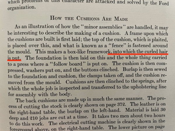

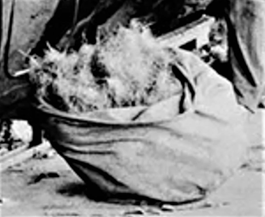

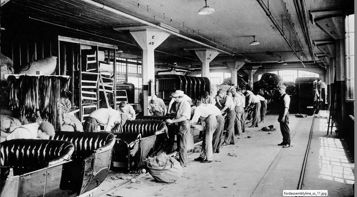

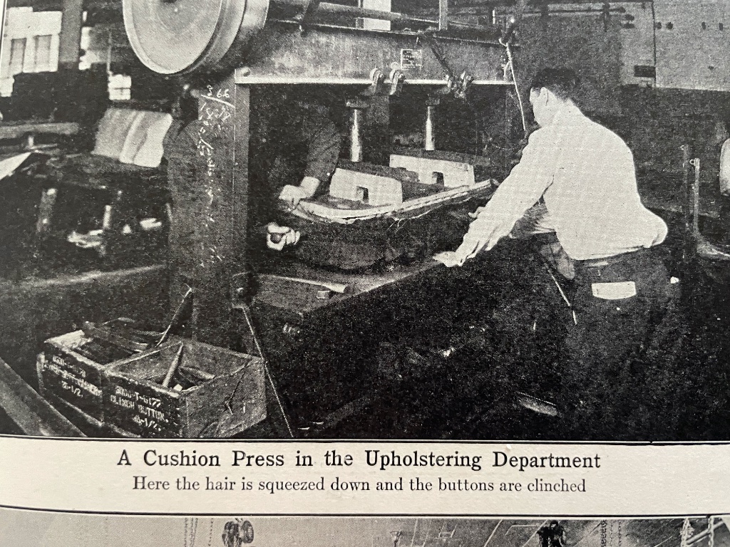

At least a qualified resource on what Ford used in seat cushions early on are the authors of 'Ford Methods and the Ford Shop'*, the pair were highly respected engineers, and would of course used the correct terminology in this work.
Animal hair was in extensive use at the time, and not withstanding the limited use of plant fiber processed 'hair', certainly Spanish Moss wasn't used by Ford. Later productions into the twenties Ford manufactured 2,000 lbs. of cotton cloth daily, for upholstery backing, and utilized cotton warp with flax filler also**
*Arnold and Faurote, The Engineering Magazine, NY, 1915
**The Ford Industries, Ford Motor Co. 1927

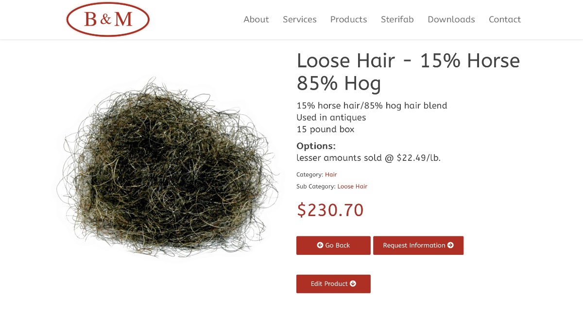

Added from article in 2008, note the author says pig hair is superior. But likely blends of animal hair was used by Ford, most of the body and upholstery in the early years using the stuffed pleated diamond tufted cushions were made in the North, long way from Southern states where Spanish Moss was found.
Figure 7: Ford Model T / Exploded Seat View

Thanks for that, Dan
that is a picture that I've never seen before

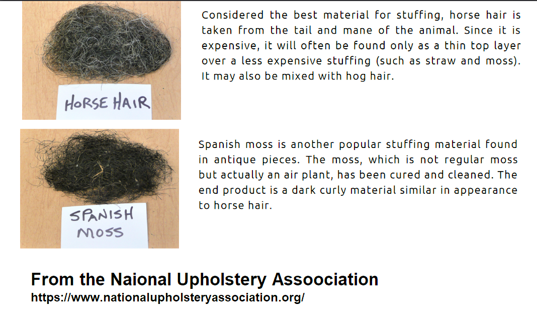

Did some research on the use of Spanish Moss for upholstery stuffing.
Here are some facts:
-The Spanish Moss hanging from trees do not contain contain chiggers (which will cause itching & rashes on humans.) This was an assumption as they were present in the foliage below the moss and not on it.
-Spanish moss is not a moss . It is technically a bromeliad, like a pineapple or a succulent.
-Spanish Moss at one time was harvested and ginned commercially. Through a specific curing and ginning process the outer grey bark was removed and the remaining filaments were used for upholstery in cars, furniture and mattresses. The mattresses were well known for being exceptionally cool. The grey bark was often used for mulch as well. The peak of the commercial harvest of Spanish moss may have come in the late 1930s. It was harvested for commercial use until 1970 when synthetic fibers made its use obsolete.
Here are the myths:
-The plant material hanging from the tress were not directly used and the processes of curing & ginning would have removed the chiggers. Therefore the stories about Ford recalling Model T's in 1915 as a result of seats stuffed with "Spanish moss" having small bugs, known as berry bugs or chiggers, crawling out of the seats and bite drivers and passengers.

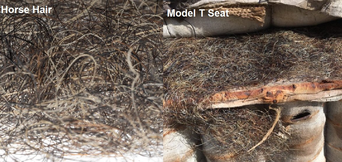

-I'm certain that everyone would agree that Ford used whatever was the least expensive material. In looking at the images of horse hair and processed Spanish moss - the color differences would indicate that horse hair is in that seat. That is not to say that a mix of horse hair and Spanish moss was not used. Unless there is a photo to contradict the appearance of horse hair - pure moss is a myth.
Safe to assume that horses were plentiful back in Model T day's and eventually Horse's were replaced by mechanical means and hair became more expensive. Likely a substitute was used . There is no question: Henry would not be using Horse hair Today at $500 60$1000 a pound
Note differences is material thickness and color -
