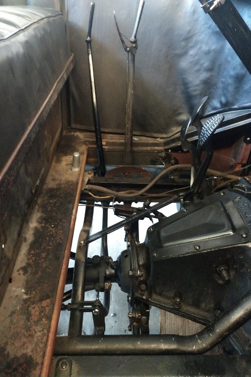

A short while ago I posted about my Ruckstell being engaged all the time. Due to a series of events only a Model T owner could experience, I was left with no shifter but instead had the shift lock on the axle to reckon with. Nothing was working to get the Ruckstell disengaged so I could take a joy ride.
WARNING: You're not going to like this part.
I put the rear axle on jack stands, started the car. Put the wheels in motion. Reached through the spare tire from my position kneeling on the floor of the garage, firmly grasped the shift lock lever.
CLICK!
Took my joy ride after remembering of course to take the car off the jack stands. All back to normal save for the fact I need to order a shifter if I choose to continue with the Ruckstell.
Thanks for all the help.
Gerrit
CLICK!
Gerrit

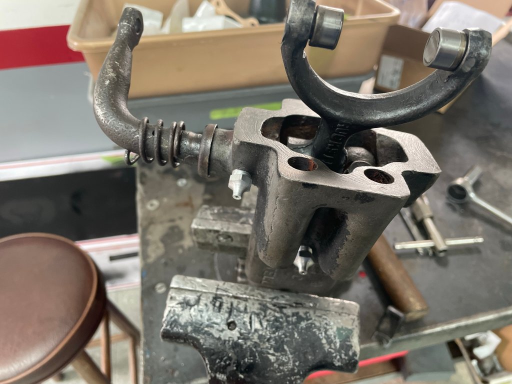

I recently experienced something similar when driving on the Ohio Jamboree where the Ruckstell shift lock arm lever suddenly would not come out of Hi-range. Once I got it back to the shop, I disassembled the shifter assembly from the axle housing and found the inside of housing assembly was covered in light surface rust. I drained the axle housings and found it had water in it and milky lube. (For the 'criticizers' above, this Ruckstell had been completely gone thru about 6-7 years prior where we had baked the housings and all components and roto-blasted all of the components to bare metal. All wear areas had been rebuilt and machined on the shifter housing so it operated flawlessly and the driver knows how to shift one.
) The water likely entered the shifter housing during a tour a few months prior when we were all fording creeks and rivers. To reiterate, prior to that tour, the shifter has always shifted effortlessly. On this one, the plunger that the spring pushes against had become lodged in the housing from some rust. I disassembled everything and repolished the bore and the plunger. Reassembled and added a new piece of leather under the shift arm lever cap.
Additionally, I replaced the original plunger spring with a lighter weight spring which still holds enough tension however takes less lever pressure to move. While I was in there, I noticed there really wasn't any lubrication coming up from the differential lube, so I took the liberty to install era-authentic grease fittings where I can add grease to the plunger & roller area, and to the shift lock arm area. Hopefully the grease around the shift lock arm will slow down the access of water if we ever cross deeper bodies of water again. Also, lesson learned for me about checking rear ends after tours where we cross creeks.

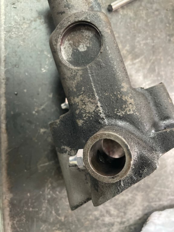

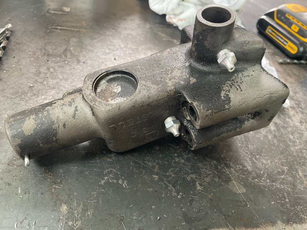

BRENT in 10-uh-C wrote: ↑Tue Mar 07, 2023 10:22 amI recently experienced something similar when driving on the Ohio Jamboree where the Ruckstell shift lock arm lever suddenly would not come out of Hi-range. Once I got it back to the shop, I disassembled the shifter assembly from the axle housing and found the inside of housing assembly was covered in light surface rust. I drained the axle housings and found it had water in it and milky lube. (For the 'criticizers' above, this Ruckstell had been completely gone thru about 6-7 years prior where we had baked the housings and all components and roto-blasted all of the components to bare metal. All wear areas had been rebuilt and machined on the shifter housing so it operated flawlessly and the driver knows how to shift one.) The water likely entered the shifter housing during a tour a few months prior when we were all fording creeks and rivers. To reiterate, prior to that tour, the shifter has always shifted effortlessly. On this one, the plunger that the spring pushes against had become lodged in the housing from some rust. I disassembled everything and repolished the bore and the plunger. Reassembled and added a new piece of leather under the shift arm lever cap.
Sounds like that Ruckstell put you through some life changes, glad it all worked out. Good advice to check the rear end after water crossings. I did put some liberal grease in my shift-lock upon reinstalling it, as I found it relied on no lubrication from the differential.
