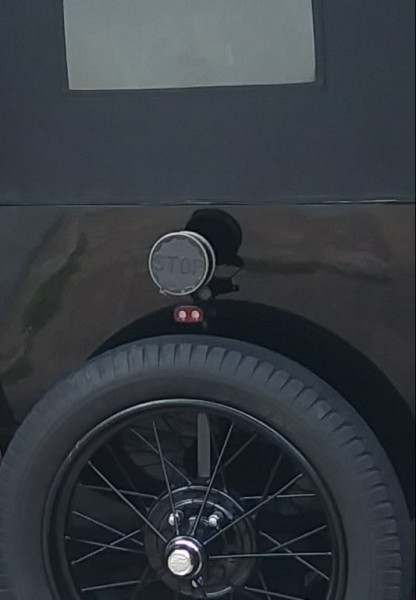

I have a period correct stop light that is wired separately from the tail light. Below that is a new bicycle led flashing taillight that works very well at getting people's attention. They don't race up as close as they did without it.

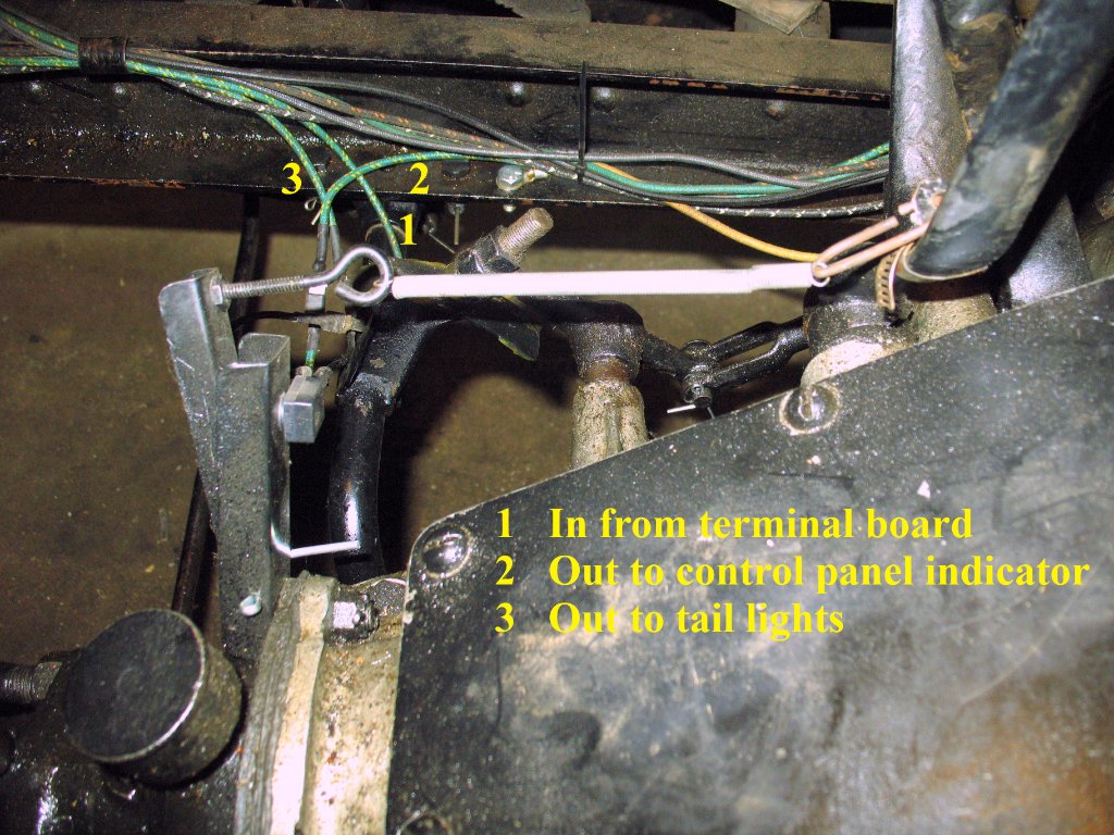

Home made brake light switch. The pushbutton switch and the eye bolt are store bought. The sheet metal scraps, spring, and cotter pin were stuff I had on hand.

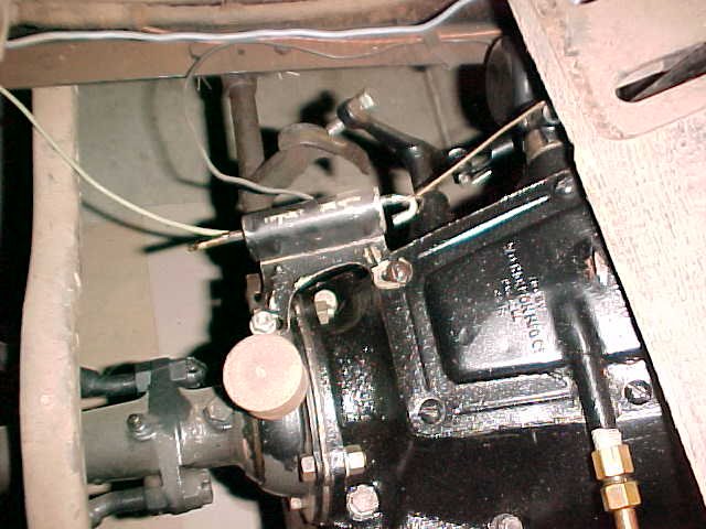

The repop switch that mounts on the bendix cover works well & was correct for the 25-27 accessory brake/stop light.
