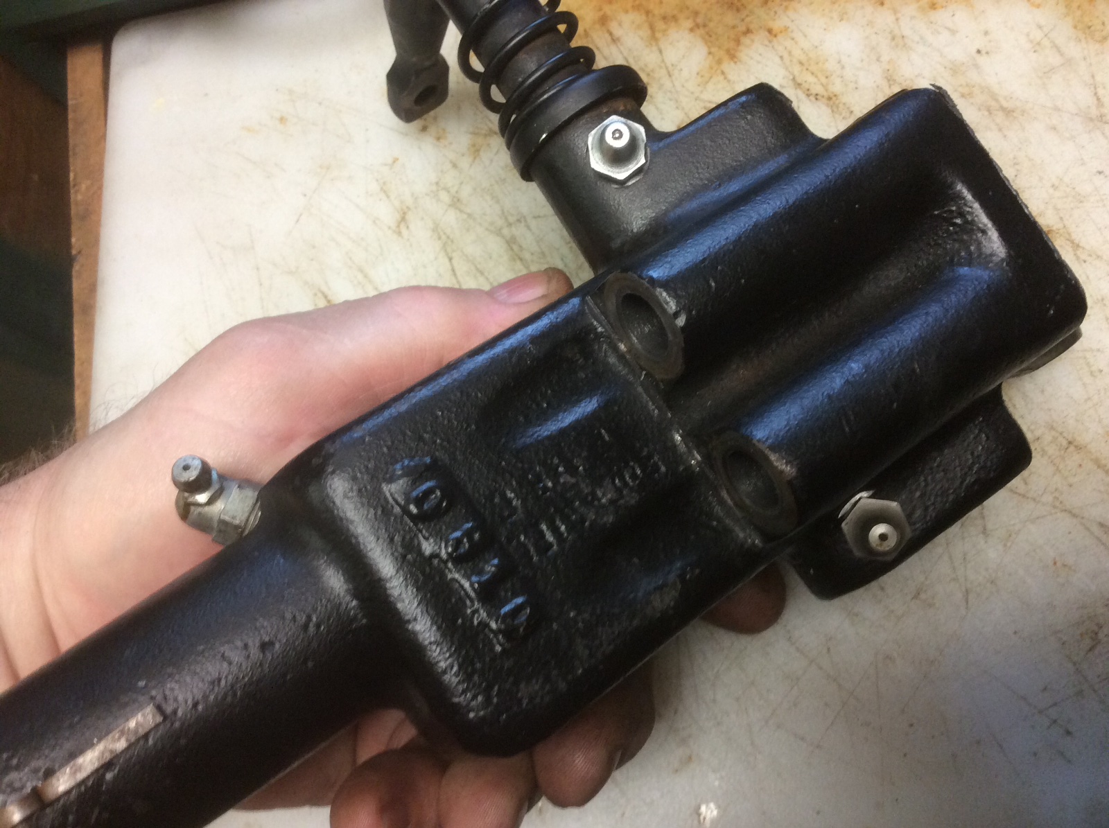

Thought I’d start a new thread with some Ruckstell questions. I’ve only done a couple over the years and the last one was a complete NOS original Ruckstell kit that had been squirreled away since made. That one was pretty easy.( still , lots of work !) I’ve got about 3 years on it now and I always wished I would have installed some zerk fittings on the shift lock, like Stan Howe originally suggested. I pulled it out and sure enough, it was dry as a bone inside. It was well greased when originally installed. I went one step farther and installed 3, which is probably overkill, but the shift locks I’ve purchased lately have a lot of wear showing on the shaft.

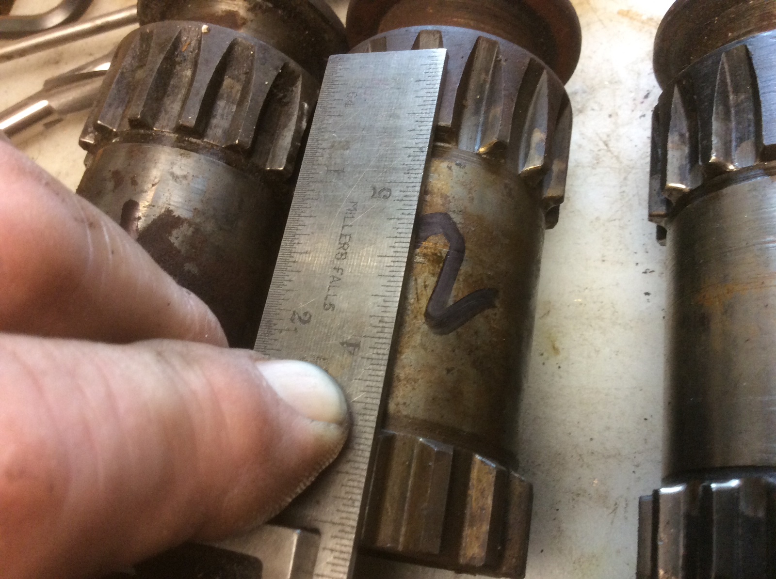

I have a couple friends that are currently doing a Ruckstell rebuild right now. I talked to him this morning about an issue with the sliding gear on his unit. It appeared to the eye to be in excellent, almost unused condition, but would not slide easily from one range to the next. He said the gear teeth were not in line, And thought perhaps this one was twisted. I thought that too was probably the issue, as I figured when these were Hobbed out, they were probably in line. I dug out three gears here and they make more questi9ns now than answers. All are original, one is NOS , one is very nice original and the last one is shot. 2 have the gear teeth in line, and the 3rd, the teeth are offset a half tooth. . The one marked NFG is what they start look8ng like before you head into a neutral situation. As you know, a Ruckstell in good operating condition will not have a nuetral. I’d love to hear thoughts on these issues.-

I suppose the zerk's will help, but they look like shit! I have Ruckstell's in every T I own, and have never had a problem. The main problem is the original fiber thrust washers are not available, and I refuse to use those steel shims that are currently offered. What is wrong with doing things the way they are supposed to be? There are far to many people here is this club that think they know more than the manufacturer!

Thanks Randall , I’m actually going to redo it today, and will use much smaller fittings. I’ll post a picture later. I have this one I’m going to send to Larry.
He brings up a great point re/ the fiber washer. For some reason it’s the only original part that isn’t reproduced. I agree with him that a correct fiber washer should be used. The MTFCA Ruckstell repair booklet shows to use a steel washer in that place. I agree with Larry that’s a poor choice, and I also believe it’s bad advice from a rebuild document. Any Ruckstell that has any machining cleanup done will need a correct spacer at that point. If you are starting with new or NOS parts, you may get away with the thickness of a steel washer, but the ID is all wrong. Any slop or wear in that area, and you have a slinging , hardened steel washer revolving inside that could cut an axle in half, eventually. Perhaps the fiber washer isn’t offered because of the variation of thickness required, perhaps because the original type fiber material is so hard to find. I was able to purchase some original red fiber from Gene Krystoffy, of alphabet ford transmission fame, and some thicker stuff that Richard Gould Found overseas.
I’ll be sure to get enough grease where I want it, and it may just make Larry’s head explode, too. He brings up a great point re/ the fiber washer. For some reason it’s the only original part that isn’t reproduced. I agree with him that a correct fiber washer should be used. The MTFCA Ruckstell repair booklet shows to use a steel washer in that place. I agree with Larry that’s a poor choice, and I also believe it’s bad advice from a rebuild document. Any Ruckstell that has any machining cleanup done will need a correct spacer at that point. If you are starting with new or NOS parts, you may get away with the thickness of a steel washer, but the ID is all wrong. Any slop or wear in that area, and you have a slinging , hardened steel washer revolving inside that could cut an axle in half, eventually. Perhaps the fiber washer isn’t offered because of the variation of thickness required, perhaps because the original type fiber material is so hard to find. I was able to purchase some original red fiber from Gene Krystoffy, of alphabet ford transmission fame, and some thicker stuff that Richard Gould Found overseas.

this last version looks much better than the one with only 3 zerks. Perhaps it would be even better with 13 grease cups. At least it would be more original than these modern fittings.

Here’s another try. Maybe with a couple of dabs of black paint, this may even satisfy a Ruckstell purist. Anyhew, my shift lock will never wear out now, which is what I’m after.

Thanks for all the comments, and was really hoping to get that kind of info from long time users. It’s likely been on the forum in the past, but it’s been awhile. I should mention I work really hard to be period correct. My Merc speedster has pin alemite fittings on everything for that reason. Before the purists explode, I can mentally get away with that on a speedster. ( I personally don’t like using OR filling a pin alemite gun, perhaps there are some tricks we need to hear about )
The vehicle this modified shift lock is for is well restored mechanically and every dope cup hides the alemite fitting inside the cap. I really wasn’t thinking , because of the placement of these so hidden, and only that I would be using a modern grease gun when lubing the chassis. So, point taken, Ed.

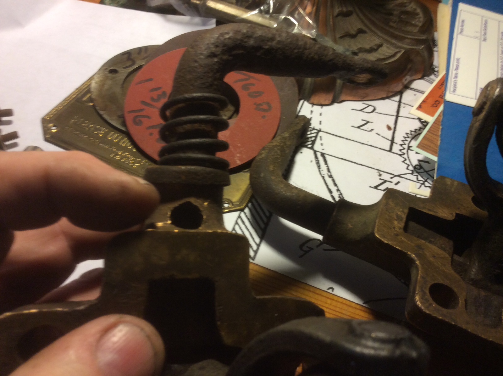

Shown below is an early shift lock. It seems Herr Glover recognized the need for a lubrication at this point also, and even though primitive, an extra hole here ( I’m pointing to it )allows lubrication ( and dirt,dust,rain, yuck) to do some good. AND, don’t forget, he continued to improve his product.

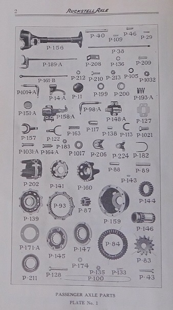

........I believe on the parts sheet it’s labeled P-171-A. Still confusing to me why a fiber washer would be pinned there. I let them float, as it’s not going anywhere. ...........shown next is the manual recommended Ford washer, next in line is a washer that came to me with a bunch of Ruckstell parts.....it’s old red fiber, but I did not take it out of an axle. So, just a guess on my part. The third example is what I’ve used on my two rebuilds. It is 100+ year old material, red fiber and tougher than the Hobs of Hell ! I’ve taken this same material out of original model NRS , F transmissions. Ford even used it , segmented, on the early transmission bands. so, now hoping we can hear from the more experienced among us what they think about this washer issue. I could be wrong, but believe it’s the only original Ruckstell part not being offered. Frankly, it scares me a bit to use a hardened steel washer with the wrong ID at this point, so I’m all ears, now.
