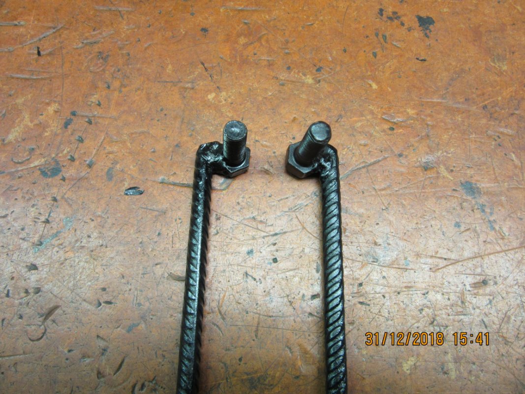

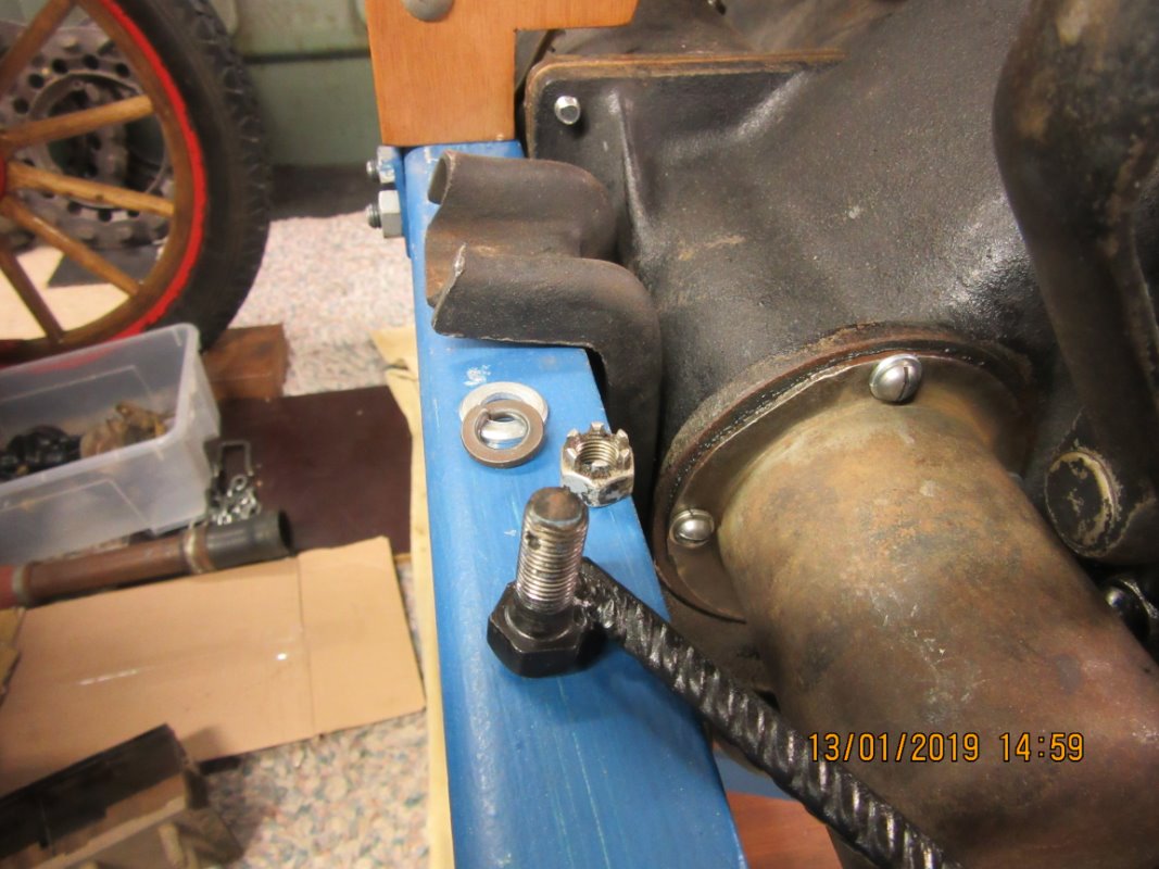

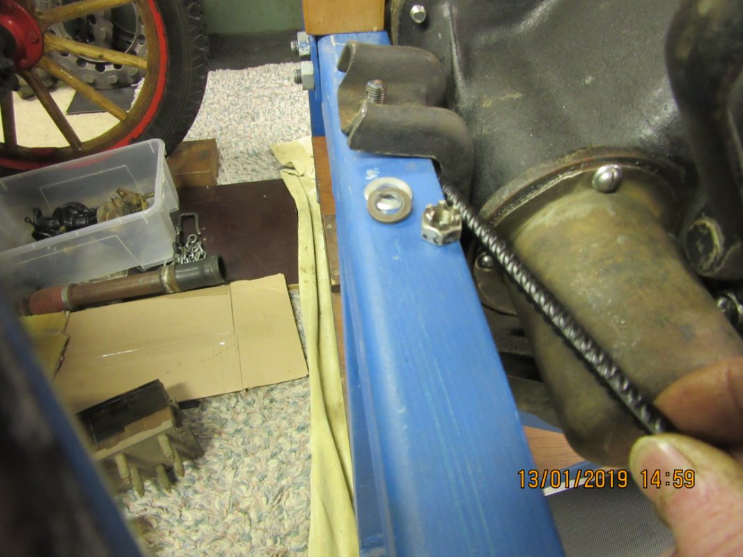

To mount the two bolts on the frame rail and the ears of the oilpan.
I made two bolts with a piece of iron .
Particular the bolt near the starter .

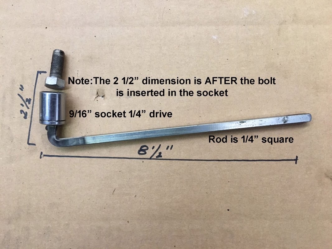

Here is a tool that I made for doing the same thing. Really works good.
    1. Line the holes up.
      2. Slide the both up through from under the frame rail.
        3. Hold the bolt in place with the square rod.
          4. Get the nut started and tightened to your specs.
            5. Insert cotter key/pin.
              6. Insert the wood block.
              Upper, rear motor mount bolt holder

              I may be seeing something that is not there but it looks like the ears have been bent and they are not sitting on the frame properly. I think all of mine sit level with the frame. Just my .02.
              R.V.Anderson
              Posts: 680
              Joined: Tue Jan 08, 2019 6:01 pm
              First Name: R.V.
              Last Name: Anderson
              * REQUIRED* Type and Year of Model Ts owned: 1914, 1920, 1923, 1923
              Location: Kennedy, NY
              Re: Two difficult bolts
              Post by R.V.Anderson » Mon Jan 14, 2019 1:26 pm
              Dick, you are correct. I noticed the same thing. The sagging will definitely contribute to the holes' not lining up, and in addition may indicate cracking either under way or about to start. A careful examination and possible repair is in order before getting out on the road, in my opinion.
