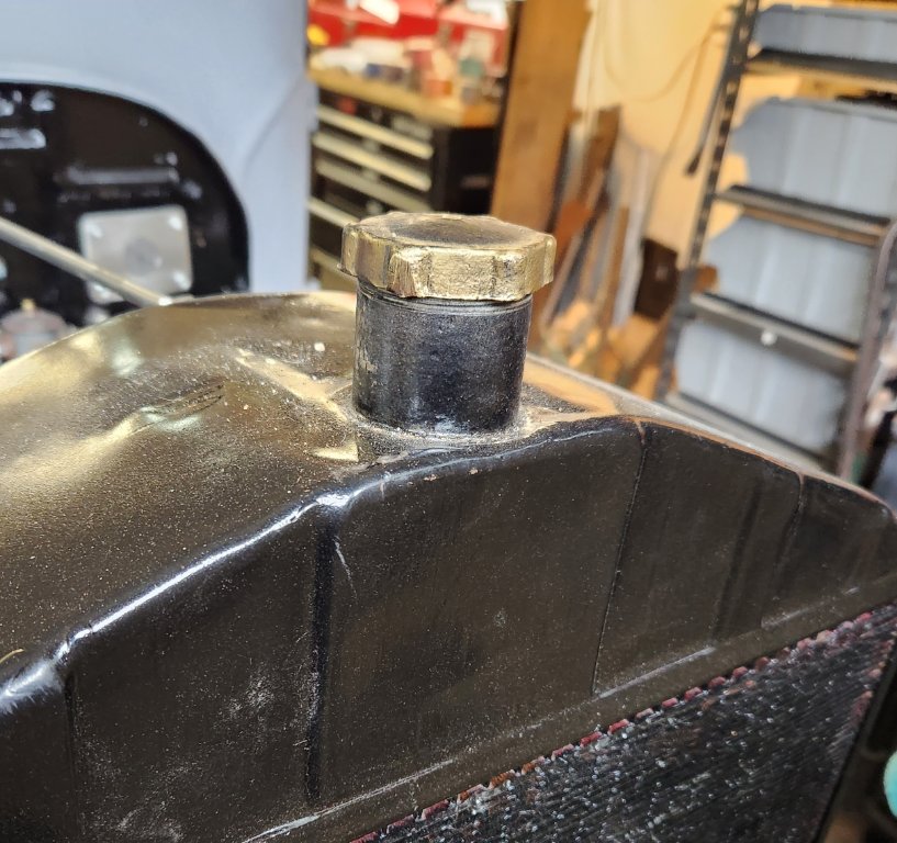

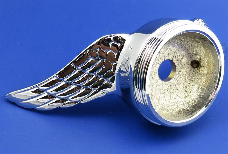

The cap has yet to arrive, but when I look at the picture of that cap on Lang's (middle image) it shows male outside threads ? All other radiator caps online also seem to have outside threads. Now my poor ol' T has a strage history, coming from Argentina, and it has a lot of odd patches and non-stock changes over the years - At this point it has a very simple copper cap with female inside threads - (see top image) --- I looked across the web to see if their is some type of M/F adapter / gender bender that I can screw in between and I have found thats even close is a 'filler neck'... These do have the female threads on the top but they apparently needs to be soldered onto the radiator ???
Anyone recognize my radiator cap? is it possibly from a tractor? Anyone know of a screw on filler neck?

Here is a motometer from the Model A section of Snyder’s antique auto parts, which has female threads on the cap and male threads on the neck. I assume that your radiator cap is for a model A, but I could be wrong if the cap size and TPI is different from a Model A. All I do know is that it is not for a Model T. Jim Patrick

Show us a photo of your radiator neck please.

Yes a photo will help. By your description you radiator neck has been changed. A standard T radiator neck has female threads and the cap is male. Your is opposite.

That's an aftermarket radiator. I'm sorry to say that your new motometer will not fit it. Maybe an adapter can be made??

Aftermarket eah? Makes sense with this car- Its a bit like the Johnny Cash Cadillac song ..."one piece at a time"... resourceful mechanics in Argentina... Thanks for clearing this up! I'll find a way to hack it in somehow - might just machine a simple adapter ---

It looks like the thread on the T radiator cap is is 2" 20 TPI - The model A thread is 2.25"-18 TPI - so regrettably that may not work -
Drilling the hole in my existing cap is a good option! get's me the temperature - which is the higher priority -
I'm also looking into possibly machining a simple coupling with an inside 2-20 thread... OR - buy the filler neck and try soldering it on - OR - somehow using a lathe and putting a 2-20 female thread on the inside --- (Sadly, I'm retired and no access to our walk in shop lathe)
