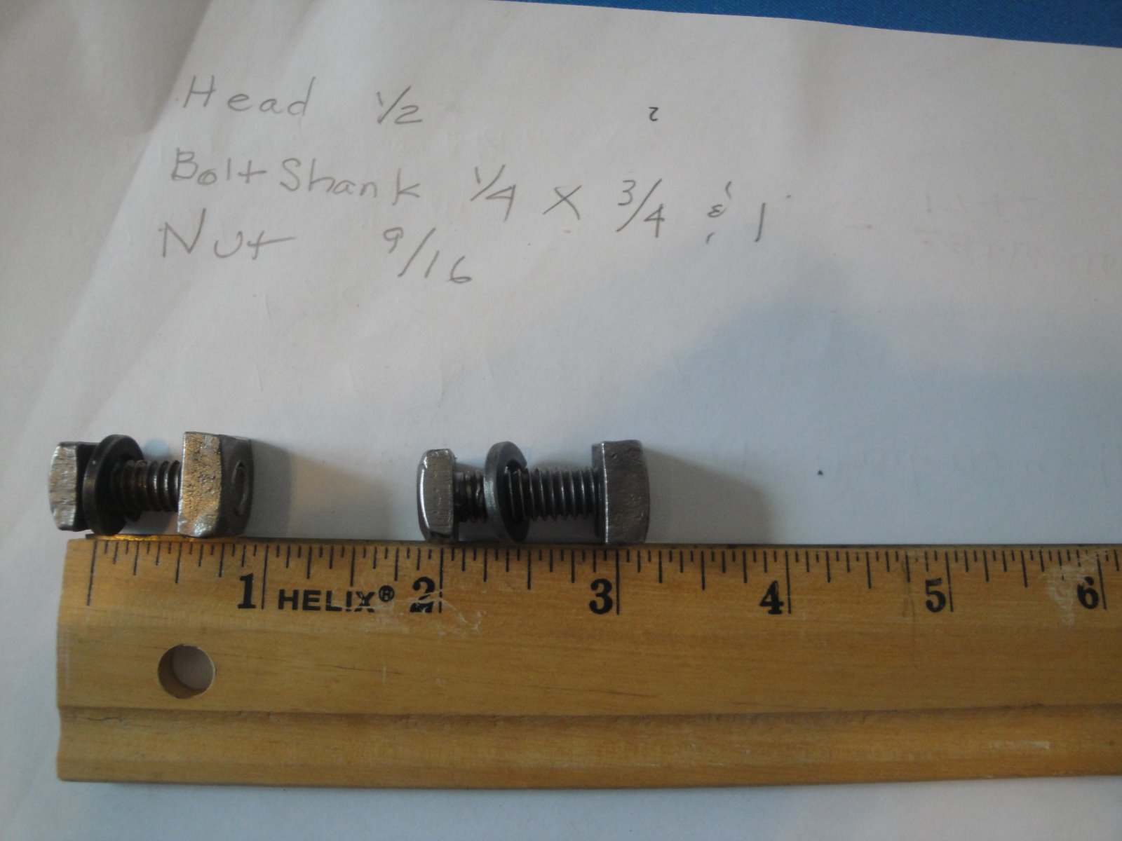

There are few square head bolts used on a '24, however if you have the upholstery out, the back panel is bolted together with them, at least my '25 roadster is. Those bolts are used on Model A's for the cowl, and they are perfect. The center spring bolts are available from Bobs. The ones for the spring clips are a special Ford design, and I don't know who makes those. I was able to find NOS for my car when I restored it. There are some more special Ford square head bolts used on the early cars for the engine splash pans, and gas line bracket that have a fine thread, and a cotter pin hole. I don't know if anyone is making those.

Sorry but at this point the issue is getting muddy, with were to get square headed bolts (but useful if someone did need them). Except for a few locations as said above, they were not used. The question is in regards to 1924 chassis bolts. Any square headed bolt, except for the noted locations, would have been put on by a past owner with what was at hand. The only other place that would have used square headed bolts and not noted above would be the 6 engine main bolts, the clutch drum screw and the fan shaft which had two flats. The exception to that might be after market items not made by Ford.
