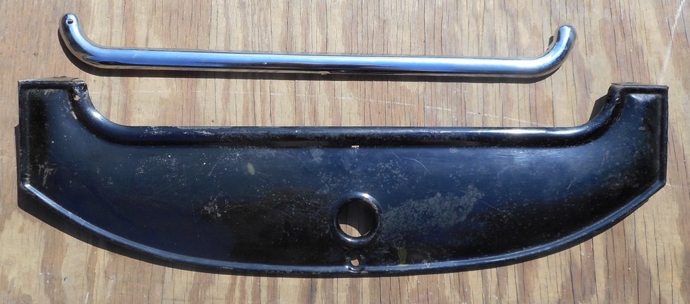

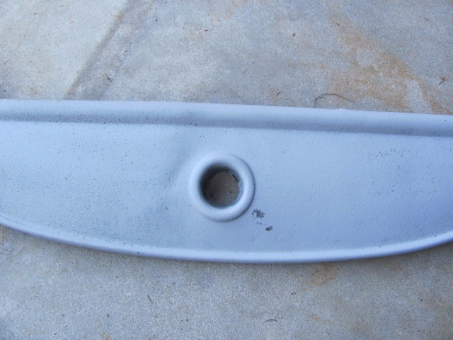

Mark is correct as that is easy way. Better if you tap out and clear the threaded hole in the motor mount, and check the fit for the new round head single slot screw with washer. Washer is needed to keep the hole covered, as sometimes the hole is a bit oversize diameter on purpose to help locate the hole when fitting to the variations of radiator mounting.... factory tolerances needed. Narrow slots are for the trim strip tabs.
Original apron.

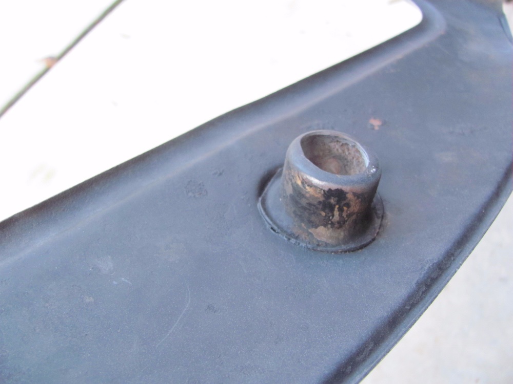

That apron was a nice one, but the collar was missing, needed one, found, and added. Originals were spot welded in just a couple of places.
If these collars or spacers are missing, you have to find an original (red primer part) or fab up something that keeps the apron spaced from the frame.
apron spacer.jpg (52.25 KiB) Viewed 7693 times

I struggle to see the relevance of the collar, other than it serves as a receiver for the crank handle spring. It is not a spacer to keep the apron away from the frame as that is done by the machine screw which fixes it to the spring yoke. It is not really a receiver for the crank handle spring either, as all the T's preceding its introduction had no need of it.
It does serve to make fitting the apron more difficult, as the hole in the end is rarely where it aligns with the handle and the pan snout. It is a PITA.
Am I missing something?
Posts: 4042
Re: '27 Radiator Apron
Post by DanTreace » Mon May 13, 2019 9:35 pm
Don't think Ford would have added the collar, unless it does provide some purpose. Acts as a the receiver for the hand crank spring to compress when hand cranking.
But not all aprons have the machine screw, that is only a '26-'27 thing, the aprons for the earlier high radiators have the collar, but not the hole.
But must have caused some rattles, as the Improved Car apron (3977-C, with trim strip, -E no strip but with slots for it, and -F no slots) added that machine screw.....but Ford didn't eliminate the collar.....so it must have been a good reason :D

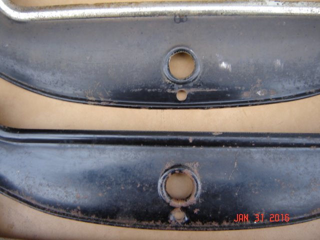

These '23-'25 aprons (3977) are also different dimension in height, as the later Improved Car with the hole for the machine screw, you can't just drill one of these early ones for a hole, it won't fit to the Improved car engine mount well, as the crank handle is in wrong spot, the Improved Car has higher hood shelf construction that requires the later 3977-C, E, F.

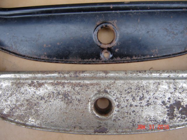

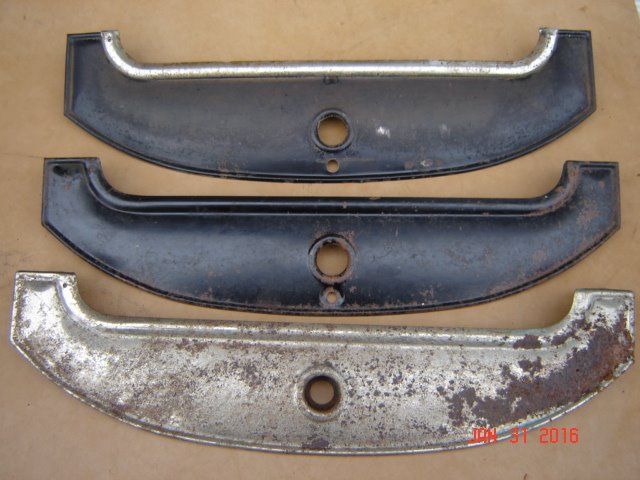

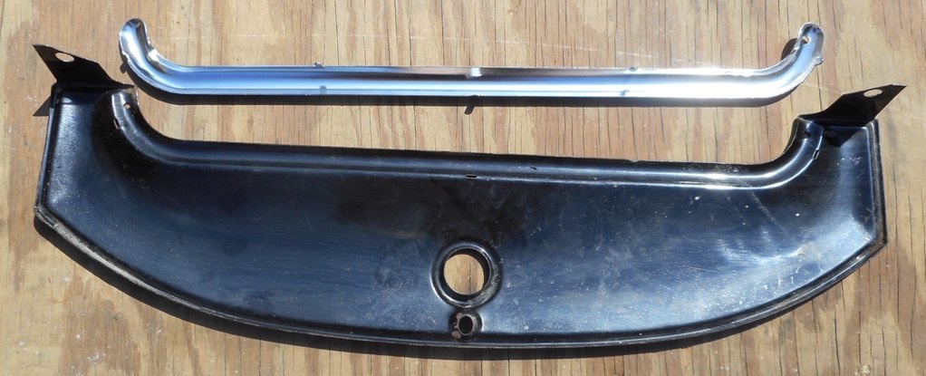

All radiator aprons with a hole for the screw are not for 1926-27 cars. 3977-F has the hole, but it is for 1926-27 TT trucks.
The radiator apron started in1924-25 as part 3977
In 1925 Ford came out with an accessory nickel plated radiator and apron. that apron is 3977-B. (See Bruce's Black Book, page 566)(It is listed on Ford Letter, April 30, 1925)
3977-C is the 1926-27 apron with the nickel strip and the screw hole.
3977-D is just the nickel plated trim strip.
3977-E is the 1926-27 painted apron with the screw hole, but without the strip.
3977-F is for 1926-27 TT trucks. (factory #TT-8016) It is the same as 3977 used in 1924-25. with the added screw hole for securing the apron to the front engine mount/spring clamp.
Here are photos of 3977-C, on top. 3977-F in the middle. And 3977-B on the bottom.
