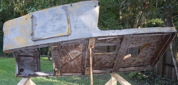

This photo shows the runabout body blocks, there are four, two each in the long crossmembers of the subframe. The blocks are offset from the mounting holes, that is normal. Body bolts secure these blocks from moving.
There are two more small blocks up at the corner of the cowl/subframe, those are held by wood screw thru the inside body frame, and are used for wood screw with larger washer to affix the leading edge of the splash shields to pull the front edge of the shield to the eliminate gap there, and for anti-rattle. And place round head wood screw with large washer into the longer wood blocks to also secure the splash shield.

I would like to know if the body shown is a roadster or roadster pick-up. If one looks at an area in back of the round wood post holding the body at an angle (a couple of feet back) there is a hole in the subrail. I believe this is for one of the rear fender fasteners. There is another "bun panel" which has a vertical embosing and is shorter than the one shown.
At one time the shorter panel was considered used on the roadster and the longer panel shown in Dan's picture thought to be used on the roadster pickup. However I am not sure of this and have even seen pictures of the Indy Plant with a roadster with the "bun panel" as Dan shows in his picture. Has this been cleared up over the years? Could it be a earlier/later part as opposed to roadster or roadster pick up having different panels?
Arnie
Arnie
- Posts: 3926
Re: Installing a 26 roadster body.
That body being sandblasted is a '26, Nov. '25 build, with the pickup bed, early version with front stake pockets immediately at the rear of the body tub. Has features of runabout with the panel used on most ones I have seen. It isn't the plain one. Was told to me it was always a pickup. Could have been so, as there were no holes or captive nuts in the sides of the rear tub used to fasten a turtle deck. Plus the old rubber plugs were still in the top prop holes.
Over the years the battery lip in the deck got rusted along with the hump section too, so someone flattened out the original battery door and just drilled holes in the flattened sides for screws to keep it in place over the battery cutouts in the floorboards!
