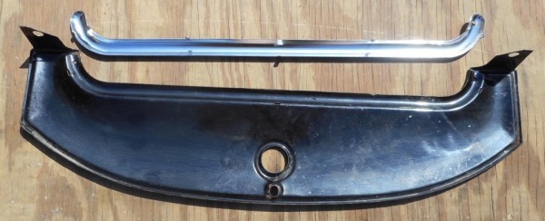

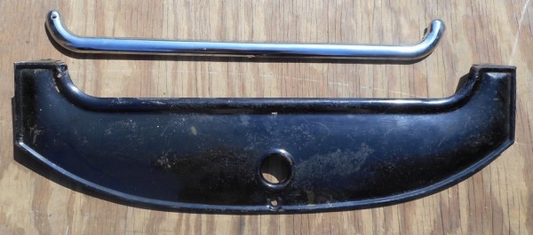

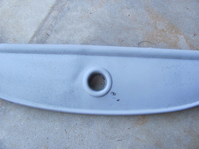

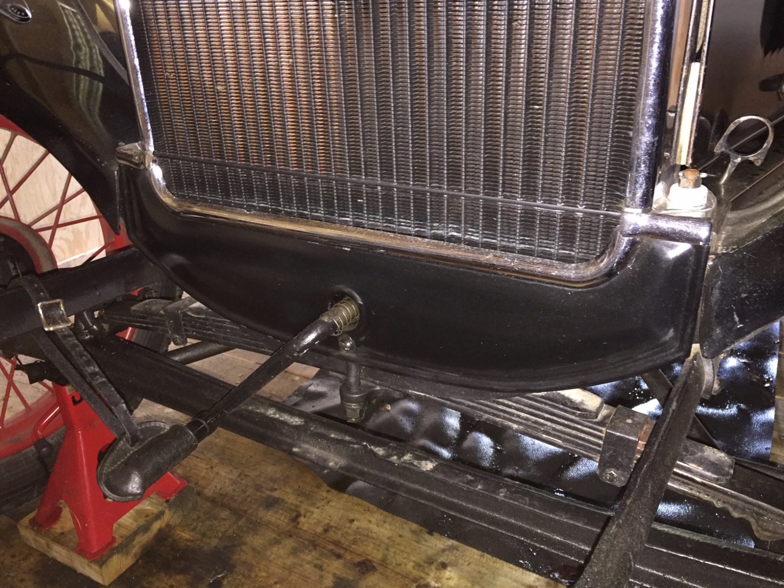

Mark is correct as that is easy way. Better if you tap out and clear the threaded hole in the motor mount, and check the fit for the new round head single slot screw with washer. Washer is needed to keep the hole covered, as sometimes the hole is a bit oversize diameter on purpose to help locate the hole when fitting to the variations of radiator mounting.... factory tolerances needed. Narrow slots are for the trim strip tabs.
Original apron.
Original apron.
ROBERTHOOPS

Typical reproduction! Don Snyder makes those. I believe his reasoning was to appease the hot rod boys. I would have made it exactly like Ford did, and let the hot rod boys deal with it! I've seen them and they are great except for the hole.

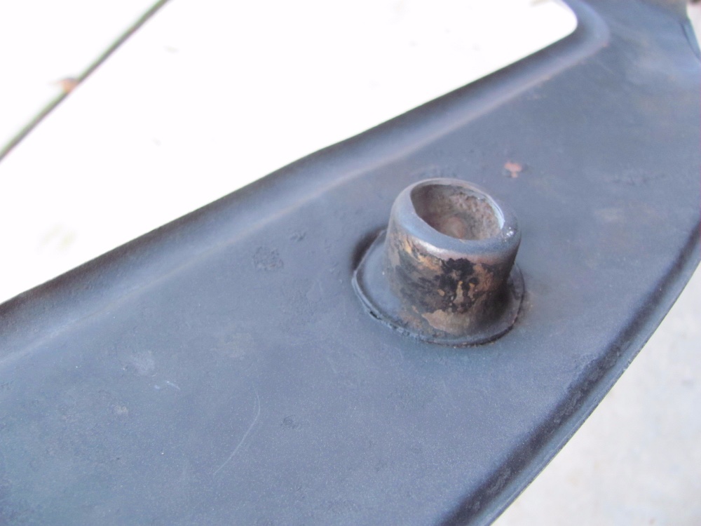

I bought a new repro apron from Langs a few years ago. I was beautifully made like the original. It even had the small tubing to hold the crank spring.

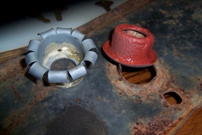

The apron Dan posted doesn't have the tube welded to it.
- Posts: 4082
Re: '27 Radiator Apron
Good eye Larry.
That apron was a nice one, but the collar was missing, needed one, found, and added. Originals were spot welded in just a couple of places.
If these collars or spacers are missing, you have to find an original (red primer part) or fab up something that keeps the apron spaced from the frame.

I struggle to see the relevance of the collar, other than it serves as a receiver for the crank handle spring. It is not a spacer to keep the apron away from the frame as that is done by the machine screw which fixes it to the spring yoke. It is not really a receiver for the crank handle spring either, as all the T's preceding its introduction had no need of it.
It does serve to make fitting the apron more difficult, as the hole in the end is rarely where it aligns with the handle and the pan snout. It is a PITA.
Am I missing something?

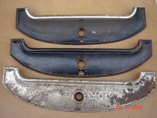

All radiator aprons with a hole for the screw are not for 1926-27 cars. 3977-F has the hole, but it is for 1926-27 TT trucks.
The radiator apron started in1924-25 as part 3977
In 1925 Ford came out with an accessory nickel plated radiator and apron. that apron is 3977-B. (See Bruce's Black Book, page 566)(It is listed on Ford Letter, April 30, 1925)
3977-C is the 1926-27 apron with the nickel strip and the screw hole.
3977-D is just the nickel plated trim strip.
3977-E is the 1926-27 painted apron with the screw hole, but without the strip.
3977-F is for 1926-27 TT trucks. (factory #TT-8016) It is the same as 3977 used in 1924-25. with the added screw hole for securing the apron to the front engine mount/spring clamp.

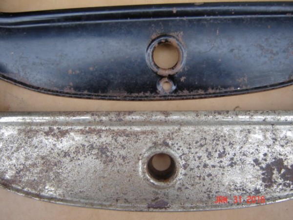

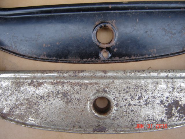

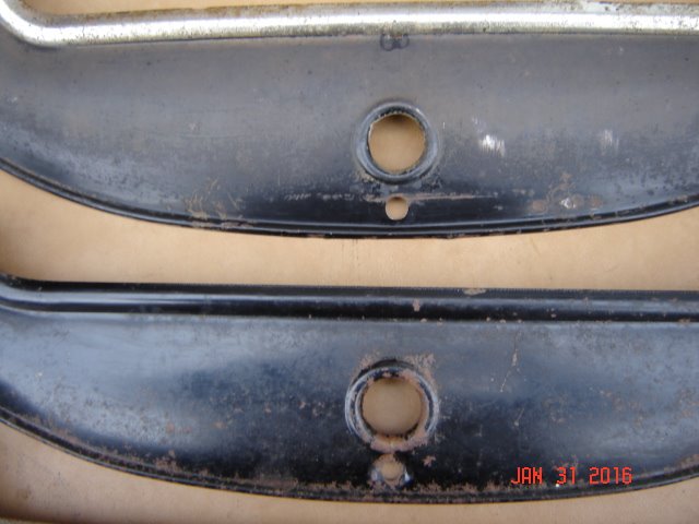

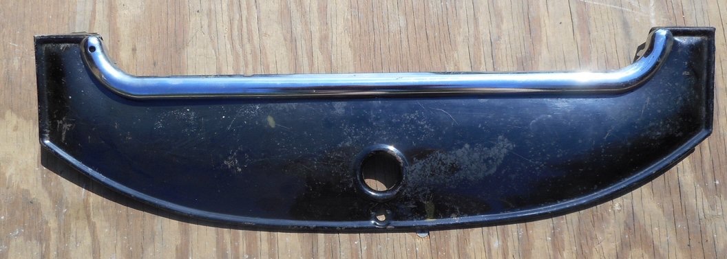

Here are photos of 3977-C, on top. 3977-F in the middle. And 3977-B on the bottom.
