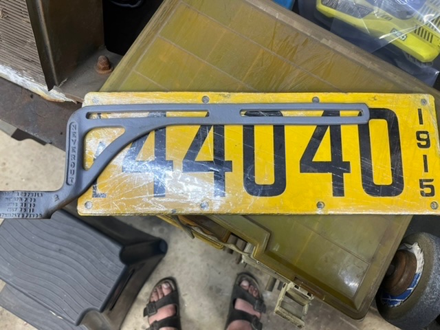

Did Neverout or anyone else made a license plate extension to fit a longer plate than the stock Ford issue?

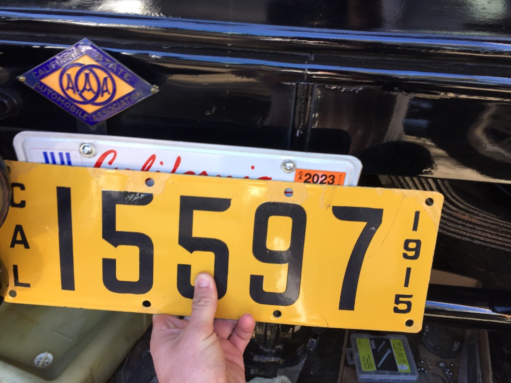

I would also be interested to know this. The mounting holes on a 1915 bracket do not line up with the holes on an original CAL 1915 plate. The other problem I have encountered with the larger plate is the exhaust pipe blows right on the back corner of the plate. I have considered making my own adapting bracket to not only solve the problem with the mounting holes, but also to relocate the plate down and to the left away from the exhaust pipe. If an era correct accessory was available I would prefer that.

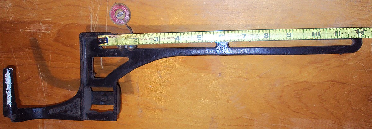

This 1912 iron Neverout is 11 3/4 overall slot width. I don't know what standard ones are.

A 1915 Ford license plate bracket is a separate unit bolted to the side of the lamp bracket. My question is there a license plate extension available for longer license plates as pictured above?

The same issue has been coming up over here. The 1915 California plates do not fit the Ford-supplied 1915 bracket.

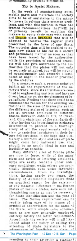

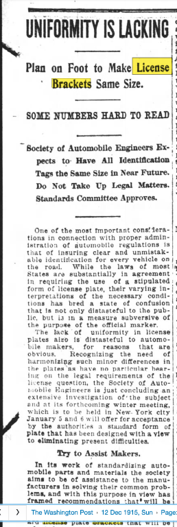

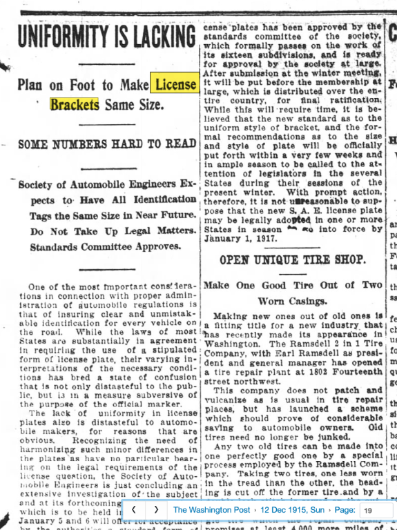

Plate standardization was becoming a serious topic by 1915.
This article from December 1915 describes how standardization committees were moving towards establishing standards for both license plates and mounts, which would in theory be adopted by all domestic manufacturers. They wanted plates to be simple to put on, held securely, clearly visible and illuminated, and easily read, regardless of state, and that this would come into use by 1917 or so.

Canadian Ford 12" long, mounts on the early body mount for the 15 tail light.

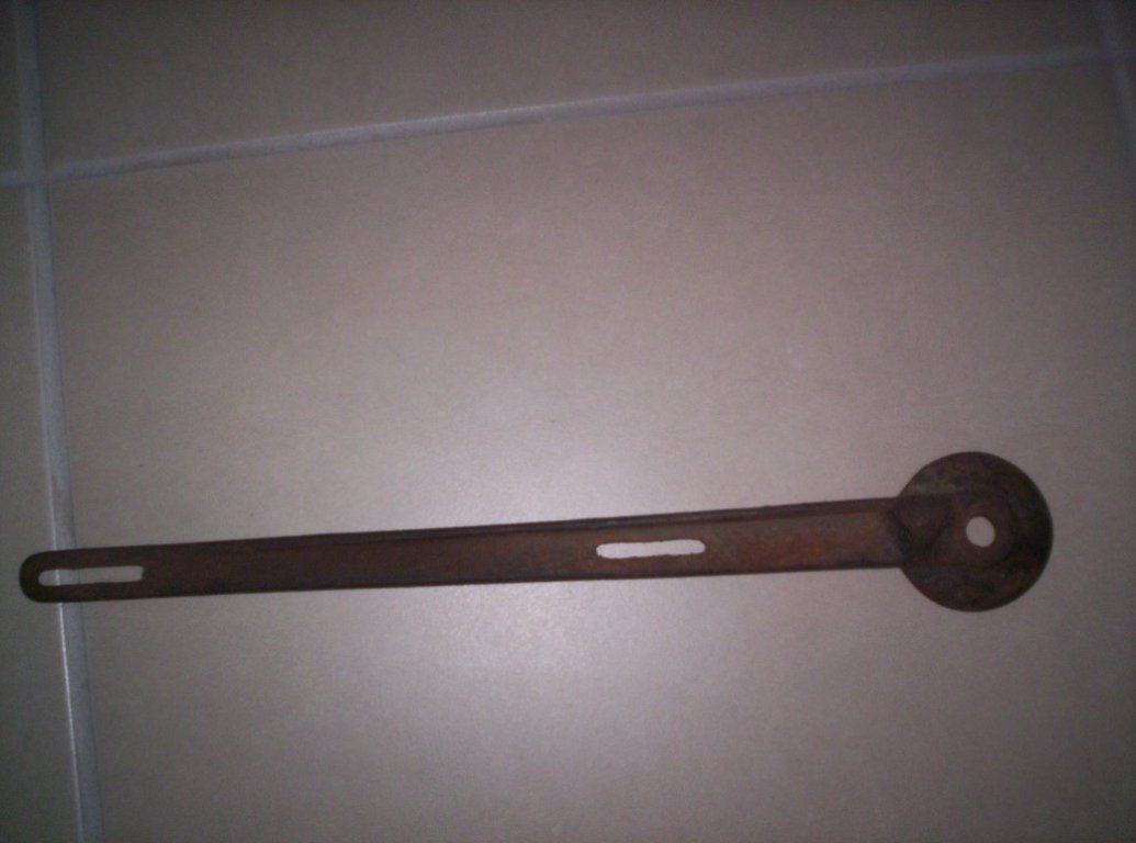

This one will fit
Posts: 3954
Location: Lomita, California
Re: 1915 License Plate Bracket
Post by Original Smith » Tue Nov 22, 2022 12:14 pm
Kim: You have missed the point. That early bracket doesn't apply to a 1915!

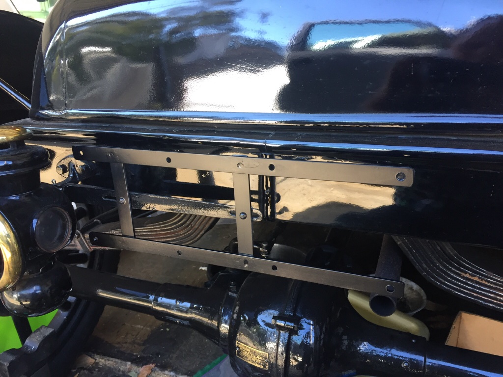

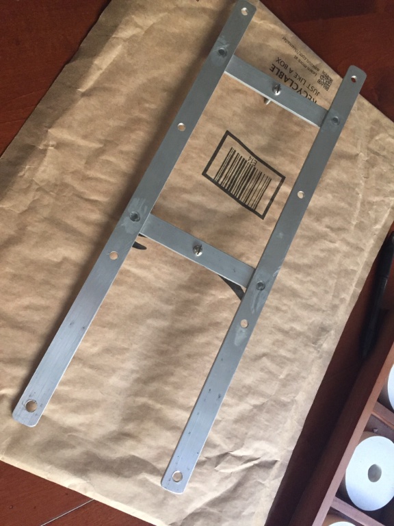

Post by Chris Instness » Thu Mar 16, 2023 12:27 pm
Just a follow up to Larry’s question.
I am yet to find an era bracket to solve the issues with mounting a 1915 CAL plate to a 1915 bracket, so I made my own. Very simple, but effective. It is strap aluminum riveted together. It also centers the plate with the tail lamp and moves it away from the exhaust pipe.
