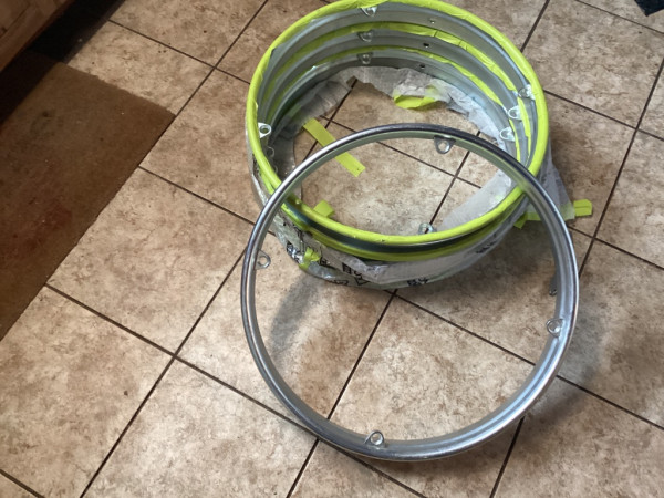

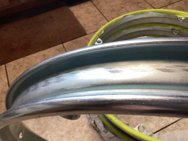

I just had the 4 brand new rims delivered from Australia and they are beautiful. A big thank you to Allan, down under, for mentioning the company that made them. They are nice and heavy with a zinc plating everything is so smooth. If you want some excellent rims, check them out. The only problem I had, was getting the packing tape off. I have not had any tape that was so sticky. Will have find out where it was made. Delivered right to the door with no hassle what so ever. Now to mount my new Blockley tires!

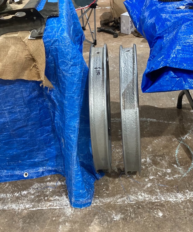

Beautiful 30x3 1/2 rims ! Thanks for sharing....I have 2 @ Chickasha for $110 each. ...sorry for the unabashed advert
