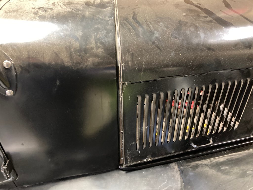

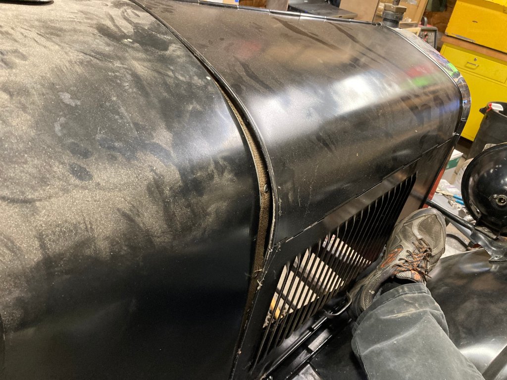

Post by bmklawt » Sat Mar 18, 2023 4:44 pm

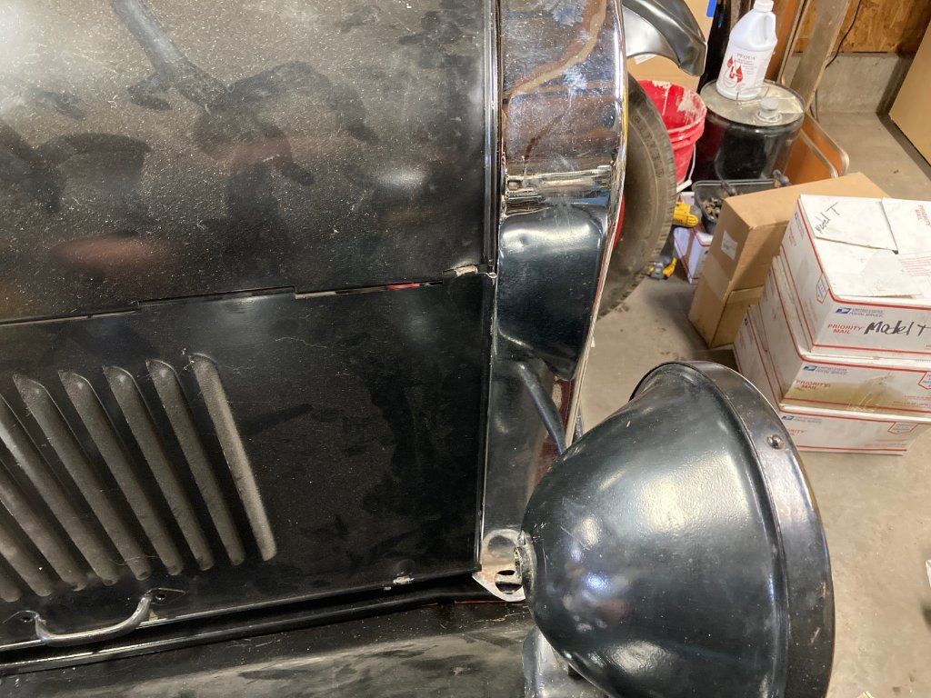

The radiator on my Touring has never fit right, I had thought it was the frame, it was bent and welded, I bought a new frame and brought it to frame shop and had them make sure it was correct per the frame drawing I have. Now that I putting it together with the new frame I am having the same problems, It's as if my radiator is to high, I can pull the bottom of the radiator shell out towards the front of the car which helps but can't pull it out far enough, the light bar is in the way, looking for guidance on what to check or do.
I can get one side or the other to fit but that moves the center of the hood on the cowl side to the left or right of center.
The top of the shell is 21-1/2" from the hood shelf, I've check the dimensions of the hood against the drawing on Lang's website, I'm stumped.
The 3rd picture is me holding the hood bottom edge where it should land when closed.

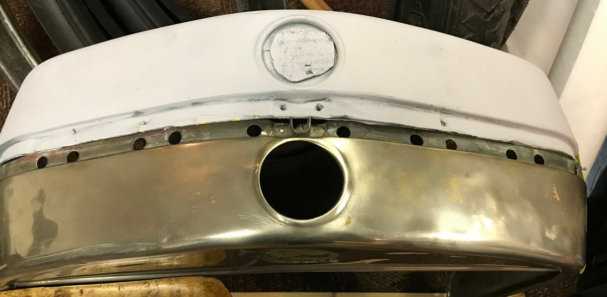

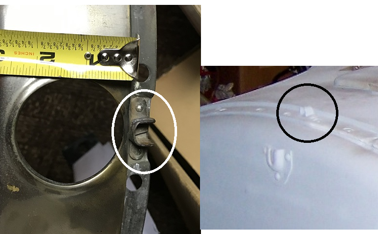

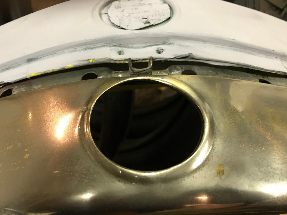

Before I'd mess with the hood fit I'd finish mounting the radiator shell, bottom & sides. What do the hood hinges look like, top & sides.
Pictures are needed

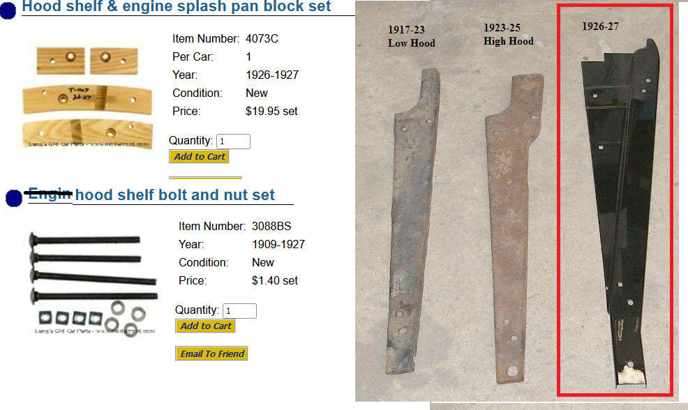

Next questions would be about the hood shelf and wood blocks. Then how the hood fit with the hood clips attached.

The bottom edge of the hood is not supposed to come all the way down to the hood shelf on either side. With the hood on the car and fitting the cowl and radiator shell reasonably well, and latched down, the hood sides will be about 5/8 to 3/4" above the hood shelves.

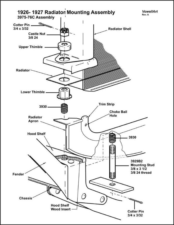

The radiator shell does not sit down flat on the frame or the hood shelves. It sits on springs a little higher than the hood shelf.

Since you have ensured that the frame is straight lets move on to the issue of getting it o fit when moving the hood left or right of center. The hood has to fit dead center so do you have a support bar from the firewall to the radiator and also these parts (hood rod clips) on the firewall & radiator that the hood hing bars rest in? This will keep it centered, The when the hood lips on the hood shelf are clipped are attached then the hodd should fir

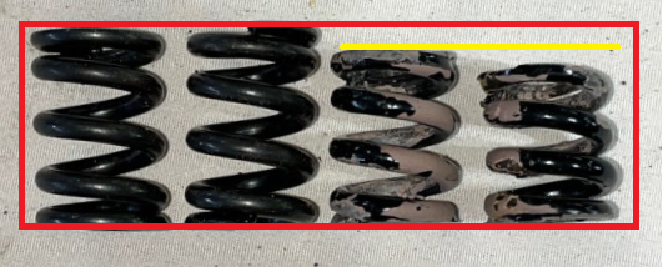

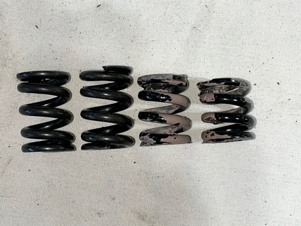

I looked at the November 8 and 9, 2019 posts, specifically the two from George N Lake Ozark and Mike Robinson. They pointed out that new springs were too long and stiff.
I am installing a new radiator on my 1927 coupe and found the same problem with my new springs (see attached photo). I have found two of the original springs. As a trial, I have put the old springs above the frame. Hopefully, I can find the other two original springs so I can use them inside the frame.
It is too bad that the suppliers don't provide springs that match the original.

I do have the support rod in from radiator to cowl also the hood hinge bars, hood does sit 1/2"to 3/4" above hood shelf, the radiator is sitting on the hood shelf with no hardware, I imagine the problem will only get worse when I put the radiator mounting hardware on, I do not have the engine in, waiting on a motor mount, I just wanted to see if the new frame fixed the problem, I just checked the frame and it is not bowed.
I wanted to make sure I wasn't missing something, I feel the radiator is to high, body is to low or I have a badly made reproduction hood, wish I had an original hood to try. I'll wait until the motor is in and I can get the radiator mounted and see were I'm at, I believe the problem will get worse, never thought about raising the body, will that mess with the steering column?

I think you are jumping the gun. You need to get the radiator properly mounted etc and then see how the hood fits. When I look at the pictures it appears that hood lines up vertically with the body, and if the hood was pulled & clamped down it would fit on the top and closed the gap on the hood shelf. In any case the hood needs to be clamped down in all 4 corners to see what the issues are (radiator attached properly too.

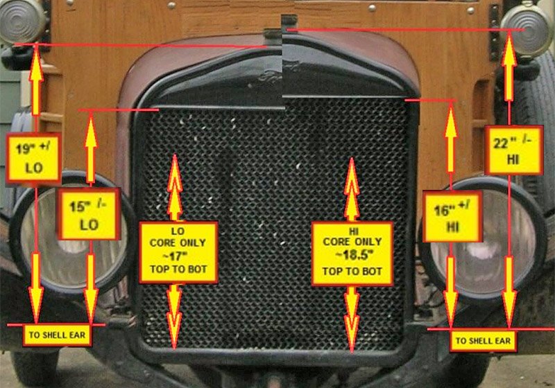

Make sure you have the right parts too. The radiator mounting kit is different for 26-27 too. I'd wait till you get the engine back in as well,
Remember that Model T parts were not expected to fit together as preciously as today's cars are, although we try.
Also you can expect a little fitting issue around the radiator shell. Both the high steel vs high nickle have slightly different profiles on the top and might make the hood fit look wrong but it isn't
Yes, it is, but suppliers sell what is available at spring manufacturers.
This is an Excellent example of the difference between restoring the entire car vs. simply throwing away or losing all of the original fasteners and expecting to just buy perfect equivalents off the shelf
Lee Spring offers 490 different possible springs for this type of configuration. Perhaps one off the shelf will fit: https://www.leespring.com/compression-springs-hefty
They will also custom-wind exactly what you want...just spec it out and buy a bunch of them to meet the minimum order. Order them here: https://www.leespring.com/custom-quote-request

But just comparing parts removed from a Model T to current reproductions isn't the same as comparing to original specifications. There is always a bit of uncertainty on some parts as being original after 100 years or potential repairs. Coil springs can weaken over time as well. Not saying this is the case but the two old springs are different heights and that can be due to a previous fix.

And yes I also bought new radiator mounting springs along with some screws in my 24 Coupe rebuild and wound up using the originals I luckily saved and boy was I glad I did !
The new ones were too long! I carefully cut off a little of it but chose to use the originals. I buffed them with a wire buffing wheel, painted them and all was good. The radiator fit and was aligned just fine.
