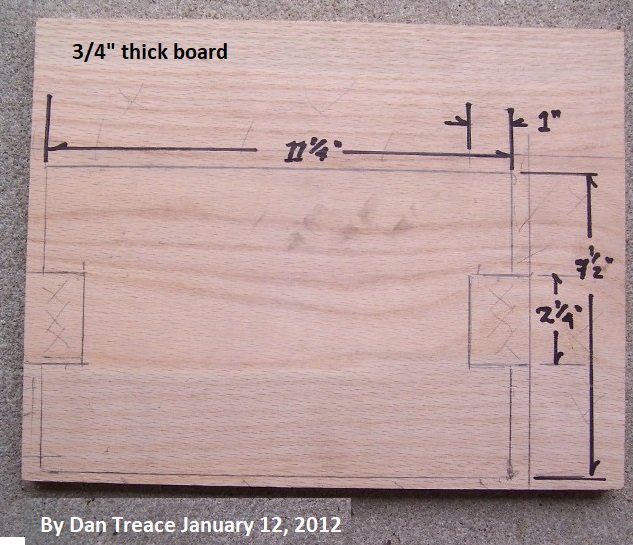

It is a piece the same size as the battery with a notch cut in each end for the metal strap that holds the battery.

Here is the "shim" for the underside. Also available from suppliers (maybe) . You should also shim it so it doesn't slide, just a boarder on the bottom board. The hold downs are just to hold the battery down. Thickness is what you need.
