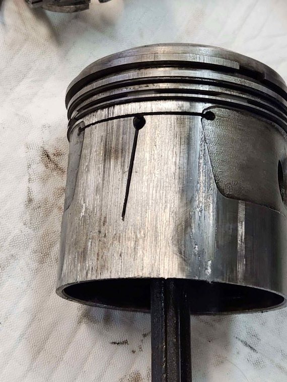

When the car runs and finally stops, is it overheating? You would know this if when you turn off the engine it gurgles and emits steam. If it is overheating, your piston could be expanding to the point it seizes. Could be all you need is some work on the cooling system. The knock could be anything between a loose piston to wrist pin or connecting rod. It could even be a main bearing knocking or camshaft. So, see if you can find someone in your local area who is familiar with Model T's who can help you assess the cause of your knock and stalling. Usually when an engine overheats and stalls, it will not turn over until it cools off then it will turn over and start after it cools. Overheating to the point of seizing many times will eventually lead to need for complete rebuild.
Sometimes when the engine has been overheated the pistons will "collapse". and make them loose, then when it overheats they will expand and cause it to stall. This can also cause excessive oil burning and if it runs too low on oil, will also cause damage. So I suspect the engine might need complete rebuild.

This was my first thought also, but "barn find" doesnt lead me to aluminum pistons. I does lead me to a lack of oil.Adam wrote: ↑Tue Mar 28, 2023 9:38 amMartin, Does your engine have aluminum pistons? What you are describing fits the diagnosis of a piston pin seizing in an aluminum piston. Usually the pin stays pretty tight when the engine cools. To the point that it’s real hard to turn. It’s unusual that the engine would be totally free again when fully cooled. The pin usually galls and has to be pressed out of the piston. If your issue is a sticky wrist pin, sometimes all you have to do is pull your pistons & take them to an automotive machine shop to have the pin bores properly fit (honed). This is actually a pretty common issue because most hobbyists rebuilding their T engines don’t realize the aluminum pistons pin bores usually always require a little additional line honing to bring the bores into line and enlarge them a bit.
Plugged internal oil line. @ the least, I would pull the inspection cover to confirm pistons & dry evidence. Check damage to the rods.(loose)

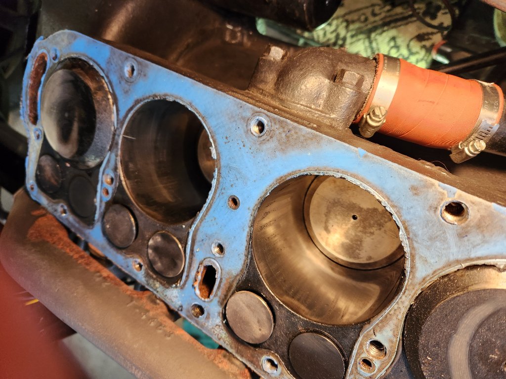

Greetings all -
Here is today's update:
Today I pulled the head, oil pan, valve cover and trans inspection plate. To my total amazement it all looks great as if it had been recently overhauled. The cylinders are Aluminum and the cylinder walls are smooth with no marks whatsoever-
There was no metal at all in the oil or the pan and the inside of the bottom crankcase looks pristine and clean -
The side cam guides, etc are all smooth with no real signs of wear. ( some heavy black carbon on valves.=.. mixture? )
Given it started and ran well (Except for the knocking) and there was no blue smoke at all - I'm going to say the top side and valves appear to all be good- - BUT - I still need to somehow inspect the piston wrist pins - which was suggested as a possibility --- Its not clear how that might cause the knocking that leads to a slow down - without scoring the side walls - but this is uncharted territory and who knows- I'm just not that eager to pull the pistons until I've gone down a few other paths ---
For the bottom end bearings;
No apparent slop in any of the bearings -
For now - I only pulled the number 2 rod bearing - I noted the number 2 rod bearing cap had only partial threads on one bolt and full threads on the other- Reaching over the top - the bolt holding the splash part was twisted and not set properly. ... it was torqued down tightly though-
When I pulled the rod cap - which was babbitted... the crank and babbitt were perfectly smooth with no burns, burrs, or scoring. everything looks almost new -
The front timing gears also look good - no chipped / worn teeth - and as far as I could see at least- the camshaft looked ok
(Hmmm... cam shaft bearings???)
On the transmission top cover removal - nothing looked loose or out of place - as far as I could tell -
so... what's next? flywheel, magneto, transmission?? I'm assuming I need to pull the hogshead to get to that?
I do have a Delco distributor - and I don't know if the flywheel still has the magnets- I'm thinking it might just to keep things in balance when it was overhauled -
other side notes: on the suggestion of a frozen clutch - it was apparently free turning free throughout the test loop - and I'm thinking the clutch wouldn't knock (???)
and last side note:
In my haste to see the rod bearing I didn't notice front vs. back - (Damn me!) There were 3 shims on both sides - and the bearing cap does have a no. 2 stamped on one side. Any other ways of knowing front to back?
Thanks again
Marty

If there is NO scoring or aluminum deposited, we rule out seizing pistons. Use a mirror & check em all well. Only takes one piston.
If the wrist pins are too tight, you should see heat discoloration on the wrist pin bosses. Look @ all 8.
When you removed the rod cap, did you move the crank out of the way & check for a free swinging rod?
The knocking increasing & stopping the motor still points to a piston issue to me.
I would not be in a hurry to disassemble without finding the expected cause thru the inspection cover.

In your second picture, one of the bolts is broken off or sawed off right where the cotter pin goes through. I wonder whether that bolt was hitting something and was sawed or broken off? Another thing to check since you have the head off is whether the piston tops might be hitting the head or the gasket. If the cylinder was bored out over about 60 thousandths, it could hit the head. Some heads are different from others.
Topic author - Posts: 109

Hi Norm - That is an interesting thought - The piston does seem exceptionally proud of the top of the block surface with the head off- but no signs of any sort of damage to either the pistons or the dead -Norman Kling wrote: ↑Tue Mar 28, 2023 6:03 pmIn your second picture, one of the bolts is broken off or sawed off right where the cotter pin goes through. I wonder whether that bolt was hitting something and was sawed or broken off? Another thing to check since you have the head off is whether the piston tops might be hitting the head or the gasket. If the cylinder was bored out over about 60 thousandths, it could hit the head. Some heads are different from others.
also
no cotter pins at all on any of the nuts -

I think I may have found the culprit - The attached image is of No. 1 piston - Its scored and the bottom of the cylinder is also scored -
the wrist pin slides very easily - with lots of play- No. 2,3,and 4 pistons are not that bad... and those pistons and cylinders have no scoring or discoloration.

Could be much worse. Pistons are cheap, as things go these days. The blue goop and improper rod bearing fit and compromised rod cap bolt indicate a need for further investigation.
- Posts: 4961
Re: knocking engine
Check that internal oil line. (it looks like a piece of copper tubing in a picture). I wonder whats going on with that.
# 1 rod & piston are the first to fail under a lack of oil.
Part of the why or one bore too tight?

you nailed it - Took it to Dave Rich in Forestville yesterday (excellent T machinist!) - The scupper from the hogs head was clogged with a piece of material from the brakes- and no. 1,3 and 4 wrist pins were loose- No. 2 wrist pin was very tight- The theory has it that Aluminum piston expands the wrist pin hole and the wrist pins begin to knock - I've heard a few people now comment that they had wrist pin failure. Seems the original cast iron pistons were better than the Aluminum -speedytinc wrote: ↑Wed Mar 29, 2023 6:27 pmCheck that internal oil line. (it looks like a piece of copper tubing in a picture). I wonder whats going on with that.
I live in the hills and a friend recommended a Texas T auxiliary oiler to the front of the engine -
I learn something new every day- too bad I'm starting to forget TWO things every day also...
