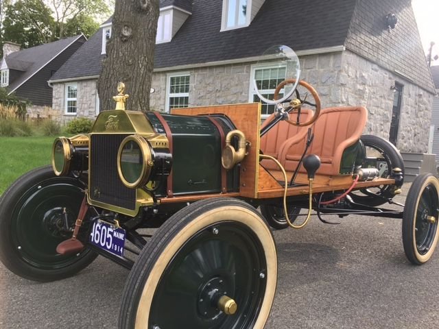

Post by Quickm007 » Thu Mar 30, 2023 9:38 am
