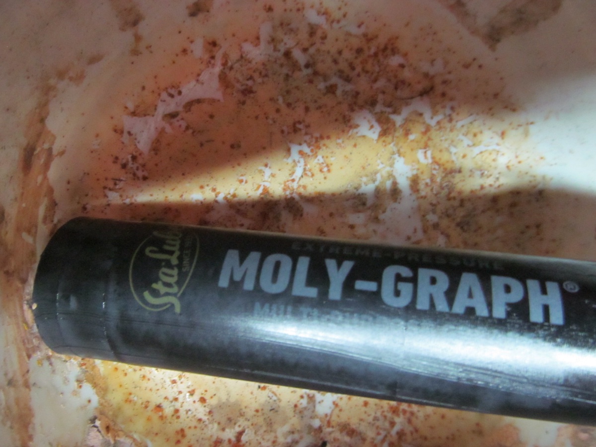

Fairly safe your motor oil choices wouldn't have graphite.
But beware of greases, esp. if you use graphite containing greases in the u-joint. Could get mixed with the engine oil, maybe such small qty. that wouldn't hurt the magneto, but why chance?
