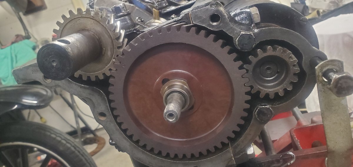

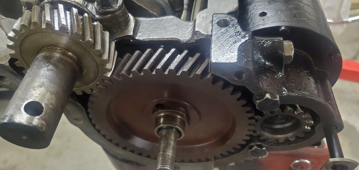

Generator gear lash
I am dry fitting this side cover and generator to check out the generator gear lash with the timing gear. I have one gasket in there measuring .010" thick. This crank, cam and generator gears were all meshed together in a running engine when it was torn down. I'm keeping this fiber timing gear as it was in good shape and a new camshaft can't be had anyway. None available. How does one tell looking at the gears whether that generator gear fit with the timing gear will be happy or not?

There should be a little wiggle between The gen & cam gear. The "gasket" is not, its a shim. Add more if necessary.
Check @ all points around the gear, not just one point.

Re: Generator gear lash
I see 2 No-No's in your photo, first the fiber gear and those brass oil pick up's on the big ends.
I’ve been running fiber cam gears for close to 50 years in multiple engines. The key factor is good gear mesh. They must Not bind. Probably about.002-.005 clearance is good. The same applies to the generator gear
Frank, this fiber gear and copper oil dippers have been in this engine for many miles. The gear isn't worn or chipped and the dippers are tight. This engine had original cast pistons in it but they were knurled once and worn. So it got a new field coil, magnets charged, and bored to .40" over with new pistons and rings and 4 intake valves. I'm just looking for a good fit on the generator gear since I didn't mic the gasket shim that was in there on tear down. I would have liked to put a new cam with a new gear. No cams. Kind of a sad thing in the T hobby right now. Why should a guy tear that fiber gear off a used cam. I have those fiber gears in my A's, yes I know they aren't driving a gear generator. Any other thoughts or ideas on fit. My machine shop said my cam he'd have no problem reusing.

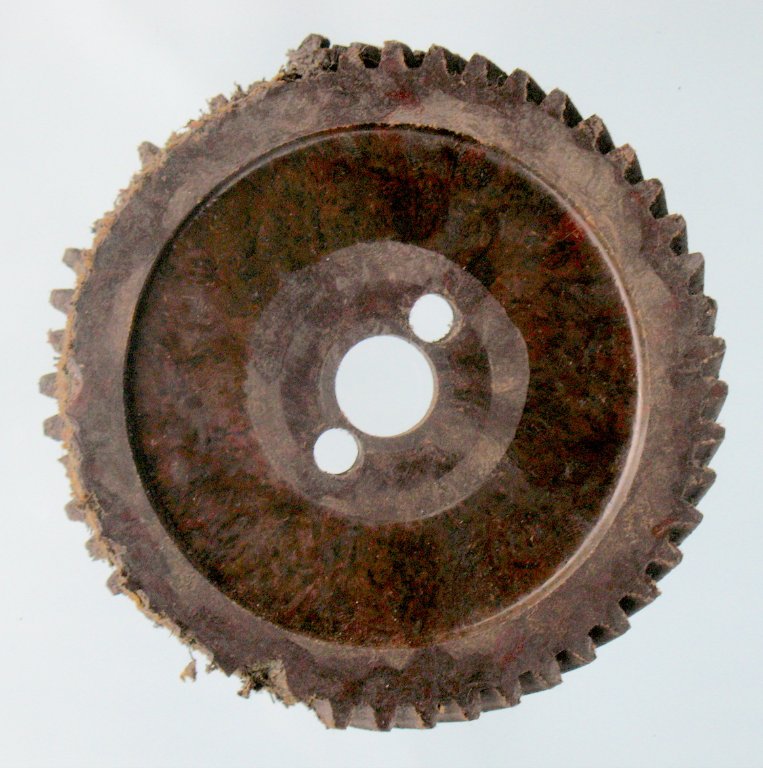

- Posts: 7139
There are fibre gears and then there are fibre gears. The one Steve's photo shows is the usual type to fail. It is made of chopped fibre and some kind of binder.
The one in your engine is not one of those and may be quite adequate.
One thing often overlooked when checking generator gear backlash is that the generator bracket must be mounted parallel to the front cylinder cover surface of the block. The generator bracket is a sloppy fit if you rely only on the bolts. Mount the cylinder cover on the block and then mount the generator bracket, using the cylinder cover as an alignment plate, then remove the cylinder cover and check the gear mesh.

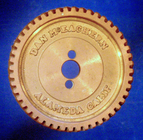

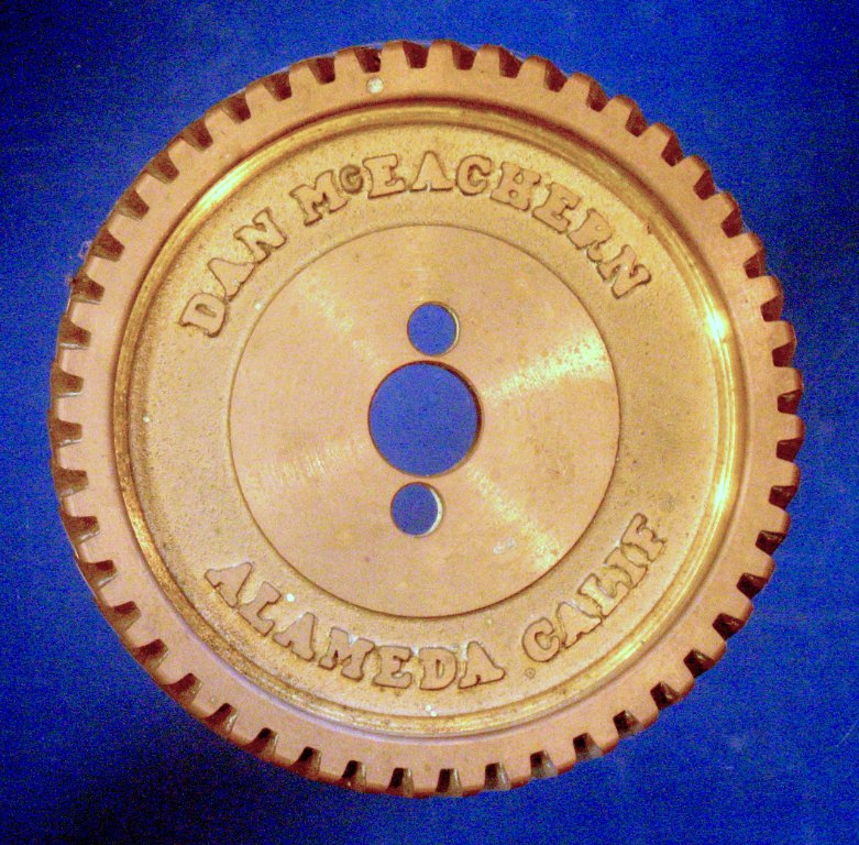

- Posts: 5146
IMO Your best timing gear is one manufactured by Dan McEachern. That would be bronze. The bronze gear has the least expansion when hot, so it can have less gear lash which equals quietest.

- Posts: 4394
If you're replacing the timing gear, you should also replace the generator gear. In your one photo it appears well worn. Running a worn generator gear against a new timing gear will make for a noisy mesh.
