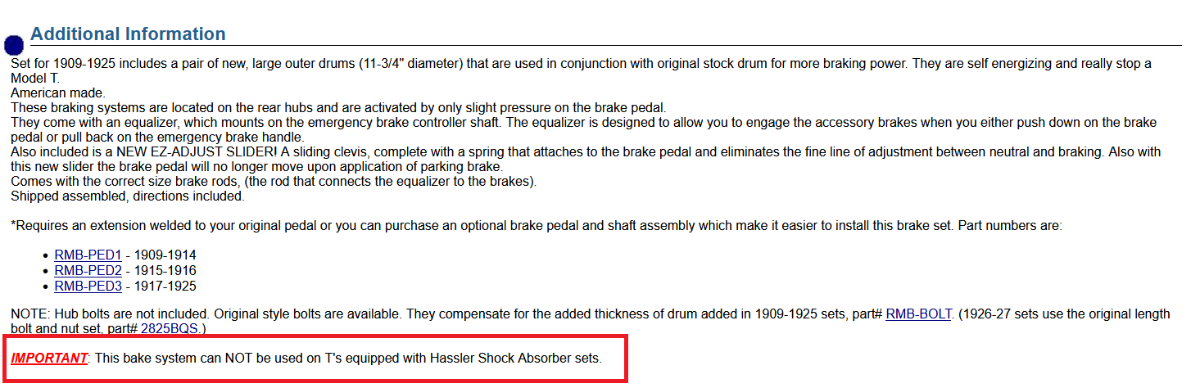

My 22 has front hasslers but no rears. It has Rocky Mountain brakes. Before I start searching for a pair of rear hasslers, can I run Rocky Mountains and rear hasslers at the same time? From what I see, it looks like the Hassler mount would interfere with the Rocky Mountain drum.
Posts: 6541
Re: Are rear hasslers and Rocky Mountain brake’s compatible?
Post by TRDxB2 » Sun Apr 02, 2023 2:14 am
Reno Speedster wrote:
Sun Apr 02, 2023 1:30 am

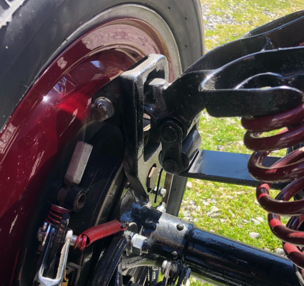

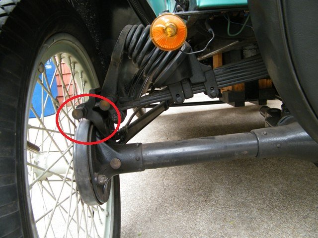

NO. The problem is that the Hassler arm extends over the brake drum. No room for Rockies beehive or pancake.

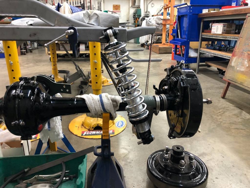

Only if you have a machine shop at your house and all your chores are done! "Nothing is impossible if it can be imagined".., N. Tesla

As a mater of fact, I do have a machine shop in my home, but my chores are definitely not done! Do you have drawings for those?

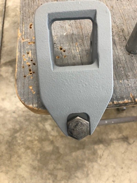

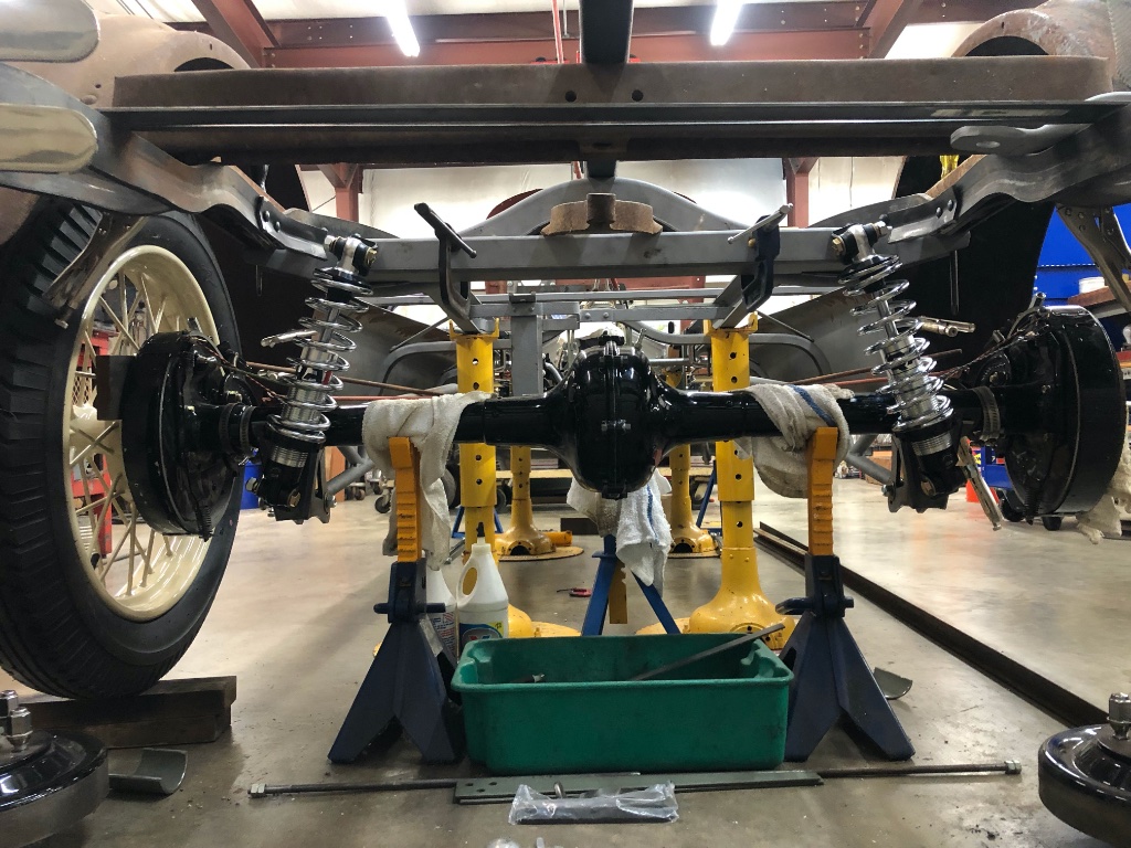

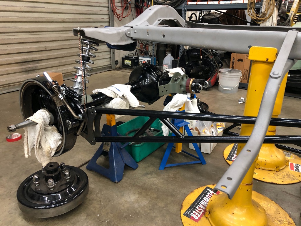

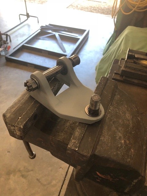

I was going t mention that I was fortunate to have Hank make me a set. Then when someone else was looking for a pair, I decided to give mine up and Hank was happy not to have to make another pair. I regret having done that. Anyway some pictures of the perch mad for large drum. They are not cast!
