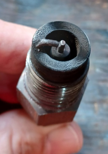

Keith..at least to me, many others may have differing opinions, but this plug I think shows I got my carb on my '13 set up pretty good. #1 plug, the one that will carbon up more than the following three. The rest on this car are even cleaner. This plug has around 10,000 miles on it, and is showing some electrode wear.

That really looks good. My plugs were dark, looked like it had been running rich before. I know I've had it all over the board trying to figure out how to tweak the fuel mixture, which seems to change a bunch as it warms up. I haven't taken the carb off yet, just took the bowl off before the first start to make sure it was clean and pulled the filter out of the sediment bowl on the valve, both clean as a whistle. Pulled the bowl off again after the first start, still clean.TWrenn wrote: ↑Fri Mar 31, 2023 10:32 amKeith..at least to me, many others may have differing opinions, but this plug I think shows I got my carb on my '13 set up pretty good. #1 plug, the one that will carbon up more than the following three. The rest on this car are even cleaner. This plug has around 10,000 miles on it, and is showing some electrode wear.
I haven't put the coils on a meter yet, they are all KW coils that look brand new, so clean you can read the manufacture dates on the boxes. They look like they were all rebuilt at the same time, and recently.
The oil was sooty like I get out of my diesel, I'm guessing that's typical on a T? What I didn't like was the oil was pretty thick, I let it drip out all night. I'll warm it up a couple more times then drain the oil again, I plan to pull the timer off and clean it at that time.

Hey Keith...well first, just because those coils are new, don't assume they're actually "spot on" regarding their tuning. Have 'em checked on some sort of tester, be it an HCCT or an ECCT, either way, check em out. You may be surprised. I've heard more than one tale of brand new out of the vendor box that they were way off. Just saying. As for your oil, well, the only thing I can hypothesize (man thats a big word for me this early in the morning!) is that whomever had the T prior to you wasn't very diligent about changing oil. Too bad, so sad. I change mine when it STARTS TO GET DIRTY, never minding a whole lot about miles...my '13 can literally go 900 miles and the oil is barely brown, but I change it then. The '25 which really isn't fully broke in yet, gets dirty right about 500, so there ya have it. I always put a little on my finger when I check the oil level when I know it's at least approaching 500 miles to see just how "opaque brown" it is getting. Oil is a lot cheaper than an engine rebuild as we all know. You may want to give the engine a good "flushing" per the black bible before you go putting new oil in it. Just my anal OCD opinion. You're on the track too re the timer. They do get dirty and tell you when it's time, especially the carbon brush variety.
