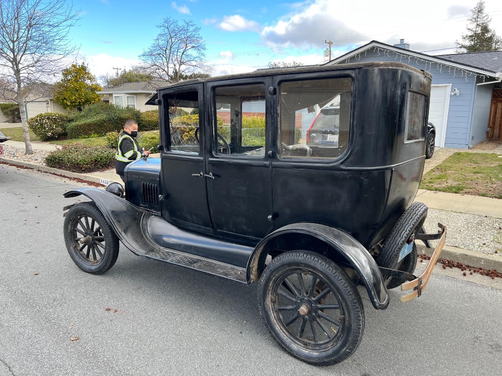

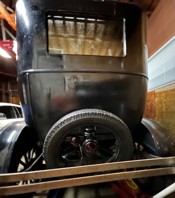

Oil Side & Tail Lamps on 24 Fordor
I just bought some nice vintage kerosene oil side lamps that I’m considering installing on my 24 Fordor. Is there a set of brackets I can buy to mount these to the cowl or windshield frame somehow? I’m hesitant to drill holes in the car, but would love the look of the side lamps on my closed car. I also purchased an oil tail lamp from the same seller and would like to install on the back of the car while also retaining the original battery light. Or perhaps replace the original battery lamp with the oil lamp and run wiring and a lamp socket into the oil lamp. Would love to see what other T owners have done.
I know these lamps aren’t correct for the car, but I’m interested in installing them and only if they can be done right and without too much trouble. If anyone has any ideas or the right mounts/brackets for sale, let me know. I’d prefer not to have to fabricate parts.
Any guidance would be appreciated. If it’s not possible to mount these, then I’ll just keep the lamps as collectibles or sell them to someone else with an older T who can use them.

You will need to drill 4 holes clear through the bodywork to bolt the mounting brackets, not something I would contemplate on a nice original car.The tail light could be mounted on a bracket fixed to the underside of the body. That would be far less damaging.

Its your car. If you want to mount the lamps, do it. Personally, I think the cowl lamps define a T. Do take the time to research the location as closely as possible before you drill. Find proper hardware as well. The inside nuts are hidden from outside view and less of a concern. On my TT, I added cowl lamps using modern carriage bolts with the head markings turned off and then painted flat black.

There is no side lamp bracket that will fit your car and work without modification to the bracket and the car. Tail lamp should be a direct replacement for your electric lamp.

Thanks for the input guys, I appreciate it. I’ll think it over some more and probably won’t mount the cowl lamps if it involves drilling the body. I do like the idea of replacing the single circular tail lamp with the oil lamp, though. I’ll play around with ideas as soon as the lamps arrive and follow up with pictures if and when I end up installing them.

I got the rear oil lamp installed and dig the look! Only issue now is I need to find a place for the license plate. I’m planning to buy a set of California 1924 YOM plates and might just stick the plate inside the lower edge of the rear window. Will post an update on the side cowl lamps if and when I get them installed
