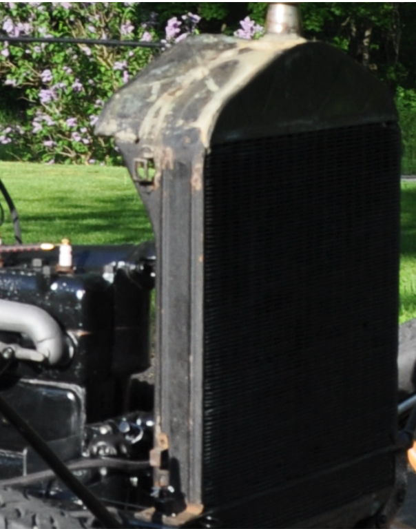

Ears and screws? Is your car a 1926/'27?

Wayne,
Based on his profile he as a 1924 touring, and I have a late 23 touring, model year 1924. My original radiator had little "ears" on the right and left side of the radiator core, and the radiator shell was attached to the vertical sides of the radiator via one screw on each side. The hood welt then covered the screw. I presume these are the ears he is talking about, as they came separate on my round tube brassworks radiator.

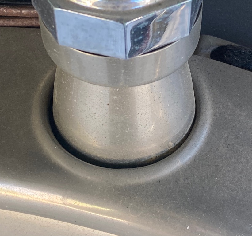

Another thing I noticed was it appeared that the radiator neck was right up against the shell, but I suppose that is because I don’t have the sides fastened to those ears yet.
- Posts: 7143
Re: New radiator from Brass Works
It is not unusual for the neck to be out of line. It can be shifted and be re-soldered in the correct place. Use your shell as a guide.

The radiator has to be correctly attached to the frame mounting points with the correct hardware and the stay rod must be correctly adjusted to prevent problems. It is important that the frame crossmember not be distorted. The mounting bolts must not be overtightened. Hoses should not be very old and stiff.

Ears? My Bergs (or original 17 radiator for that matter) did not have the ears you're talking about. The radiator attaches to the frame and the rod from the firewall. The shroud slips over the neck and attaches only to the frame.

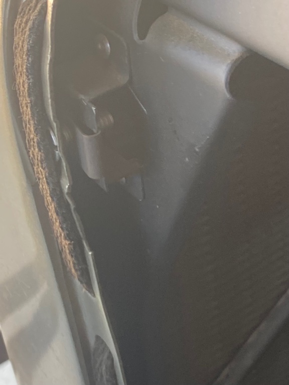

Harvey - as mentioned above, the Brassworks radiator for my ‘26 came with the small bag with the ears, rivets and radiator petcock. The ears will help you adjust the radiator shell and the neck. I used my old radiator and ears as a starting point to measure placement for riveting the ears on the new one.

I am looking for a pair of the shell mounting ears (just the brackets, not an entire radiator), and called Brassworks a month or two ago.
They told me they are out of them. Perhaps they are reserving what they have to be included with new radiators, or maybe they are completely out and can't provide them at all, but they wouldn't sell me any.
They used to sell pairs of brackets with all hardware for $9.99 on their website, but now the kit does not come up in their product listings, although you can still find it thru google searching.
My car has what I think is a Brassworks radiator installed several years ago, the brackets are missing. I am pretty sure the radiator passed thru a couple of different owners before it found its way onto my car so in all likelihood was not a vendor issue. I may just need to get the measurements off of somebody else's car and make new ones.

My Berg’s rad from 2009 had ears for attaching the shroud.

1917 has the short radiator, no ears is correct. The tall radiator (1924?-1927) has the ears.Will_Vanderburg wrote: ↑Fri Jan 27, 2023 3:10 pm
The tall radiator must be a bit more top-heavy, they added extra brackets so the radiator wouldn't work fore-aft against the shroud and fracture the neck.

Show me a Model T or Model A where something fits right. I think, just like people, they sag with age. NOS doesn’t fit half the time either. You need to have some skills and adapt. Usually the radiator doesn’t fit because the frame is spread or twisted or anything and everything 100 years brings.
- Posts: 4631
Tx goat makes a “common sense” observation about how uniform T radiators and for that matter the rest of the cars and parts actually were.
The idea that all of the parts and cars were exactly alike are really “0ver thinking” how it really was. Some folks keep seeing the forest instead of the individual trees.
- Posts: 7143
I can fully understand that the hurly burly of the production line would have resulted in some really poor fit of parts of varying precision. However, when a part was so out of spec that it could not be fitted at all, I am sure an alternative was found. Such parts may have been re-jigged for recovery or just discarded. A radiator shell may have been discarded, a radiator assembly more likely re-jigged which is what I had to do.

Check the box and packing your radiator came in. My Brassworks radiator came with those two shell securement brackets separate from the radiator. I guess they come separately in case you have an aftermarket shell that does not line up with the normal location of the brackets, you can mount them where you want. Jim Patrick

I just installed my 26-27 high style brass works radiator and don’t have the mounts either, I didn’t see anything in the box or packaging, do you know where you found them in the box? As luck would have it I just threw out the box and foam today. Just my luck!Harvey Bergstrom wrote: ↑Tue Jan 31, 2023 8:39 pmIn response to John Kuehn’s post about coming on the forum with a problem with my new radiator missing the top mounting ears for the shell, I have an apology in order.
You are right. I should have contacted Brass Works first before I came on the forum with my complaint. I am truly sorry if I offended anyone. Turns out, I misplaced the brackets with the screws which I need and found them today. I think I will have to take my radiator to a shop and have the neck moved ahead a little but that is no big deal. I would imagine the shell cannot rub the tank anywhere lest a hole gets worn in the tank and starts a leak. Again please accept my apology. I greatly appreciate all of the help with any questions I have and the great ideas that I can learn for this fun hobby of Model T’s.
