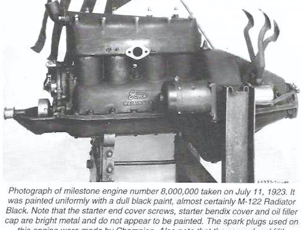

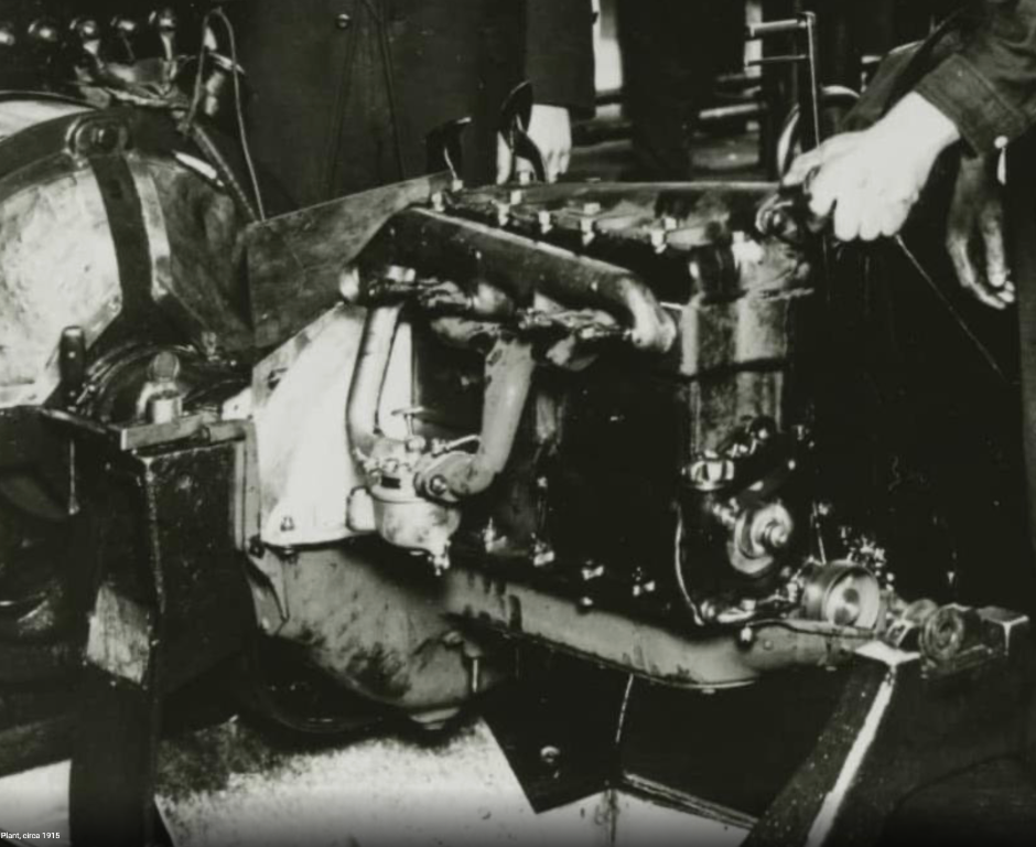

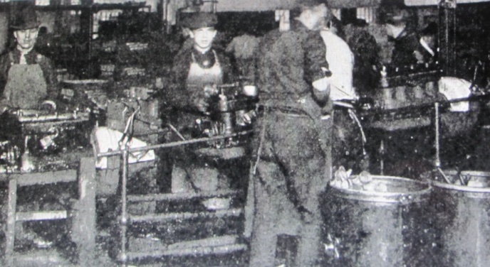

Photographic records c.1914 show the engine iron block being given a black 'wash', M-142, thin coating, (the cylinder head appears already painted at the time of the block painting in this photo), the steel crankcase appears grey without the black wash. The alum. hogshead is as cast.
Engines assembled on the high rail line, note one on right is about to be painted on its upper parts.
Early engine installed, note the alum. hogshead.
Later engines c.1923 were black thin wash all over. A similar look can be made by using modern satin black engine paint.

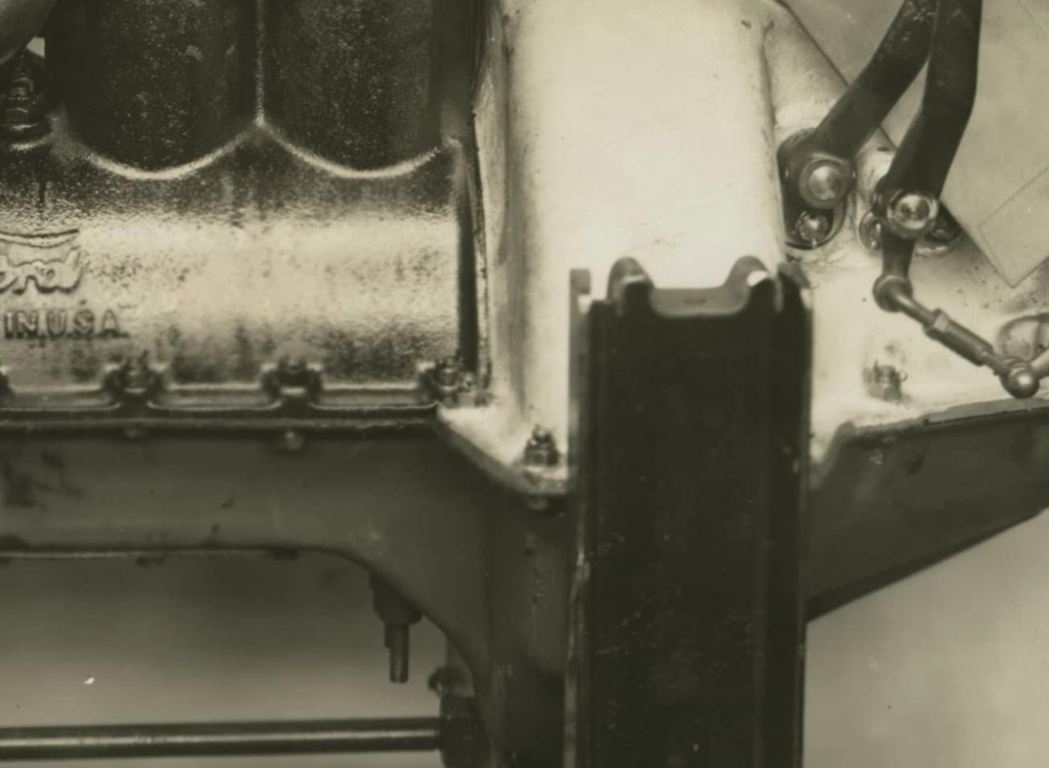

Re: Engine blocks
Early crankcases were also unpainted. Some show finger marks from men handling the painted engine block.
It's interesting the exhaust manifold was painted with such, but the intake was not - maybe to keep slush from the carb, or in advance of the carb and intake manifold installation?

like the hog's head, the intake was aluminum
