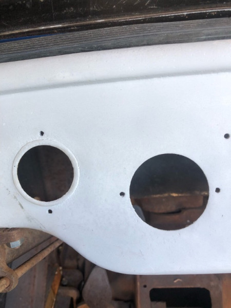

I’m building a speedster and have an Overland Model 91 body. I’m going to put the T switch in the switch that fits the body. The hole in the dash measures 1 5/8”, the hole on the switch plate that I have is about the same but before I order one I wanted to confirm it would fit in the hole. I can figure out some way to mount it as long as it’s the right size.

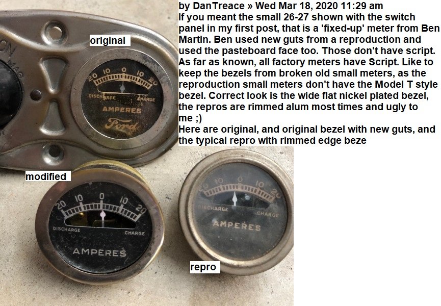

The small ammeter is 1-5/8" & large is 2-1/4". T's were 20-20 amp scale. 30-30 will work too

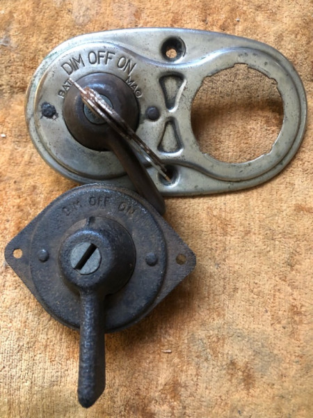

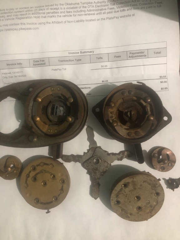

Thanks for the replies. The switches are the same but the tumblers are different and none of the Gord keys fit so I’ll just remove the rivets and swap everything.

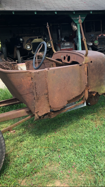

I had a T chassis that I used the motor from for another car then I picked up what was left of an Overland touring car for $100, which was the front half of the body, frame and radiator shell. I got a motor at Chickasha a few years ago but I’m getting closer to finishing.
I know now that a Ford gauge will work. I used the Overland front end and steering box so I think I’ll use the Overland column. I had shortened and fitted a Ford column (not the one in the picture) but I think I’ll use the original one since I’ve got a couple T columns to look at already while driving. As long as I can make the spark and gas rods work from the Overland column to the T motor.

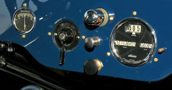

Corey, that bottom black switch takes a larger key that looks like the Model T key with grooves on both sides and is very difficult and expensive to find or buy.
They were used on a few more expensive vehicles, seems like Dodge was one.

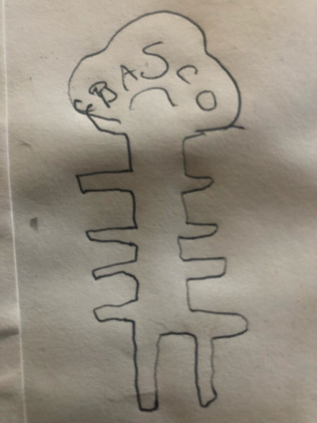

I had a switch like it once before that had a key that looked like my crude drawing. It was a Briggs and Stratton key. I don’t know if it was correct but it worked. I bought the switch and then found the key in a basket of keys at a flea market, then I sold them and and am starting over but before I was working on an Overland but this time I’ve got to make a switch that switches from mag to battery.

The Dodge Brothers Clum Key for sale in the classified parts is the type that the lower black ignition switch needs.
The DB on the key is for dodge Brothers.
The key has a number and the switch cylinder should have a number, like the Model T keys.

This ammeter should do the trick for you. It is the same size and Model A, which is the same size as Model T. https://www.westach.com/product-page/copy-of-1-5-20a

While that ammeter is the correct size the 30-30 amp range is for a Model A & others. But it will work & has lighting - could be a very good option.John.Zibell wrote: ↑Mon Apr 17, 2023 9:34 amThis ammeter should do the trick for you. It is the same size and Model A, which is the same size as Model T. https://www.westach.com/product-page/copy-of-1-5-20a
Model T 20-20 amp range and the pointer was behind the scale. The inside of the case would appear black behind the pointer --
There are many others that will fit the opening and have the clips on the rime to hold them in place. Tractor supply places have them too. Positive or Negative ground does not matter https://www.google.com/search?q=20-0-20 ... 9&dpr=1.33

There are a lot of the BASCO keys like shown on eBay. I have a switch that should take one, just never have gotten around to getting one.

The problem with the cheap ammeters the vendors sell is that they are not accurate. It is the adage you get what you pay for.TRDxB2 wrote: ↑Mon Apr 17, 2023 1:11 pmWhile that ammeter is the correct size the 30-30 amp range is for a Model A & others. But it will work & has lighting - could be a very good option.John.Zibell wrote: ↑Mon Apr 17, 2023 9:34 amThis ammeter should do the trick for you. It is the same size and Model A, which is the same size as Model T. https://www.westach.com/product-page/copy-of-1-5-20a
