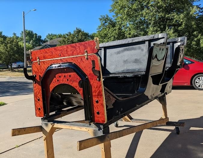

Re: 1911 firewall suppliers
I got mine from Snyder's when I was restoring our 11 touring. I believe that they may make them. It was nice workmanship and a reasonable price.
Based on prior suggestions on the forum site, I used Laurel Mountain Forge cherry stain that you can buy from the link below. My car had the original firewall (that was falling apart) that I replaced during the restoration, and this stain matches well the original stain found on areas that had been covered on the firewall. I also used multiple applications of hand rubbed "tung oil" equivalent to seal the wood.
https://www.trackofthewolf.com/Categori ... MF-STAIN-C
Off topic, I looked at the photo and wondered if your car had a radio antennae! It's just a lamp pole lined up with the side lamp bracket.
- Posts: 497
- First Name: Neal
- Last Name: Willford
- * REQUIRED* Type and Year of Model Ts owned: 1911 Touring, 1929 Model A Tudor
- Location: Kansas
Yes, it was on of those rare aftermarket accessories for the Model T! The lamp does provide some good light while driving in the dark.
- Posts: 3743
- Last Name: Wrenn
Neil...LMAO!! Try that pic like that again and it'll never work!
