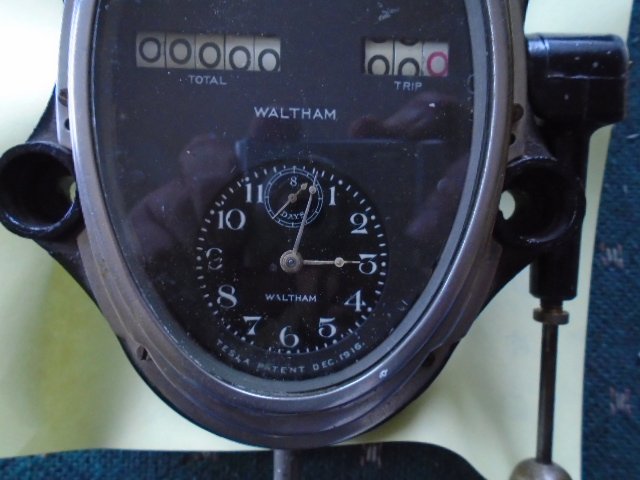

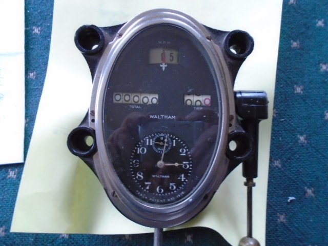

I have an early 1916 speedometer, autometer and clock with a 3 didget trip meter designed by Tesla. This assembly was in an early Packard. The clock is an 8-day Waltham and keeps very accurate time.
