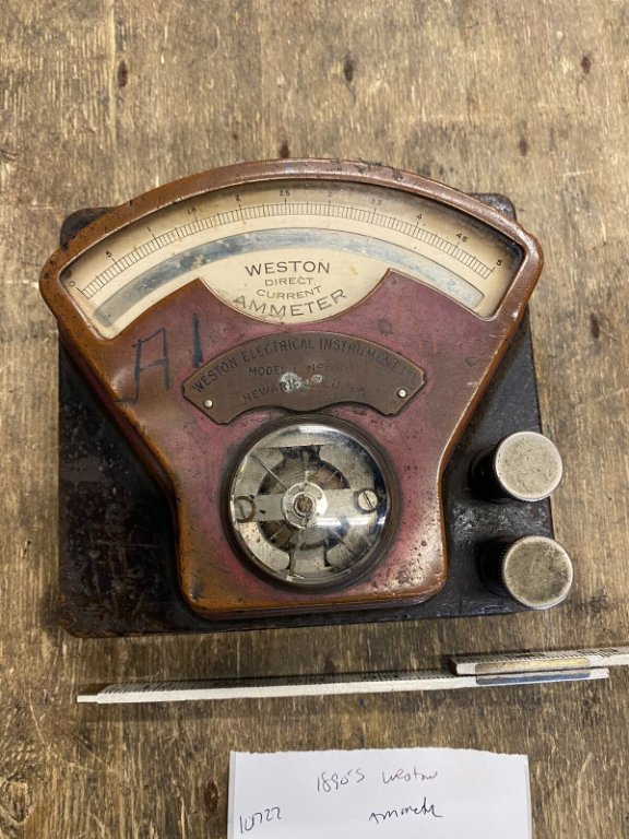

John,JohnH wrote: ↑Sun Apr 23, 2023 5:45 pmExactly why a HCCT was pointless.Scott_Conger wrote: ↑Sun Apr 23, 2023 3:17 pmSince early coils had absolutely no control over double sparking, there really wasn't a need to make the HCCT adaptable to earlier coils.
I've occasionally pondered over possible differing response characteristics of early moving coil meters when operated outside of their intended parameters.
It would be interesting to know whether there is, in fact, much disparity; as I suspect you may have a good collection of such things I wonder if you've ever conducted any tests? One could simply use a coil to conduct such a test of course, but more accurately perhaps a simple 555 with FET switch, set to the typical operating frequency of a coil would be best?
It might also be interesting to test a Heinz (or any other 'different' coil) to see if these altered the meter response over a 'standard' coil.
Obviously this is of little practical use today, given how much more accurately we can measure/test such things, however if one was at a loose end on a rainy Sunday afternoon...
Luke.
JohnH
- Posts: 377
- Last Name: Hunter
- Board Member Since: 2002
Re: Adjusting a trembler coil before 1908
Luke, I've wondered that with the meters that have been used in various buzz box testers. Given the atrocious current waveform, one wonders if each type of meter will read the same with one particular coil.
The closest to exploring this I got was back in the days of pre-electronic testing, when I did use buzz boxes. Given that the HCCT was AC with a moving iron meter, I was curious to see if a coil set on 50 cycle AC with a moving iron meter would give the same result as a DC buzz box, with a moving coil meter.
The answer is that it didn't, and there was about a 200mA discrepency. I can't remember now which instrument measured higher, but it was obvious that the 1.3A DC setting for buzz boxes did not exactly correspond to the 1.3A from a HCCT.

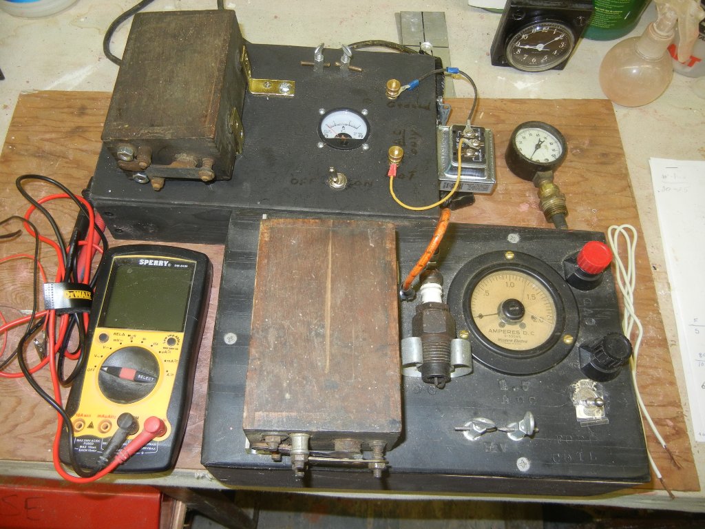

My two test units, for me, give a correct indication of current draw for coil setting and adjustment, either AC or DC. The AC unit has a step down transformer of 8, 16, 24 volts AC at 10 amps (top left). The DC unit relays on a 6/8 volt battery for voltage and current.
The Sperry meter is for testing the capacitor. And the analogue gauge (upper right) for compression.
