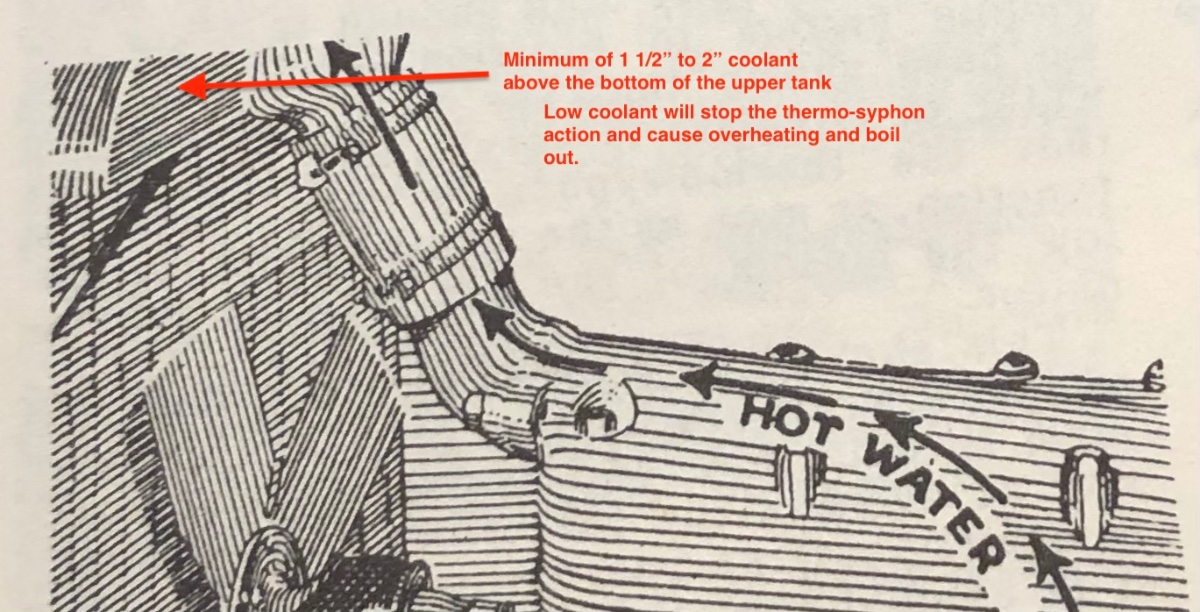

If your cooling is good when running, then the fan is circulating, even at low engine speed rpm's when moving slowly. Just don't have the spark retarded, and press on and off low pedal with the clutch lever up, so you don't engage high, bump someone, or stall out at low rpms.
A rise in temp is normal for long idle. The motor will be ok over 200 degrees, but if you have steam, that is a different story. Steam can arise if the coolant level is too low for the thermosyphon to work. Low coolant won't spill up and into the radiator upper tank to fall down and cool, it will stay in the block and just get hotter, and will boil and steam. Just be sure your coolant level is proper.

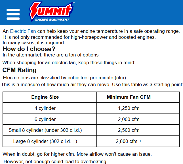

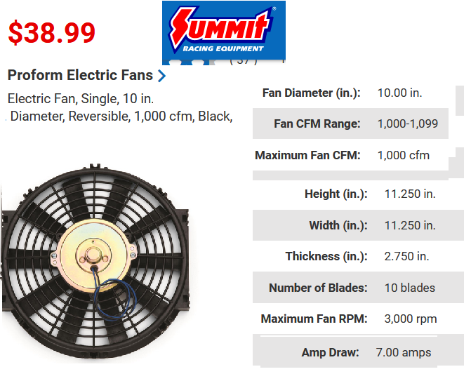

The reason Model Ts tend to run hot in situations like slow, stop-and-start parades or sitting in drive through lines in hot weather is lack of enough airflow thorough the radiator and over the engine in such situations. The Model T fan is not very efficient.
If your T has a good radiator and clean cooling system and you use the best settings for timing and throttle and the best technique for using the transmission, you may still have issues.
The best solution would be to increase the airflow through the radiator when standing still or moving very slowly, especially if you have a tailwind. A parade-only fan with a smaller than stock pulley would help.
Running the engine at a faster idle, maybe 900 RPM, to speed up the fan would probably help. Keeping the timing well advanced can help. 50/50 green anti-freeze will raise the coolant boiling point.
At the very least, be sure you are using the best driving technique and be sure your fan belt is properly tightened and your radiator is full. One way to maximize the radiator level is to run the car up to operating temperature, then fill the radiator to the top.
A coolant expansion tank can add a few extra square inches of cooling surface by keeping the radiator completely full at all times. A full radiator will assure maximum thermosyphon efficiency, too. The overflow tank would have to have a bottom inlet and be vented to the atmosphere with a vent at least as large as the overflow tube on the radiator. It would have to be large enough to accommodate normal coolant expansion. The radiator cap would have to have an air-tight gasket.
A metal lower water outlet connection instead of a rubber hose will help get rid of heat. ANYTHING that restricts airflow through the radiator core should be removed.

There are 2 problems to solve. The power source and enough airflow
Computer fans (6v or 12v) max out at 200CFM. doesn't mater how many you use its still only pulling 200CFM
Not sure iwhy you are set on 6volts you didn't indicate that. If you were to rely on the Model T generator then that's unregulated voltage , unless you have a VR, and could damage a 6V but might work a 12v computer fan. But only 200CFM don't think that's enough
The 12V Speedway Universal Electric Radiator Cooling Fan, 10 Inch is 620CFM . I couldn't see see how many amps it takes
Found this fan at Summit 1,000 CFM ought to do it & at 12V & 7amps.

Post by RVA23T » Wed Apr 26, 2023 5:38 am
Just thinking out loud and about what I have in the garage I would try.
I should have said use a 6v battery not the T's 6v battery/system.
100 cfm per fan could be better than what the flow "increase" of a water pump might supply in a summer parade/stop-go driving situation. After a quick AmazBay look they could run at 0.26 amps, are cheap, and someone might want to experiment.

Coolant Flow -The thermosiphon system is dependent of engine temperature while a water pump speed is dependent of engine rpm. So at low RPM's which has the great affect on the amount of coolant flow - that is the question. Then, with all things being equal (good radiator), air flow through through the radiator is what cools.
A matrix of of 100CFM computer fans is no more than each individual one, 100CFM. That's not enough but might be more than a Model T fan at and engine speed of 4 to 5MPH
