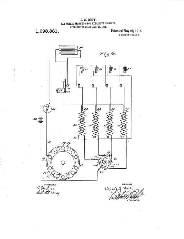

It wasn't until Huff gave Henry the ac generator in the form of the magneto that there was no need to worry about battery drain. The model T Ford ignition system was in play 1907/1908 and not patented until 1914.

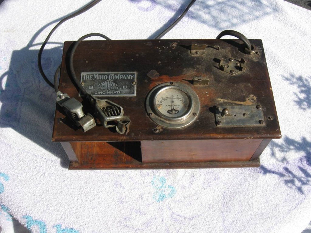

My two test units, for me, give a correct indication of current draw for coil setting and adjustment, either AC or DC. The AC unit has a step down transformer of 8, 16, 24 volts AC at 10 amps (top left). The DC unit relays on a 6/8 volt battery for voltage and current.
The Sperry meter is for testing the capacitor. And the analogue gauge (upper right) for compression.
