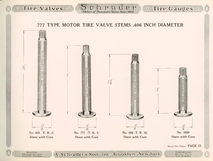

Re: Blockley Tubes
There isn't any real reason to send an original valve, but it's a nice thought...
No need to reinvent or reverse engineer the correct stem. Everything about it is standard and known in industry: the correct 777 stem is 3" tall and has 10V2 threads on it's body, with standard 8V1 threads at the end (as do all valves even to this day)
They're not a particularly difficult turning project but for what anyone would pay for them, I never offered any for sale. Made with CNC equipment (which I do not have), they'd be a snap to make.

This info is on the Blockley website, under tech, seems they use a metal stem that is 12mm in dia. with O.D. thread of 26tpi.? The product page on the 3 1/2" and the 3" tubes only state nickel plated metal stems, but don't give a size.
For the T originally used the 777 that is 3" tall, and these were O.D. .406" or 10.3mm. Without measuring a Blockley, unless someone has, it appears they use a modern-like metal 12mm stem on their clincher tubes? Don't know for sure.
Other sizes are larger O.D. for the bigger tires over 3" wide
