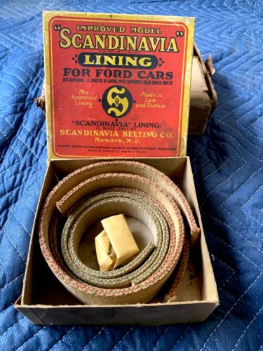

Hello all,
Are these older bands the "good" desirable Scandinavian bands?
Thanks,
Mike
Thanks,
Mike

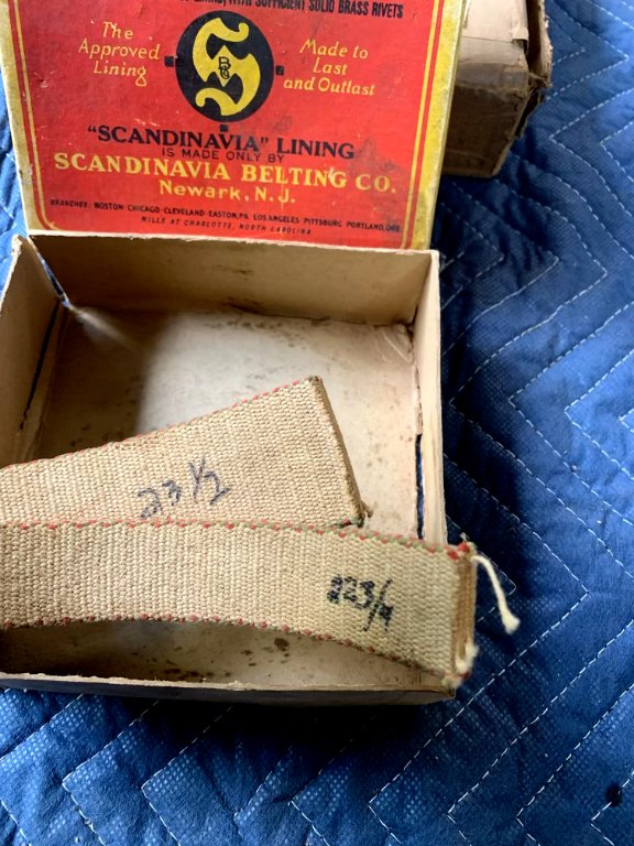

They are not scandia. Scandia have a distinctive brown color.
They are repackaged. Look like wards Or another Plain cotton lining.
Not to say they wouldnt be a fine runner. Looks like a tight weave.

To me, they look like Scandinavian bands from the 1950s or iso. I remember the sewn edges. The early ones, as I remember were that color. Brown ones are later. These would be good to use.

The lighter colored bands are either Sears Allstate or maybe Montgomery Wards. I have some Sears Allstate that look just like them.
The older T bands by some of the makers are woven in just as tight a weave like the older Scandinavians are.
Sears and Wards and a few others are are about as good or as good as the Scandies. Mark also made some good bands.
It’s the tight weave that makes the bands durable.
It could be that other older brands that were the tight weave were made by the same company that made Scandies. But that’s a guess of course and it seems that the weaving machines were sold years ago.
Of course cotton won’t last as long as Kevlar that’s avaliable now. But how you drive makes a difference too.

First off, they are called Scandinavia not Scandinavian. Second, those in the picture are not Scandinavia linings. Third, those look like they might be very good tight weave cotton linings that should work fine, perhaps as good as Scandinavia linings. I would use those before I would use kevlar.

Jeff, perhaps you didn't read early replies to this post ? Darel Leopold, who has been an avid "Model T-er" longer than many of us have been alive (since 1946) stated the pictured linings look like Scandinavia linings c. 1950s used to, before the brown ones that came later.
Just in the interest of satisfying curiosity, what are your reasons for saying they are not Scandinavia ? They do indeed look like good material, any road.

The ones in the initial early post don’t look like the earlier lighter colored bands. If you look closely at them the early Scandinavia bands didn’t have the red thread on the edges like these do. Allstate bands had the red edging thread. The early Scandies were lighter in color but not as light as the Allstate and a few others.
As long as the cotton bands have a good tight weave they are pretty good.
The later Scandies were darker and the weave wasn’t as tight. https://www.mtfca.com/discus/messages/7 ... 1489334927

Thanks for that, John ! It appears the earlier buff colored Scandinavia linings also carried the name, stenciled in yellow like the later, darker ones did.
