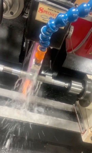

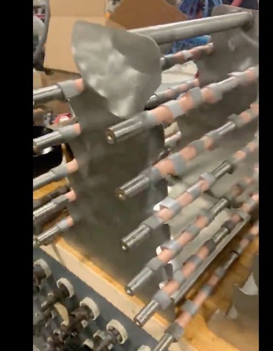

Lot of speculation. Would behoove someone wanting a Stipe Cam to give them a phone call.
This Feb. Bill Stipe posted videos on his Facebook page of running cams, maybe a back log, or maybe not. Phone call would tell.
Pics from Facebook post in Feb 2023

Do you have an address?frontyboy wrote: ↑Sun Apr 30, 2023 11:54 pmCam Grinders in Tacoma Washington can and will grind model t cams. Their average turnaround time is 3 weeks. Reasonably price and very high quality work. They can build up worn lobes regrind to spec.
They have been in business for many years and know their business. I have had them grind stock, racing and odball cams all with excellent results. From my model t's to my hi performance Ferrari cams they can do it all.
just sayin'

When did you start grinding the cam bearing journals on your regrinds? I have 2 regrinds I purchased from your dad. ( one in a engine & one
in resurve) maybe 5-6 years ago. I also have one I purchased last year that has bearings that fit very good on the internet. I would
like to know when you started doing this. I don't remember that I needed to buy special bearings when I purchased the first 2 ?
Craig.

This is the first batch. In the past, you would have to custom fit bearings on our regrind cam. Now the front and center journals will be ground to .740. We now have an exclusive source for new bearings that will be honed to .740 (.008 under) on the front and center bearings only. You will still be required to fit the rear bushing. We have 30 ready soon with 30 more also in the works. Grind will be the driver performance .270.

UPDATE as promised. We now have a quantity (30) of our performance (Driver 270) regrind camshaft in stock. Retail price is $259.95. We also now have new camshaft bearings custom made to fit. No more having to fiddle with fitting the bearings. Give Dave a call at the garage if interested.

Thank you Scott. Always appreciate your input on the forum. I run this camshaft grind in all my cars and love it. Hard to beat Henry steel and the price is the icing on top.
We have another 30 camshafts in the works. Hopefully, we can keep up the supply.

Ye sir. 30 more have been received from the cam grinder and are on the way to have the journals ground.
