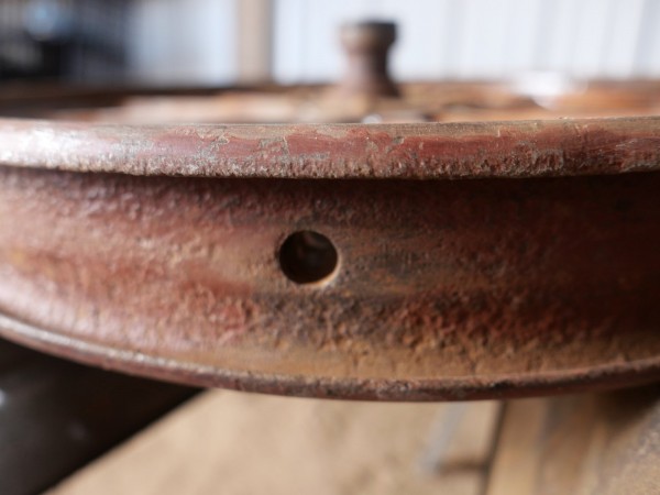

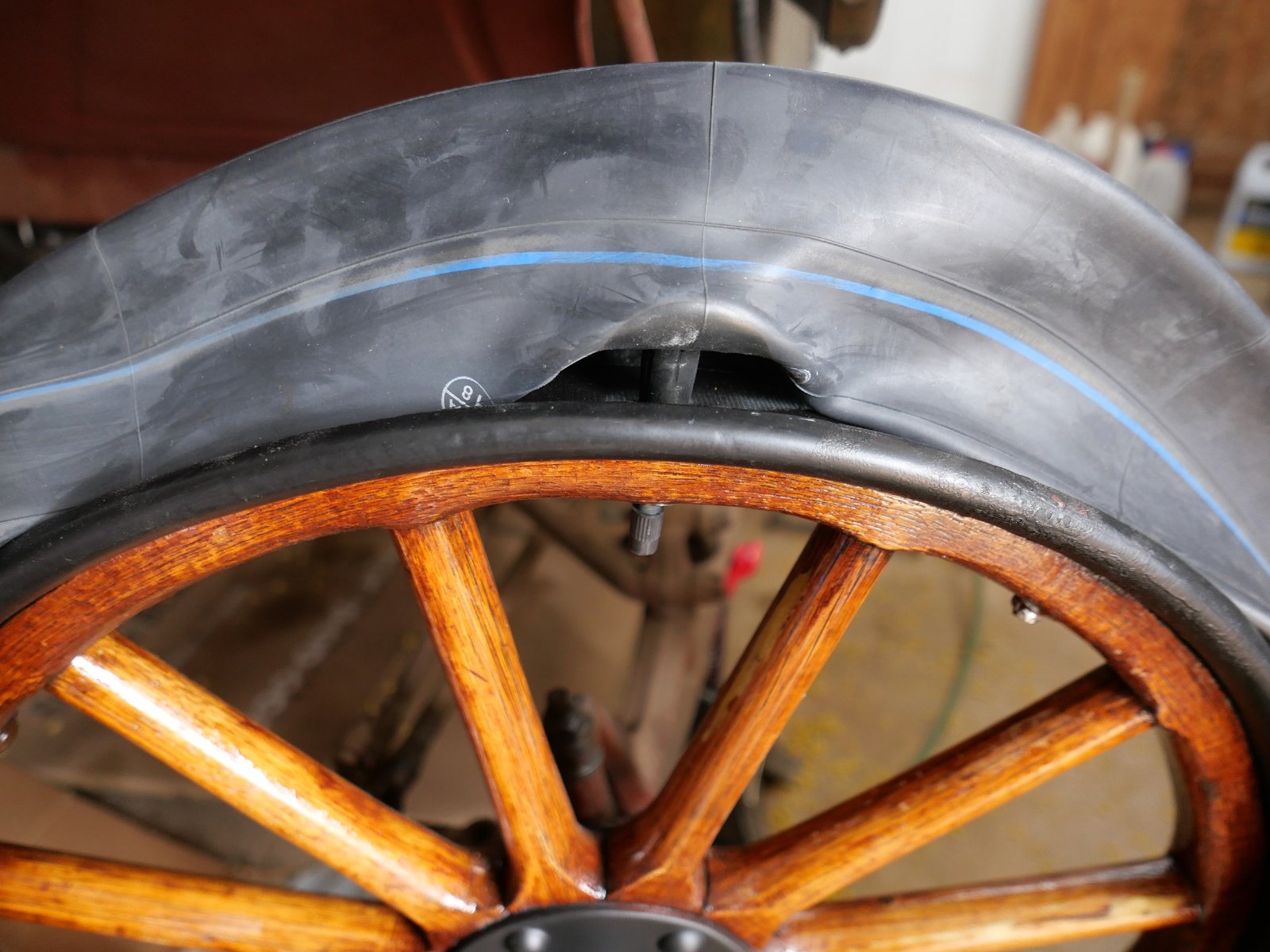

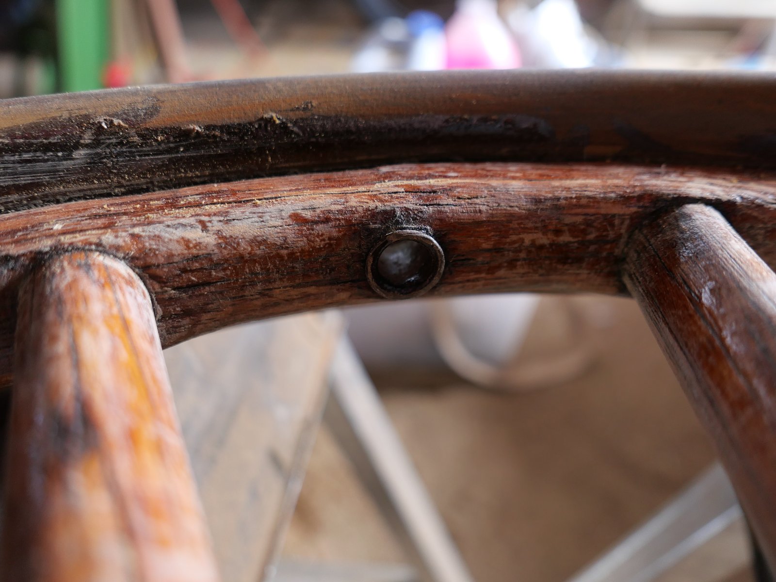

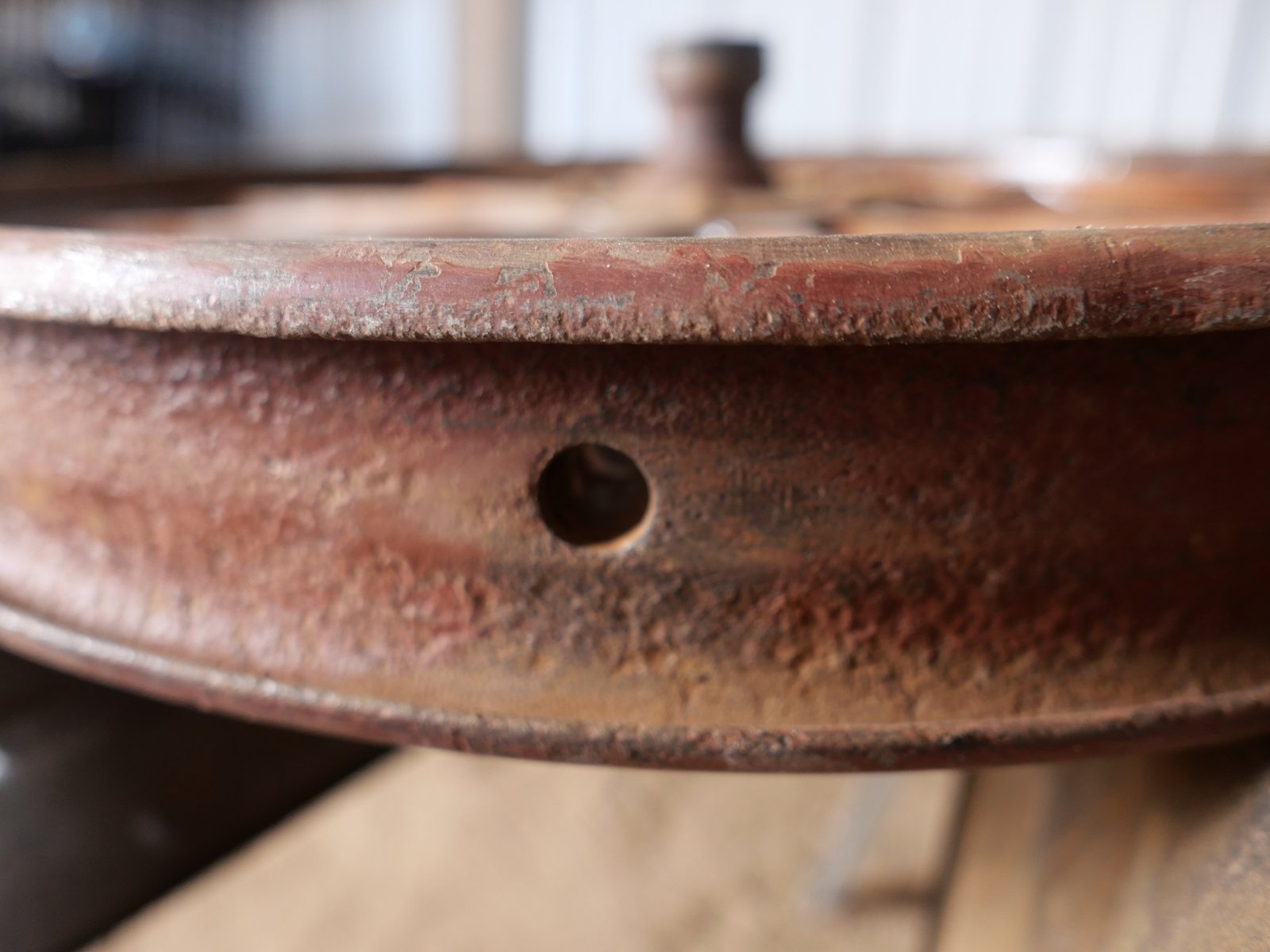

My new inner tubes have a valve stem that is larger than the hole in the rim?
Should I drill it larger or just use them as is.
I thing that the old tubes had the same problem but were installed that way.

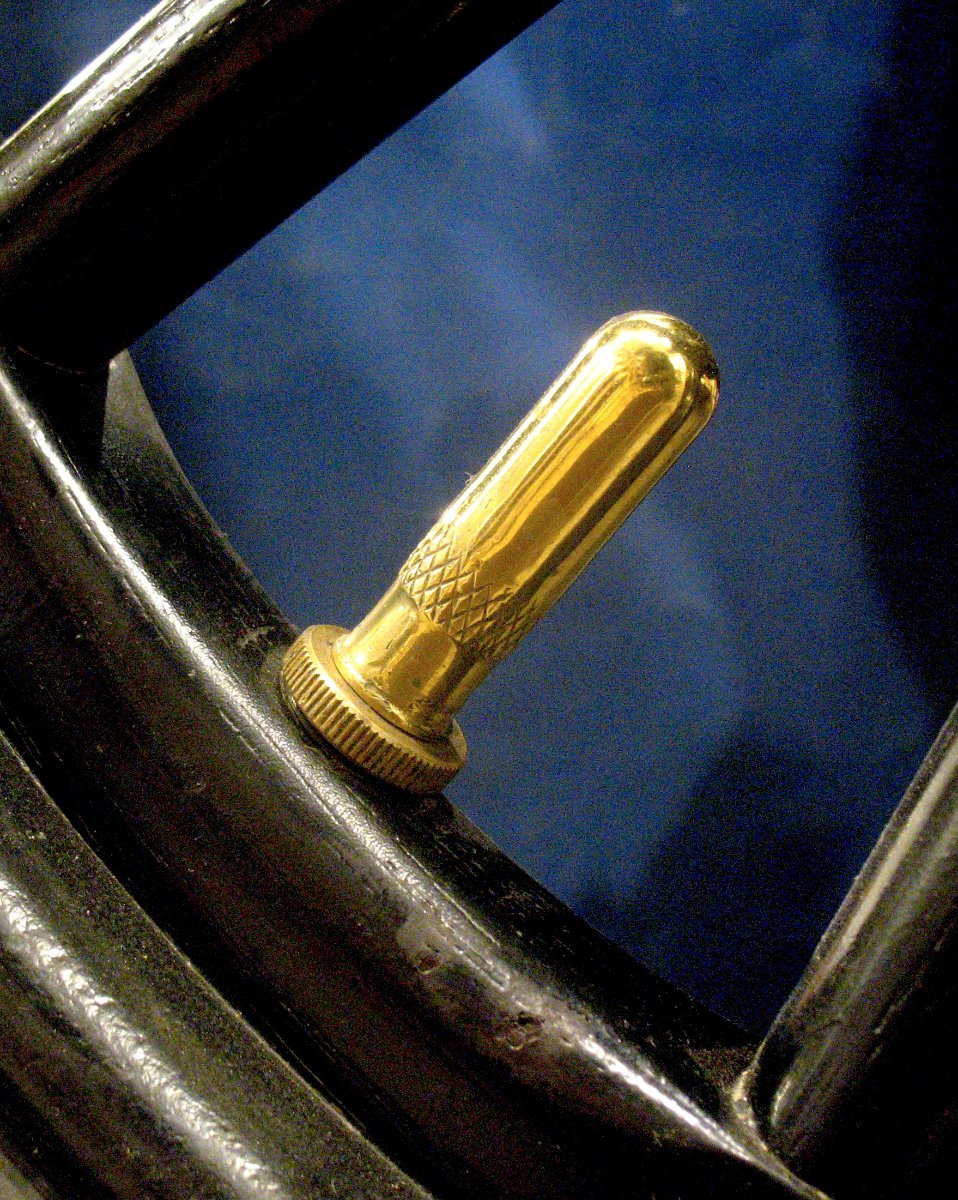

The valve stem that Steve used in his illustrations is incorrect. It works of course, but it's not what Ford used. I posted a photo of the correct rim nut on the forum last week. There is no sense in using the incorrect valve stem, when there are plenty of originals around. The late rim nuts are easy to find, but the early ones are difficult to find. The correct valve stem for a T is a Schrader 777, or 888. Of course, they use a different bridge washer too.

I've done the whittle the rubber thing, I've done the forcefit thing, I even tried an oversized motorcycle tube - in EVERY case, the rubber stem failed, bubbling around the felloe hole and then popping, usually somewhere where changing that tube wasn't very fun at all!
I think part of the problem is they're just not made to hold 60-70 PSI... although semi tubes (which are getting rare) seemed to handle 110 PSI fine. So it takes me to the other part of the problem - they're not very well made, and whoever is making these things are slapping them out in small batches as cheap as possible...
I eventually decided that it was worth the hassle to go with the correct(ish) metal stems, and other than a slow leak on one (probably from my pinching the tube, darnit!) haven't had a problem.

Larry is correct. I'm using the Schrader 824 and 825 stems. Why? Because that's what the covers I'm using are made to fit. The covers were given to me as a freebee, so would I use the oversize stems just to fit them? Damn right. And why are the new covers made to fit the 824 and 825 stems? Because that's the size used on the new metal stem tubes. And why is that size used on the tubes? You got me there. I have no clue.

The photo that Steve posted above looks correct to me, but is impossible to tell if it has the correct rim nut without removing the dust cover. Great photo Steve of an early correct looking dust cover and rim nut.

The cover looks original, but it's one of Mike Lebsak's reproductions. It screws directly onto the oversize stem. The only rim nut is the round knurled one shown in the photo.
