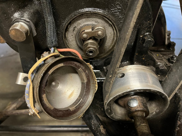

Tried to start my 1927 Touring after rebuilding everything, engine by Joe Bell, coils by The coil Doctor everything else by me, I turned the key to battery and the coils started buzzing, turned the gas on and hit the starter, it tried to start a couple of time but then the coils stopped buzzing and I thought I smelled a faint burning. Quickly disconnected the battery and felt the battery, cable, starter, coils, wiring and generator and everything was cold, this all happened in the span of less than a minute, I can find no evidence of something getting hot, maybe that part was just in my head.

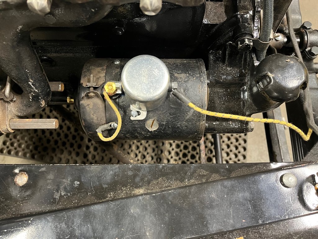

I do not have the headlights or taillight wires hooked up, I grounded the generator, I think I read you should do that if it bad and I don't know if it's bad. Now with the key on battery I have 6.24V at the coil box but the coils don't buzz
What have I done wrong?

Disconnect & tape off the cut out wire, in case you have a cut out issue for further testing.
Is your timer roller secure. Does it turn when you crank the engine.
You can manually ground each terminal from the timer on the coil box. You should get buzz on each. That would pin point a timer issue without removing the timer. Did you do the "pack it full" thing in the timer?

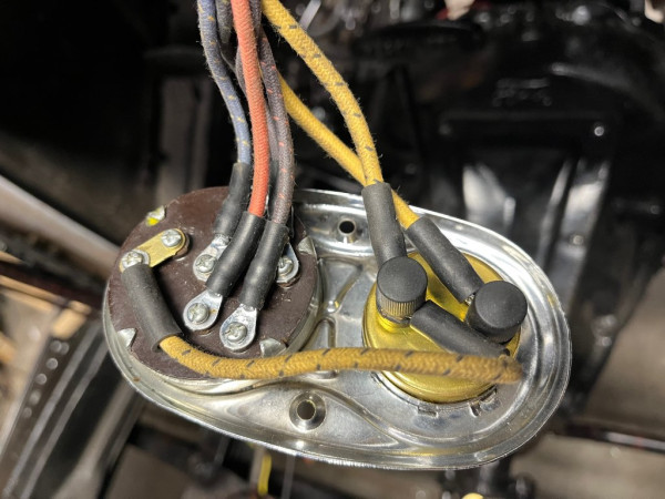

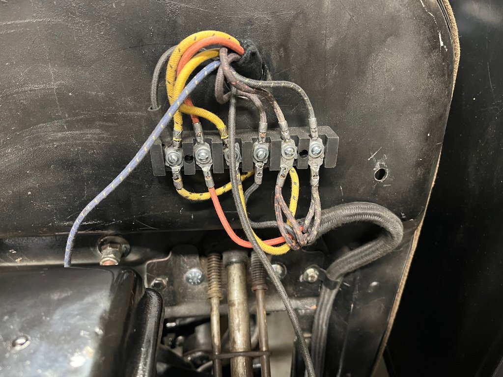

Is your ammeter wiring correct? I dont recall 2 wires on any terminal.
- Posts: 8639
Re: Newly rebuilt 1927 Touring, coils quit buzzing after trying to start
The timer provides a common electrical ground for each coil in turn as the camshaft rotates. If there is a problem with it, it could prevent any of the coils from buzzing, even with good battery voltage at the coil box. Cranking the engine by hand with the fuel shut off and timing retarded should allow you to hear each coil to buzz as the engine is cranked through 2 complete revolutions with the key on BAT.

Slow down and go through all of your wiring connections again. I don't recognize the ground connection from your cutout to the generator case. That ground wire is usually there just during the shipping of a rebuilt generator and is removed once the cutout is installed.

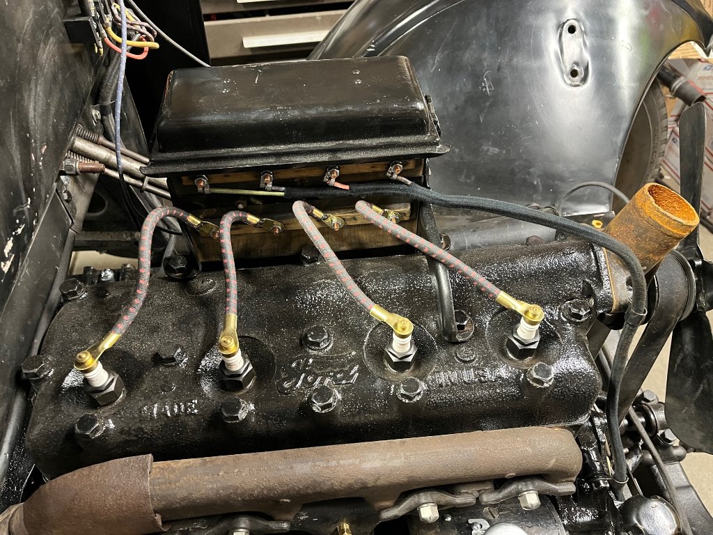

Well damn, when I got this car it had a distributor and I added the coils back in so this is my first experience with coils, from watching all the videos of how to start a Model T I believed the coils always buzzed and the timer just connected the coil to the spark plug at the correct time.
Sure enough cranking the engine over by hand I can here each coil going in turn, another duh moment for me.

You have the yellow-black wire from terminal #1 connected at J instead of K, but that should make no practical difference. Here's the correct wiring in case you want to check everything.

The wires from the coil box have to be attached to the timer in the proper order. If they're out of order, you can get a broken arm or a busted starter when trying to start the engine. Always pull the hand lever all the way back to set the parking brakes. Otherwise, the car may run over you when you are cranking the engine.

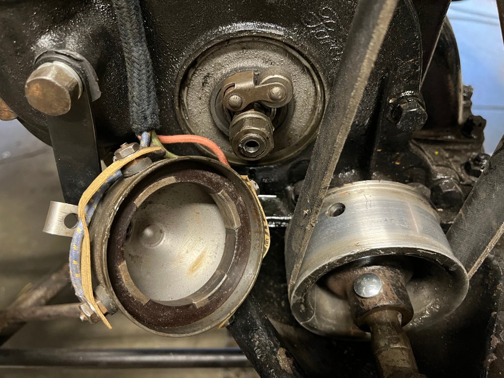

I timed the roller style timer with the timer gauge and found this to be way off, the No 1.coil would buzz when the No 1. piston was 1/4 to 1/2 down from TDC.

I rebuilt the carb, drilled out the plugs and cleaned the passages this time, check all the plugs, new Champion X, for spark and one seemed to be hit or miss so I replaced it, bought a new Anderson timer, originally tried with a used roller timer, bought the Anderson because I have never run a Model T with coils and wanted to make sure the old timer wasn't the problem.
When I first tried to start the car two weeks ago I set the roller timer with the gauge and found that to be way off, after installing the Anderson timer I timed it with the instruction below and then tweaked it to fire when the number one cylinder was about 1/16" down from TDC, the spark lever arm was a little loose on the spark rod so I drove out he little pin, but some Loctite 660 one the spark rod reinstalled the spark lever arm, tapped the hole the pin would normally go into, to a 4-40 thread and installed a 1/2" long 4-40 set screw, that locked it solid on the shaft, emptied the gas tank and put in fresh gas.
Turned the carb knob 1-1/4 turns and cranked the engine about 3 revolutions with choke on, key off, then turned choke off, key on and it started right up, don't know for sure what one of the things I did was the key to get it started I suspect getting the timer timed right but she runs now.
