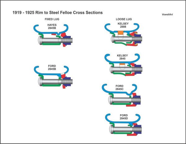

Best to post pictures of your wheels so they can be identified. Pictures of your wheels & rims will also help friend in matching one too.
As far as clincher rims there are some incompatible combinations. These are good links to read if interested
https://www.mtfca.com/discus/messages/80257/92314.html
https://www.mtfca.com/discus/messages/80257/115355.html
https://www.mtfca.com/discus/messages/29/39258.html --
