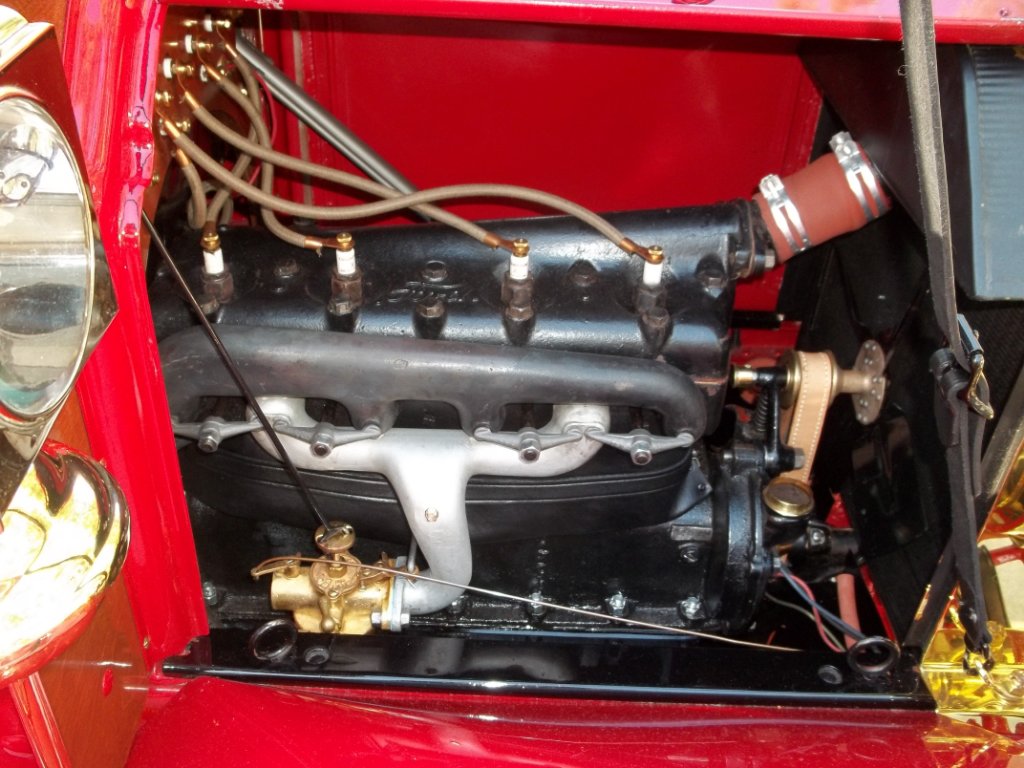

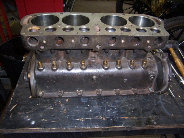

Help a newbie!…..Pray tell….what is an open valve engine….
- Posts: 6710
Re: Open Valve Gallery Engine
- Posts: 6710
and for the very discerning motorist (Russ!) some pictures of rare accessory covers (photos courtesy Mitch Owen):
