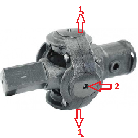

Here is a picture of a u-joint. Perhaps you can reference the numbers when describing your observations

In the above picture, arrows marked number one, is it ok for up and down movement? I have a total of about 1/8 inch.

Yes that would be normal. The spider is not locked in the housing so there is some movement. Would be more concerned about movement of part 2, shown in the photo, in the hole it rides in. While some wear is ok, too much is not good.

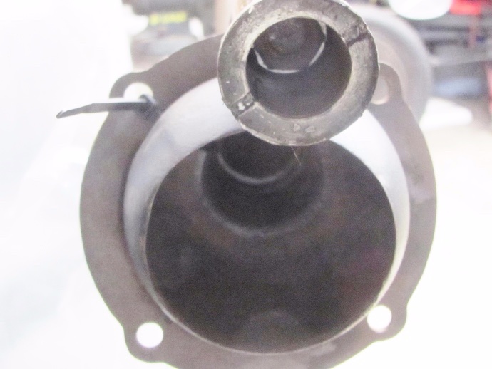

Some folks thread a pipe tap into the old babbitt bushing, then install a pipe plug. A long steel rod is then used to drive out the bushing. Just be SURE, that the long rod is of adequately small diameter to pass by the internal heads of the rivets that attach the ball end to the torque tube. Some have not done so and have sheared off those heads. Myself, I just ram an old wooden broomstick down the tube. The rivet heads will carve away the wood with no trouble and the bushing is driven out. Yup, that's really crude, but it seems to work for me.

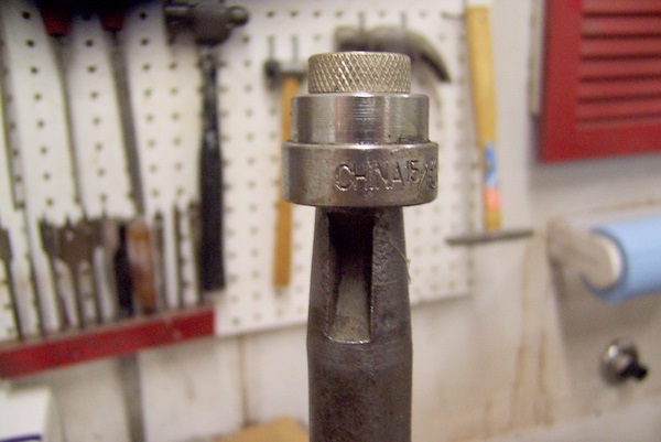

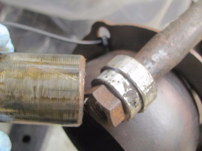

Have used just a simple bushing driver, from a set of Harbor Freight hand drivers, the threaded cap happens to fit on the end of a used steering shaft or use any nut that fits, the driver can be 15/16" id. or 1" id x 1 1/8" od. Just select the right size driver to be sure the rivet heads inside the torque tube aren't disturbed. Some have used 1/2" drive 15/16" sockets there, and the od on some of those can cause harm. So don't use any driver or pipe or whatever over 1 1/8" max. Smaller is better.
Use a 5lb. mallet and drive that old Babbitt bushing out, most times after one strike of the mallet the smaller 15/16" id driver is now wedged in the old Babbitt, so then turn the torque tube upright, with the steering shaft sticking out the base and slam it on the floor, that uses the weight of the torque tube like a slide hammer, and out comes the old stuck bushing.
Works everytime.
Works everytime.
