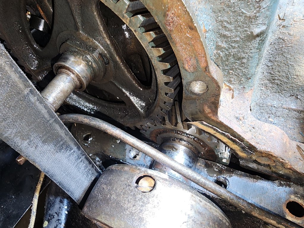

It could be that your cam shaft has shifted forward. How do the timing gears line up? If the cam gear is ahead of the crankshaft gear that could be the reason. The cam bearings have a thrust surface and if it is worn out could cause the camshaft to move forward. Also check the nut which holds things together in front to see if it might have shifted allowing the gear or the rotor to move forward.

Norm that is a great suggestion. I will take a look at the gears. Is that a difficult issue to resolve if that is the case.?

If the gear on the camshaft has shifted forward but the nut is tight, your calm bearings might need to be replaced. You would need to remove all the valve springs and put something like a clothes pin on each of the lifters to keep them all the way up against the valve guides. Then with the cover off the front of the engine. There are two set screws on the side of the engine above the valve cover. those would be removed and then the cam shaft pulled out. Then you would need to purchase some new cam bearings from one of the suppliers and replace on the camshaft. Then put everything back. If any of the valve guides should fall into the crankcase while the cam shaft is out, you would then need to pull the engine to fix. You might be lucky if you remove the inspection plate under the engine to find the keeper and put it back in with a clothes pin. If not you would need to pull the engine.

Removed the timer cover. They seem ok and in line to me. Also i could not detect any fore or aft movement at all in the camshaft

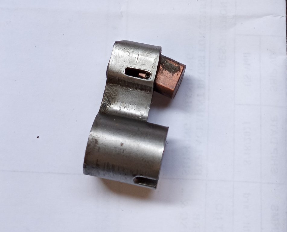

One thing I didn't see anyone mention is the type of New Day ur running, cause you may just happen, altho rare anymore, to have the model with the infamous "S" on the cover. Those were made for a short time a while back and were junk. As are a lot of the repop brushes like I show here. I had one of these on my Fordor and I had to take it off and clean and "machine" it every 250 miles or so til I got tired of it and luckily located one of the remaining TW timers that were in existence and put it on and no more trouble. I have the TW on 2 cars, the 3rd has T.Fire which I may eventually go back to stock with the TW timer also. I swear BY the TW timer! I swore AT that New Day!

I've been using original New Days for over 50 years. They are the best. I understand the most recent ones made by Tom Carnegie are very good, but don't need to try one, as I have a good supply of originals. The brushes on the new ones as pictured are a bit wider than the originals.
