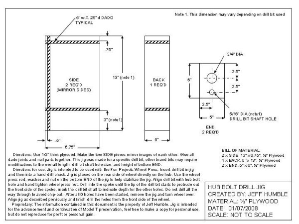

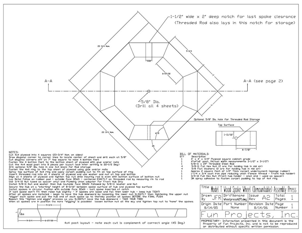

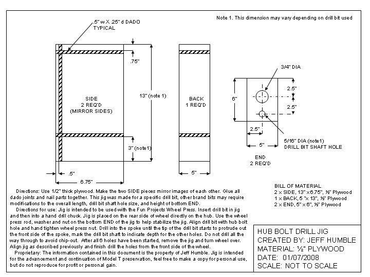

Here is the drawing in a .pdf file, as well as a drawing of a hub bolt hole drilling jig:
- Attachments
- WheelpressA2.pdf
- (105.02 KiB) Downloaded 79 times
