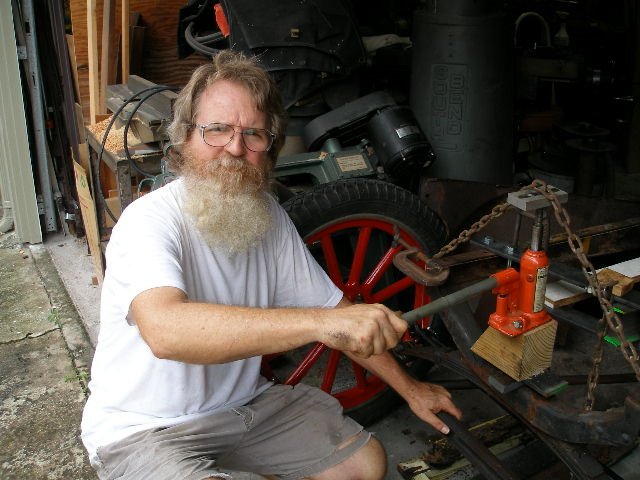

What might be necessary is to bring the frame back to factory spec width as frames will splay open and cause damage. It only takes 100 years or so to do the damage, so fixing the source should last another 100 years or so.
A correct fix for a radiator which will not fit correctly is to wrap a chain around the frame and jack the frame back to the correct location. It can be done with no damage to an original car and with little paint damage on a finished car.
Personally, I would say that opening the holes on the radiator support bar is fixing a symptom and not particularly good advice (or perhaps it would be kinder to say it's not the best advice...). I for one would not want the thimbles to be loose and working around.
