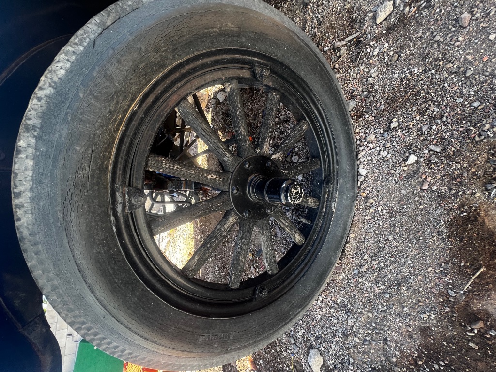

I believe they are 30x31/2 and yes they do need to be replaced. I will take a closer look. Here is a picture of them.

Insa! I bet it's at least thirty years old.
If this was a car, and likely to get driven a lot, I'd suggest new Blockleys. But a TT probably won't cover so many miles, and Riversides should be good enough.

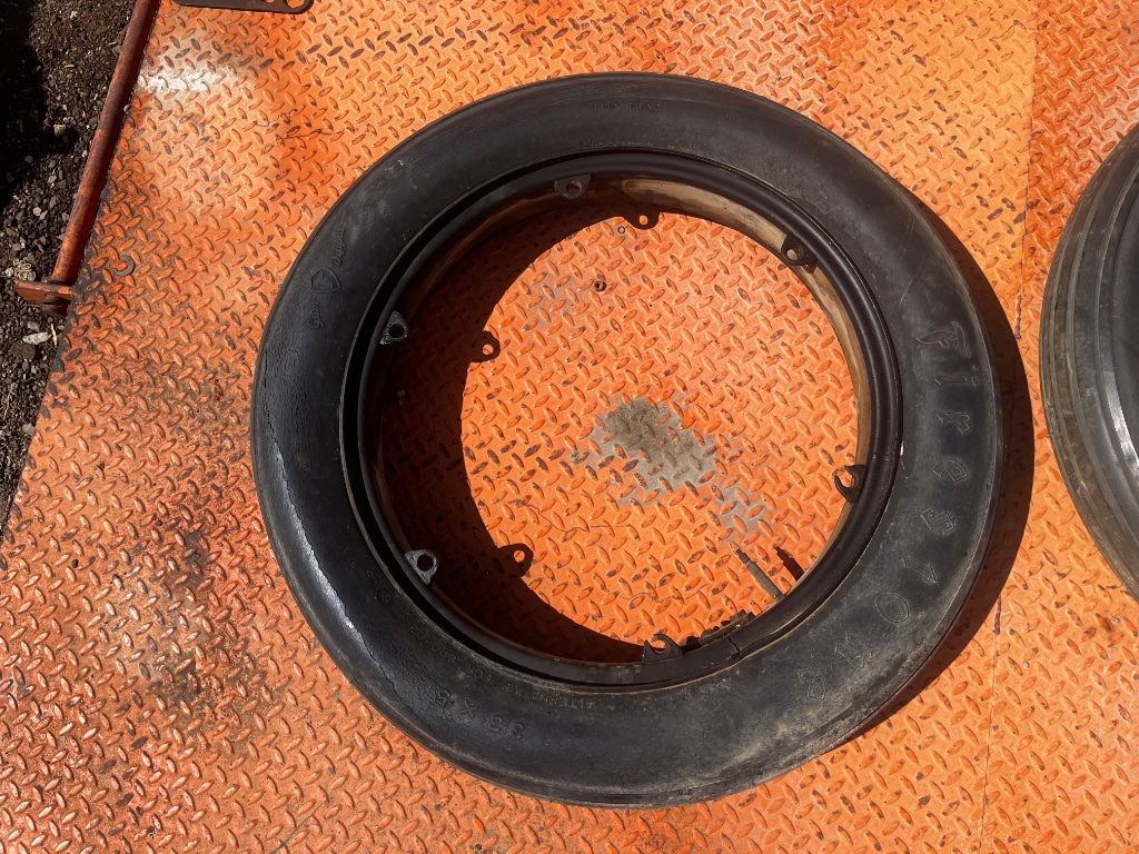

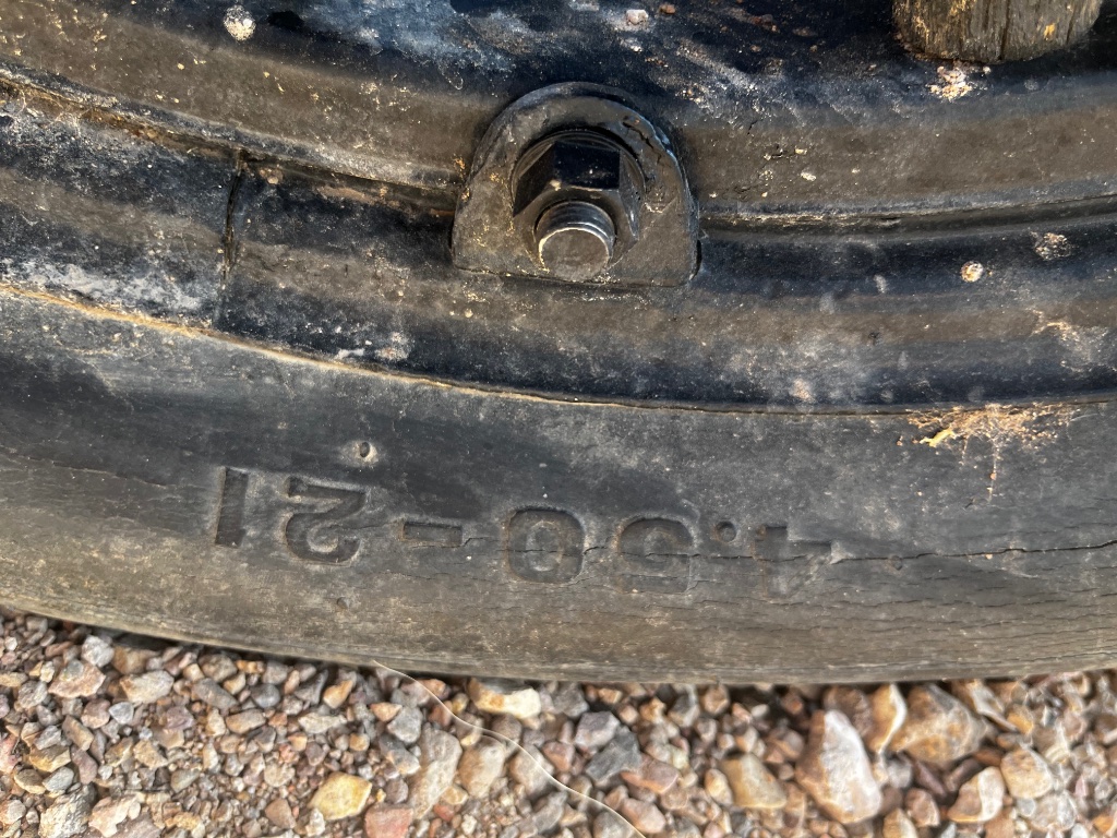

Jacob, if that is a front wheel photo, it is not a 30 x 3.5" clincher. To my knowledge, there never was a beaded edge Insa tyre. They were 21" straight sided tyres like those in your photo. They did give really good service, and those who still have them are blessed. Someone bought them out and they dissappeared, leaving us with the present crop of junk, Blockley's excliuded.

Well that’s a shame. I just realized that too. What sizes will fit on the rim because the tires are shot.

Your split rims will take 440/450 x 21 or 450 x 21 tires. Coker and Lucas are reputable outfits, even if their tires are second best. I believe Universal is still owned by Coker. Blockleys are best quality. Two of them with shipping to me Kansas came to $526. You can do the homework on costs of other tires shipped to Henderson.
Tubes: Again, Blockleys are best. But I've found Hartfords to be OK, and they cost a LOT less. I avoid Custom Classic.
