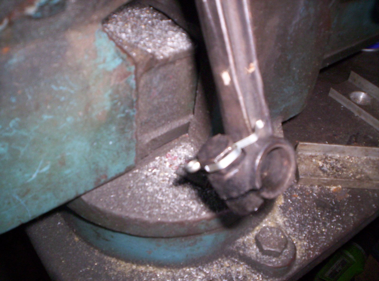

Ford fitted the cotter so the head would hit the rod if the bolt should try to back out.
my choice is to reverse fit and one side of the cotter rapped and crimped around the bolt head and the other side crimped into the channel of the con rod, (others choice of fitting may vary)

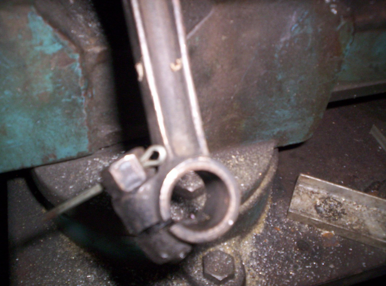

When you tighten that screw. DO NOT clamp the rod in the Vice. Use a Pin who fits in the Piston Pin.
Like this:
At my actual project i do the same.
Like this:
