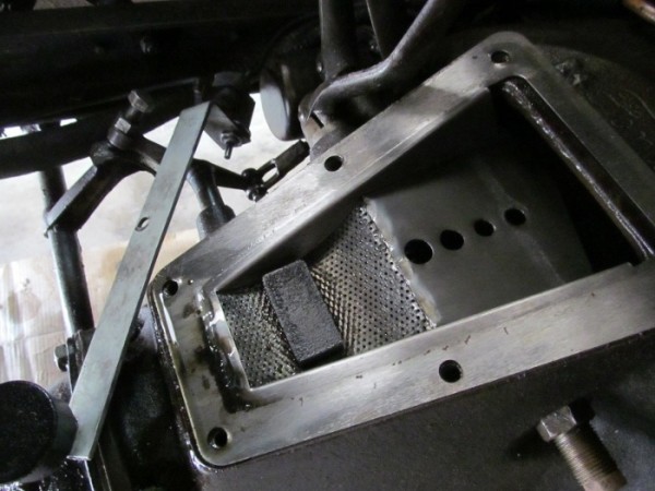

Many use the vendor supplied oil screen accessory that is sandwiched under the inspection cover. Collects stuff you can clean out each oil change. These screens typically come with a magnet too. Recent info gives some precautions to wire or secure that magnet so it can't get into the trans.
Or there is vendor supplied magnet oil plug for the crankcase too. Likely good idea for magnet esp. on a new engine with metal wear from rings setting and stuff. The oil screen is a nice thing to add.
Oil screen accessory and magnet.

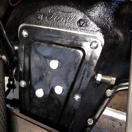

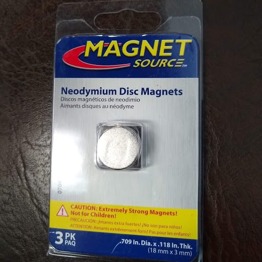

Re: Magnet for metal residue capture
The first picture is a set of magnets I purchased at Home Depot. $3.98
The second picture shows how that are placed on the transmission cover.
In a few months I will take them off to see if they work as well as the magnet
already stuck to the filter. If these work, I will remove the magnet inside so I
do not have to worry about it getting pulled into the transmission. These three
magnets were very strong, and I had to pry them apart.
thanks again to bob for the suggestion.
