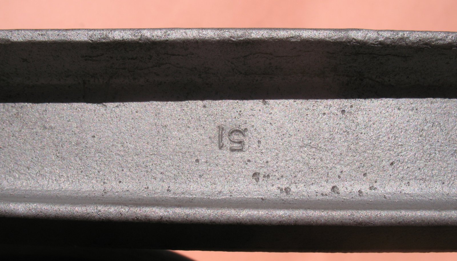

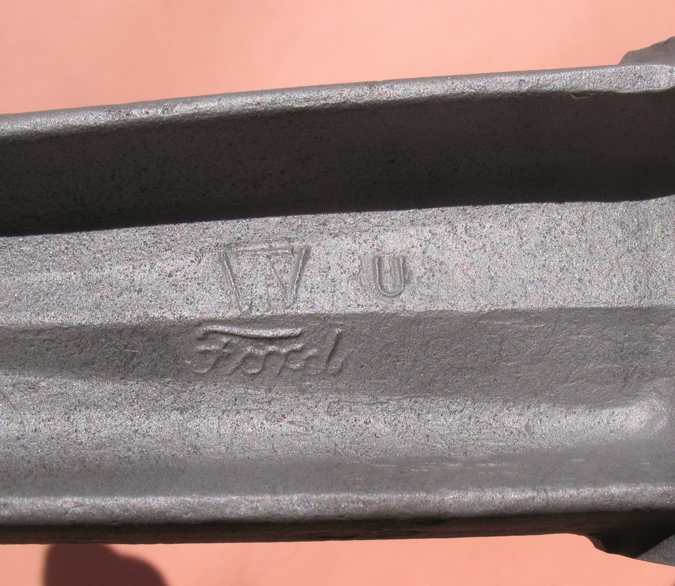

Topic author - Posts: 7394
Re: Front axle ID?
Boy, was I wrong! I should have blasted the thing BEFORE asking.
Getting it naked revealed the Transue Williams mark, the letter U, and the Ford logo. I gather this would be in the twenties after they started putting the Ford mark on just about everything.
There's also an upside-down 51 near the center.
